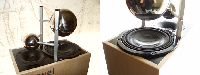

Υπαρχει ενα ζευγαρι ηχειων που ακουσα στην εκθεση τα οποια εχουν τα μεγαφωνα να "κοιτουν" προς τα πανω, με 2 "σφαιρες" να αναλαμβανουν την διασπορα 360 μοιρων στο χωρο. Το αποτελεσμα ειναι ενα καλο ηχειο, οχι ισως το καλυτερο στην κατηγορια τιμης του, αλλα με ενα προτερημα που το καθιστα μοναδικο. Η στερεοφωνικη εικονα δεν στεκεται σαν εννοια για να περιγραψει την αισθηση οτι περπατας μεσα στη μουσικη σκηνη. Σχεδον οπου και να κατσεις στο χωρο ακους απιστευτα.
Duevel Planets
http://www.6moons.com/audioreviews/duevel4/planets_2.html

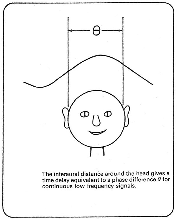

For most people the terms hi-fi and stereo are synonymous, and yet it is clear that there is still a great deal of confusion over what the word "stereo" actually means. There isn't even a consensus of opinion amongst producers of records, designers of hi-fi equipment, audio critics and music lovers as to the purpose of stereo, and considering that the arguments show no sign of diminishing in intensity, it is instructive to realise that 1981 sees both the 100th anniversary of Clement Ader's first stereo experiments and the 50th anniversary of Alan Blumlein's classic patent on stereo.
Ader placed telephone microphones in two groups, left and right, on the stage of the Paris Opera and subscribers listened on headphones to the twin signal which was transmitted over telephone lines. Blumlein's work was still experimental, but more theoretical in that it examined exactly what directional information needs to be preserved on a two-channel system in order that an accurate aural picture can be recreated using two loudspeakers.
