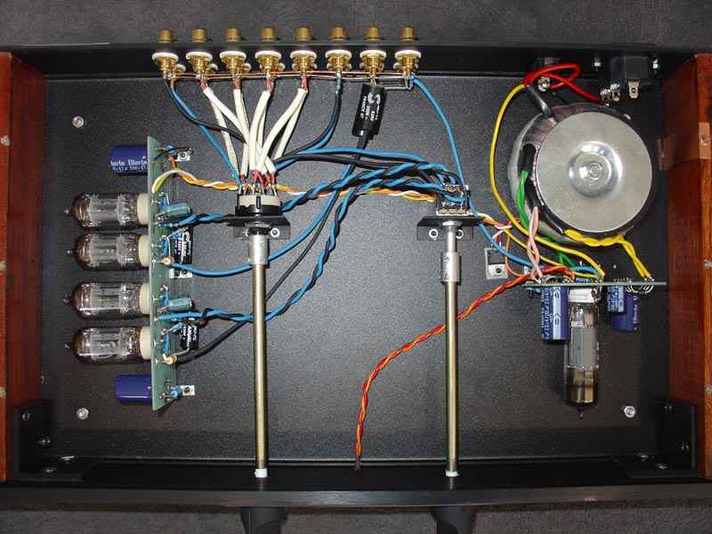

KVP 20 is Korato's basic tube preamplifier. It has five line inputs and is a one box unit. Inside KVP 20 has four valves (two ECC81 and two ECC82) in the audio section and one (ECL 82) valve in the power supply.
Internal wiring is VdH CS-18/C5 cable, has a Alps pot, all of the connectors are gold plated with teflon insulation and signal capacitors are Solen polypropylene. We use Spectra Dynamics anti resonant feet to block any unwanted acoustic feedback. KVP 20's design has no global feedback, a feature shared with our other preamplifiers. Remote control for volume is optional.

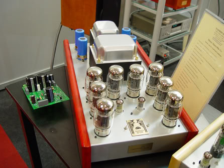

Ο νέος Alexander μαζί με τα μονομπλόκ artemis
Οι τελικοί Electra με EL34 2200Ε, με 6550 2720Ε
