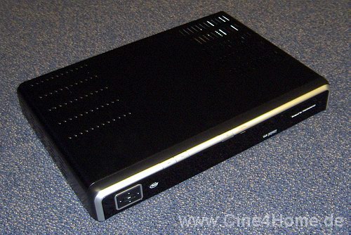

To unpacking equipment arranged surprisingly well for satellite satelliten-Receiver shows up: The receiver is held complete in black, with silver set off edges, works however in the processing only moderately.
The corners are rounded off and lend to the equipment a modern designer character, which can be merged into most living rooms problem-free. Fans of silver components will only have reason to the complaint.
The front screen is completely black reflected with a dark-blue, eight-digit DOT matrix display in the center. Also this combination works very elegantly.
Apart from the program number the display holds the user also with important information to the selected channel up to date. So one can read off here e.g. whether the current radiant emittance is copy-protected or not. The key maps are right hidden behind a flap dezent.
Likewise at the front different keys (tax cross, EPG, exit and Standby) are, with which a control is made possible also without remote maintenance.

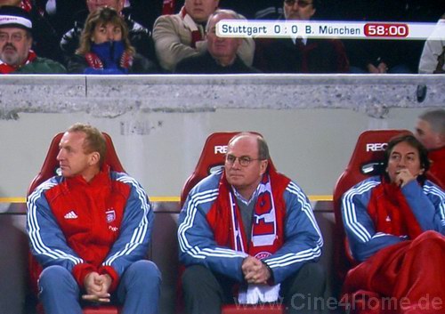

One of the large course horses of HDTV is the sport, not least also the Fussball-WM2006 in Germany. Straight one with sport transmissions becomes the advantage of HDTV particularly clearly: All details such as player numbers, spectator's stands etc. are now clearly recognizable, as if one would participate live.
Also the structure of the lawn is now clearly more plastic, compared with the too strongly compressed standard definition transmissions of the same transmitter is here the advantage of the hp version particularly clear. Only with Kameraschwenks (snapped ball passports) still clear Unschaerfen was to be registered with our test. But altogether the hp sport quality is on a good level.
Also close-ups show a perfectly new detail loyalty, it make simply much more fun to pursue the happening approximately around the sport. Sport fans should risk a here in any case sample view.
