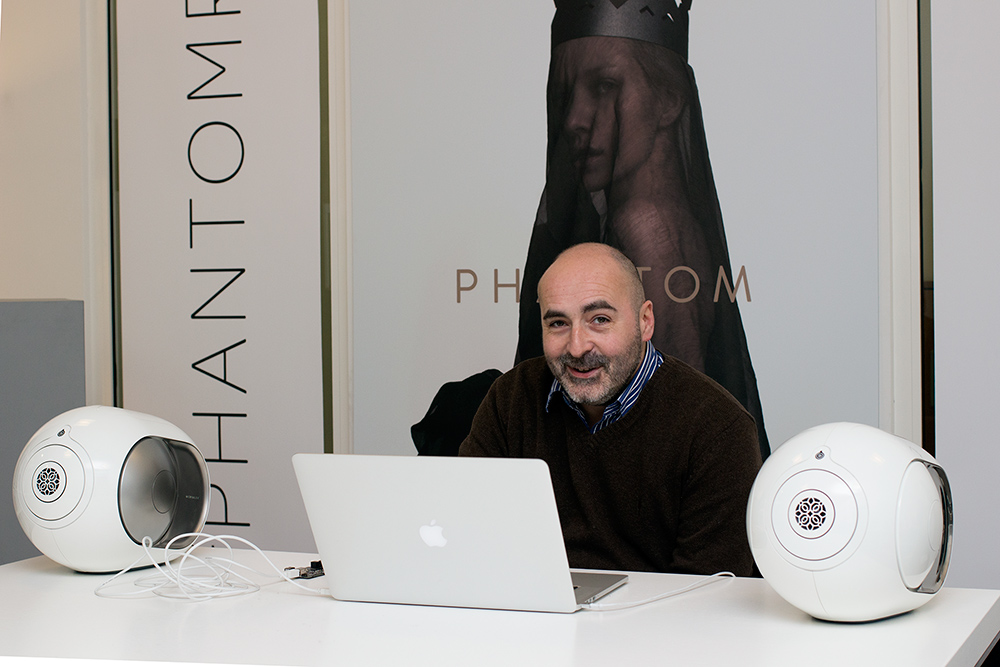

"My eyes were immediately drawn to the rounded shape, which is ideal for a smooth, unobtrusive wavelaunch. Then they found the 1" tweeter nestled into the 5" midrange driver, which puts both drive units into the same acoustic space, allowing for consistent output in all directions. And finally I saw the side-mounted woofers, which are about 6" across and are not only placed in ideal proximity to the front two drivers, but also work to cancel cabinet vibrations since they fire from opposing sides. The drivers' diaphragms are made from aluminum. I also took note that the woofers and midrange diaphragms are convex, not concave like traditional drivers, and that the entire outer shell was made of some sort of composite material, which I found out is a mix of ABS and fiberglass.
Also mounted on the aluminum centerpiece are the power-supply components, the class-D amplifier section, and the DSP electronics. It's the DSP component that acts as the brains of each loudspeaker, because it's where the crossover manipulation (250Hz for the woofers to the midrange, 2kHz for the midrange to the tweeter) and driver optimization are done with topflight precision. I was told that both Phantom models are flat to within +/-0.5dB across the audioband, and can reach right down to 20Hz with high output, which is simply not possible with a conventional loudspeaker of similar size.
