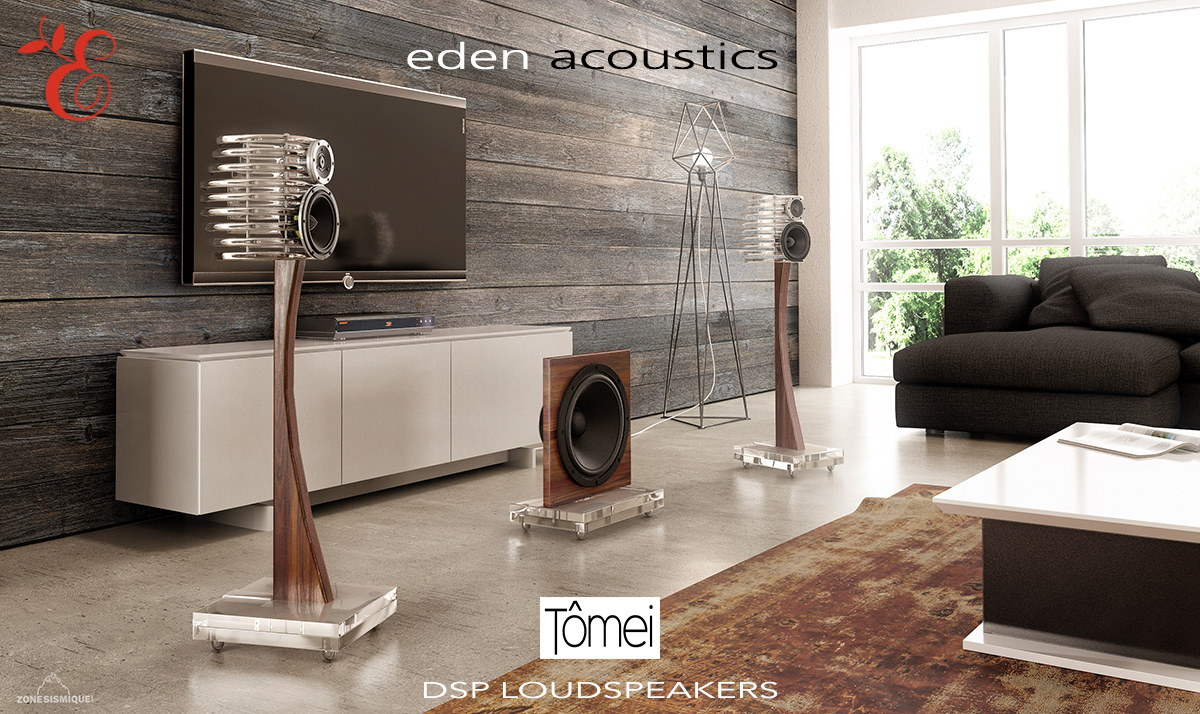

The Eden Acoustics TÖMEI speakers are a four-piece system consisting of a pair of most unusually styled open-baffle two-way monitors, an open-baffle subwoofer and an amplifier/DSP control unit with "new-gen class D amps and DACs for each driver (more than 2'000 watts of total power ) and a 40-bit/192kHz electronic crossover". Manufacture of the acrylic/Walnut system happens in Canada near Montreal.

"Suggested retail price is 16000$."
"Hello,
Here are some more info about the speakers :
AIR LOUDSPEAKER SYSTEM SPECS
AIR System frequency response is from 25 - 20,000 Hz -3dB.
AIR monitors
- 1 x 1” ring dome tweeter
- 1 x 5” mid driver
Bass Module
- 1 x 13” bass driver
Amplifiers (from Scandinavia)
- 1 x 490 watts/ch Class D amp. used SE (single ended) mode (each channel drives one mid driver)
- 1 x 490 watts/ch Class D amp used in BTL (output of 700 Watts drives the bass module)
- 1 x 50 watts/ch Class D amp used in SE mode (each channel drives one tweeter driver)
DSP units
- 1 x Accuton DSP 40bits/192Khz - 4 output channels 2 channels drive the mid drivers and 2 other channels drive the tweeter drivers
- 1 x Accuton DSP - 2 outputs - one output drives the bass module driver. Second channel will be used on future model with two bass units.
- Accuton DSP use one separate Master clock for audio, and one low jitter clock for digital.
- D/A and A/D converters : AK4413 and AKM5388 (one for each channel (Total = 6 for both DSP)
Loudspeaker cables:
We use bi-wire cables with Neutrik Speakon connectors at both ends. Cables come from a high-end cable manufacturer in UK.
The AIR monitors and bass module are built from CNC machined acrylic parts and american walnut solid wood. They use our special aluminum damped spikes.
The amplifier/DSP cabinet is built from american walnut solid wood and stainless steel panels. Input wiring is pure silver. The module accepts analog RCA or XLR inputs as well as SP/DIF RCA or AES digital input. Bass module levels can be adjusted in 0.5 dB increments to better match the room they are installed in. Through the front button one can also select presets to match their room.
Dimensions :
AIR monitors : 10 x 12 x 39” high - 30 lbs, each.
AIR Bass module : 16 x 12 x 18” high - 30 lbs.
Every system is shipped in two sturdy crates."
