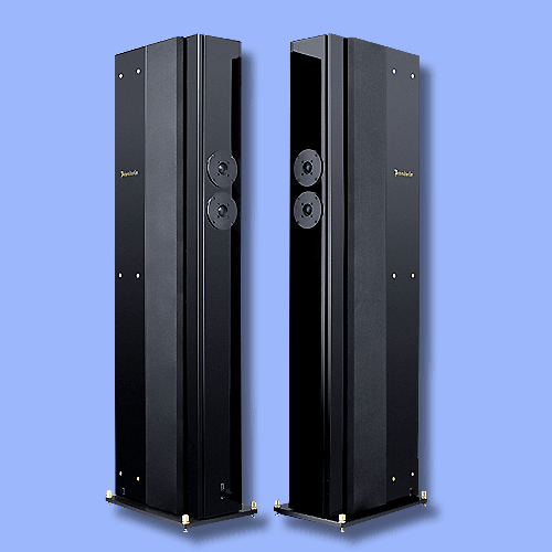

τα τρία μοντέλα τελικά είναι το
α) series7
με χαρακτηριστικά
Bosendorfer's largest floor standing loudspeaker. Two-way system with two treble, four low/mid-range drivers and two plate resonators.
Frequency response 25-27,000 Hz (±3 db)
Crossover frequency 130 Hz*; 2.5 kHz
Power rating 180 watts
Music rating 360 watts
Impedance 4 ohms VC 7H
Operating performance 1.1 watts (for 91 dB/m)
dimensions (h x d x w) 1330 x 403 x 195mm
Weight 36.5 kg (80 lbs)
finishes
AC 7 satin-finish ivory body,
Black side pieces and front.
VC 7S black semigloss
VC 7H black high-polish
VC 7E black high-polish body,
side pieces and front in: burl
maple,
burl walnut, birds eye maple,
pomele, burl birch, maple or
Cherry

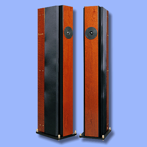

β) SERIES 2
Bosendorfer's mid-sized floor standing loudspeaker. Two-way system with one treble speaker, two low/mid – range drivers and two plate resonators.
Frequency response 31-25,000 Hz (±3 dB)
Crossover frequency 130 Hz*; 2.9 kHz
Power rating 90 watts
Music rating 180 watts
Impedance 8 ohms
Operating performance 1.7 watts (for 91 dB/m)
dimensions (h x d x w) 1110 x 304 x 168mm
Weight 22.5 kg (48 lbs)
finishes
AC2 satin-finish ivory body,
black side pieces and front
VC 2S black semigloss
VC 2H black high-polish
VC 2E black high-polish
body, side pieces and front in: burl maple, burl walnut, birds eye maple, pomele, burl birch, maple or Cherry

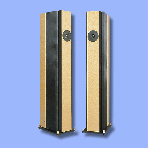

γ) SERIES 1
Bosendorfer’s smallest floor standing loudspeaker. Two-way system with one treble , one low/mid-range drivers and one plate resonator.
Frequency response 35-27,000 Hz (±3 db)
Power rating 60watts
Music rating 120watts
Impedance 8 ohms
Operating performance 2.0 watts (for 91 dB/m)
dimensions (h x d x w) 927 x 245 x 160mm
Weight 13.0 kg (29 lbs)
finishes
AC 1satin-finish ivory body, Black side pieces and front
VC 1S black semigloss black high-polish
VC 1Eblack high-polish body, side pieces and front in: burl maple, burl walnut, birds eye maple, pomele, burl birch, maple or Cherry
