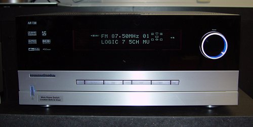

Απο τα μεσα Δεκεμβριου περιπου θα βρισκετε στα καταστηματα με τιμη κοντα στα 2.500 ευρω(αν κανω καπου λαθος διορθωσε με Νικολακη)
Με Faroudja 2300 δυναται να μετατρεψει ολα τα πεπλεγμενα σηματα απο component σε προοδευτικα.
Dolby Digital/DTS 5.1
Dolby digital 5,1 ex and DTS IT Matrix/Discrete 6.1
Dolby pro Logic IIx and DTS Neo:6
Dolby Virtual Speaker
Dolby Headphone
Logic 7 (Eerklaerungen in many HK tests, e.g. here: Harman Kardon AVR-630, Harman Kardon DPR-2005, Harman Kardon AVR-230)
VMAx Surround - headphone exit
With a number of complex computations on basis of intensive investigations, how tones are taken up and processed by the brain, VMAx forms a three-dimensional sound field using from only a left and a right front loudspeaker. VMAx ensured virtualisierten Surround sound for almost any similar or digital source - including coded Dolby digital 5.1-Quellen - for the loudspeaker and headphone exits. VMAx is Dolby certified and makes two modes available: "close" or "far".
High-quality equipment characteristics
DSP processor: Harman Kardon uses an ultramodern Cirrus log IC processor (CS49400). This has 24-Bit-Festkomma-DSP-Engines and a 32-Bit-Audio-Post-Prozessor. The DSP uses a 0,24-Micron-Architektur. Therefore the crucial components for Dolby digital and DTS data fetch on the board are and not in the external memory, whereby loading procedures are accelerated and the precision is increased. The CS49400 ordered according to HK over a outstanding audio quality and offers additionally DSP resources, so that a problem-free implementation of the newest modes, as for example for Dolby HeadPhone, was possible Dolby Virtual Speaker and DTS 96/24. Since in addition a Flash memory is used, in order to store the updatable Surround algorithms, these can after introduction and certifying new DSP modes to be examined and adapted.
Complete digital bass management for 6/8-Kanal-Direkteingaenge: Some DVD A or SACD Player do not have an integrated bass management system. A connection of such Player to the 6/8-Kanal-Direkteingaenge of a conventional A/V a/V-Receivers (likewise without bass management) leads to the fact that the attitudes for the loudspeakers cannot be made correctly: Bass signals are not rerouted at the Subwoofer, and the status LARGE is assigned to all loudspeakers. This is particularly unpleasant, if one uses a satellite system - straight satellites run in principle over "small". The AVR 7300 offers, in order to solve this problem effectively, a complete digital bass management. Become DVD A or a SACD Player without integrated bass management, which solves this problem and guarantees an optimal bass performance also when connecting of an DVD audio or a SACD Players without internal bass management.
Today only extremely little receiver on the market is offered, which has integrated A-BUS®ready technology. Among these few models selected receiver of Harman Kardon rank. If these are used together with an optional A-Bus-keyboard or a A-Bus-Steuermodul (Harman Kardon STARTING FROM 1), the acoustic irradiation of adjacent secondary rooms is comfortable and without additional external power amplifier possible. In order to use the AVR 7300 together with or 2 STARTING FROM 1-Steuereinheit, is the connection of the keyboard and/or the module, which is in the secondary room, over a CAT according to standard 5-Ethernet-Verkabelung to manufacture (for computer network is used), which is particularly for the installation in the wall suitable. The connection on the side of the receivers is made by a RJ-45-Stecker according to standard according to the instructions supplied with the A-Bus-module. Further information to A-BUS finds you on the Website www.a bus.com.au.
Multi-zone ability: With the AVR 7300 a signal source (similar) in 2 bordering areas (zone) can be heard, during in the main area another signal source (digital or similar) is shown. For the simplification of the operation of this function all models with multi-zone ability order laid out remote maintenance over one particularly on this range of application. Additionally to the selection of the signal source and for adjusting the volume in the secondary room, the AVR offers comprehensive options for supplying the loudspeakers in the secondary zone:
Using the Multiroom LINE Audioausgaenge the selected signal source can be shown over optional external amplifiers, which can be adapted to the defaults of the installation.
If the 5.1-Betriebsart is selected for the main area, can the rear left and right Surround Verstaerkerkanal for supplying the adjacent zone to be used. Additional amplifiers are not necessary thus.
The use the integrated A-BUS ready technology offers the possibility of the connection of two optional A-Bus-modules to the AVR 7300. The loudspeakers of the adjacent zone are then supplied directly via the module or the keyboard. An additional wiring for river, IR sensor or audio gain control is not necessary.
The AVR 7300 offers beyond that Multiroom enterprise also for the display space.
Bi-directional R-S 232 interface, which can be used not only for the computer/key on-board price increase of the component but also to the firmware update (8 MT Flash MEMORY, is additionally integrated). In this way also later still new DSP modes can be up-played.
All relevant data:
Model AVR 7300
Type To High end 7,1 AV aV-Receiver
Unverb. PE inclusive. VAT. € 2,499, -
Achievement:
Power output RMS/8Ohm with enterprise of all channels at the same time 7 x 110 W RMS
Power output RMS/8Ohm in the Stereobetrieb 2 x 125 W RMS
Kind of amplifier HCC +/- 75 ampere
Distortion factor 0,07%/8Ohm
Frequency response @ 1W (-3dB) 10 cycles per second - 130 kHz
Rauschspannungsabstan (IHF A) > 100 railways
Current supply Single-aperture core transformer with separate power packs for Pre Main and front and Rear of channels
Max. capacity 1,36 KW (with 7 channel rated output)
Supported DSP formats
DTS/DTS IT Discrete, matrix/Neo:6 Yes
DTS 96/24 Yes
Dolby digital/Dolby digitally ex/Dolby pro Logic II/Dolby pro Logic IIx Yes
Logic 7/VMAx Yes
Circle Surround -
MP3/WMA Yes
HDCD Yes
Dolby HeadPhone/Dolby Virtual Speaker Yes
Virtual Surround Yes
Multi Channel stereo 5/6/7
OTHER Surround mode 3
Equipment audio
Similar to input/outputs 8 (inclusive Front)/ 6 (inclusive front)
Opt. of digital in/exits 4 (inclusive Front)/ 2(Inkl. Front)
Coax. Digital in/exits 4 (inclusive Front)/ 2(Inkl. Front)
Digitally Upsampling Yes
Since transducer 24 bit/192kHz
Digitally Processor Crystal 49400
Quadruple Crossover bass management Yes
SACD /DVD A bass management with 6/8-Kanal direct entrance Yes
Equipment video
Composit of input/outputs 6 (inclusive Front)/ 4 (inclusive front and monitor)
S-video of input/outputs 6 (inclusive Front)/ 4 (inclusive front and monitor)
Componenten a /Ausgaenge 3/1
Range of the YUV of entrances 100 MHz
Treatment of video pictures
Digital video Formatwandlung FBAS< >S Video< >YUV
DCDi processor Faroudja 2300
Noise Shaped video -
Progressive Scan video exit Yes
Other
Vorverstaerkerausgaeng 7,1 channels
Subwoofer exit Yes
Multi Room audio exit similar Yes
Multi Room video exit Yes
Bi-directional R-S 232 interface Yes
DC of trigger Yes
Front Speaker A+B −
Surround Speaker A+B −
Configurable Rear of channels for Multiroom Yes
D.Bus In/Out −
A-BUS Multiroom Ausgaaenge (2)
External IR In/Out ●
Lip Sync time Delay To 80 ms
Mass (B x Hx T) 440 x 194 x 521 mm
Execution Silver aluminum
Weight 28,6kg
