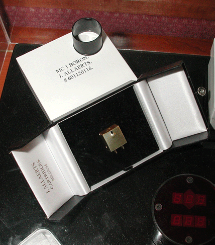

Jan Allaerts MC1 B - a jewel appropriately encased in a Black jewel box
