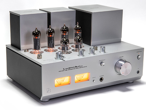

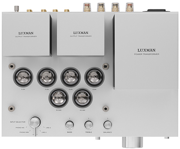

The amp's user controls are spread across its top and front panels. On the former are a rotary Input Selector switch, followed by three small potentiometers for Bass, Treble, and Balance. On the SQ-N150's front panel are twin output-level VU meters, with a single Display control button. To the right of that are a Line Straight pushbutton switch—this bypasses the tone controls—plus a Phones jack, a Volume knob (with an embedded orange LED that flashes when the volume level is changed), an on-off button labeled Operation (with its own orange LED), and an IR receiver for the remote handset

Tubed integrated amplifier with remote control. Tube complement: 4 EL84 output tubes, 2 12AX7/ ECC83 small-signal tubes. Inputs: 3 line, single-ended (RCA), phono MM/MC (RCA). Maximum power output: 10Wpc into 6 ohms (8.25dBW). Frequency response: 20Hz–20kHz ±0.5dB (phono); 20Hz–80kHz, –3dB (line). THD (1kHz, 10W into 6 ohms): 1% or less. Sensitivity/Input impedance: 3.0mV/47k ohms (phono, MM); 0.33mV/100 ohms (Phono, MC); 180mV/47k ohms (line). S/N (IHF-A): >84dB (phono, MM); >64dB (phono, MC); >95dB (line). Power consumption: 98W.

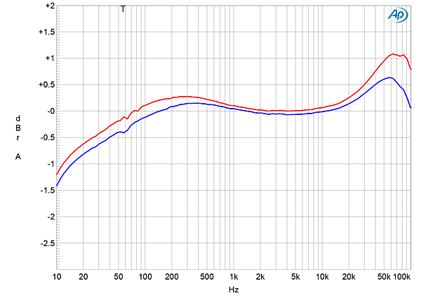

Luxman SQ-N150, MM input, response with RIAA correction (left channel blue, right red) (0.5dB/vertical div.).

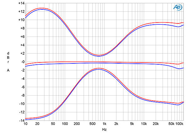

Luxman SQ-N150, frequency response at 300mV into 8 ohms with Bass and Treble controls set to "0dB," maximum, and minimum (left channel blue, right red) (5dB/vertical div.).

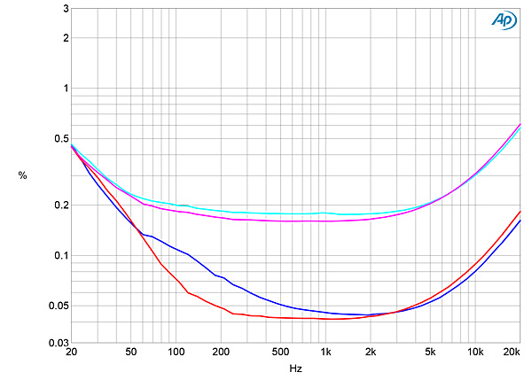

Luxman SQ-N150, THD+N (%) vs frequency at 2.38V into: 8 ohms (left channel blue, right red), 4 ohms (left cyan, right magenta).

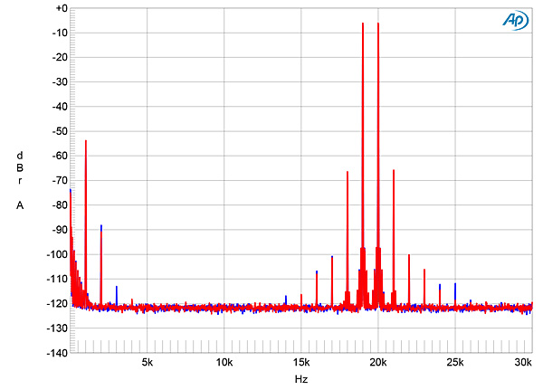

Luxman SQ-N150, HF intermodulation spectrum, DC–30kHz, 19+20kHz at 3W peak into 8 ohms (left channel blue, right red; linear frequency scale).

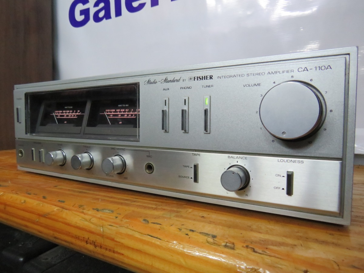

Είναι ο δικός σου;
Ελπίζω να του έχεις βάλει κάποια ματόχαντρα μη στον ματιάσει κάνεις, υπάρχουν πολύ ρετρολάγνοι εδώ..:smile:
261
80
...δεν ειναι o δικός μου, αύριο όμως με το φως της ημέρας θα τον φωτογραφησω και θα αναρτηθεί μαζί με τα αντίστοιχα vu meters και του deck ! Χαχαχα επειδή το σύστημα περιλαμβάνει και fisher deck με vu meters παρακαλώ! Χαχαχα
