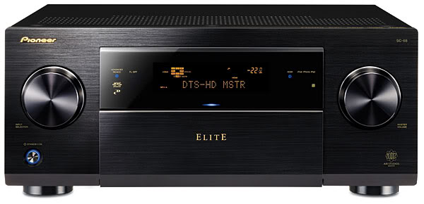

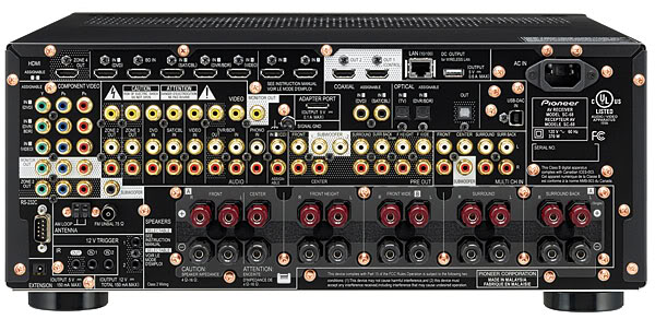

Pioneer SC-68 (Ο Αμερικάνικος SC-LX86)
Two channels driven continuously into 8-ohm loads:
0.1% distortion at 144.5 watts
1% distortion at 191.6 watts
Five channels driven continuously into 8-ohm loads:
0.1% distortion at 92.3 watts
1% distortion at 138.8 watts
Seven channels driven continuously into 8-ohm loads:
0.1% distortion at 90.0 watts
1% distortion at 113.8 watt

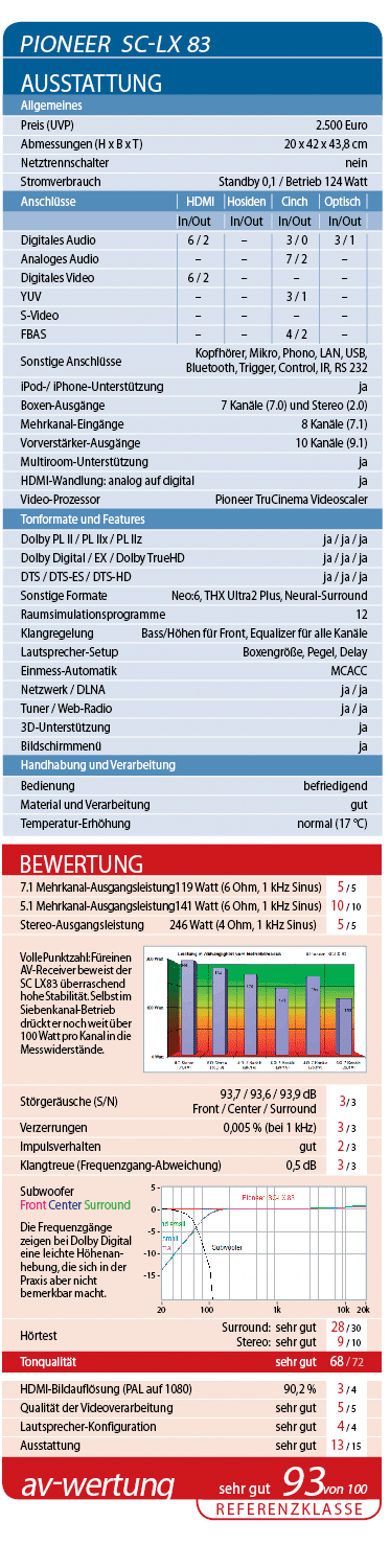

Pioneer SC-37 (Ο Αμερικάνικος SC-LX83)
0.1% distortion at 135.7 watts
1% distortion at 171.9 watts
0.1% distortion at 125.4 watts
1% distortion at 164.7 watts
