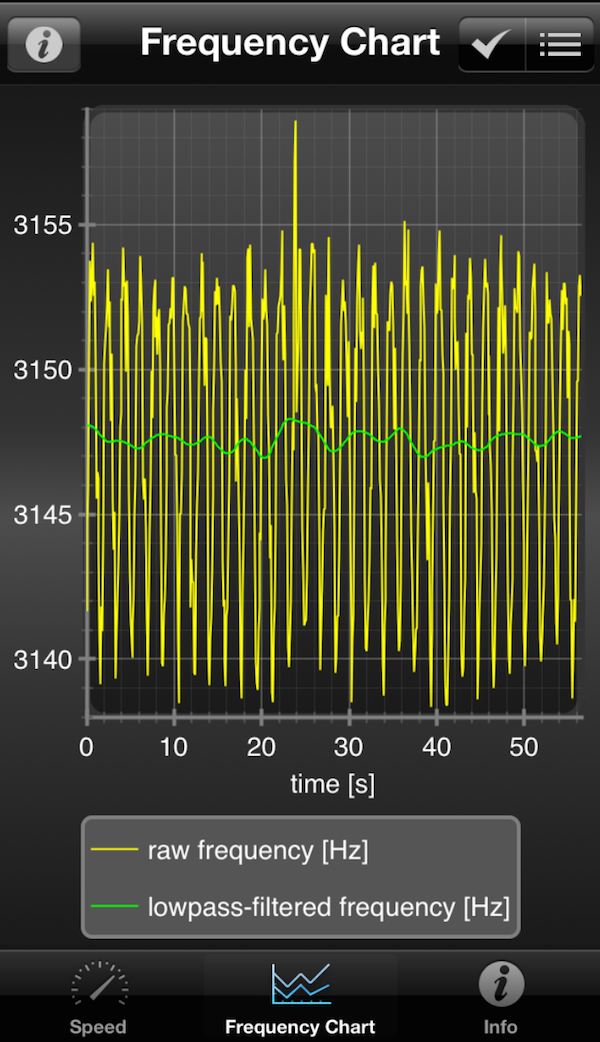

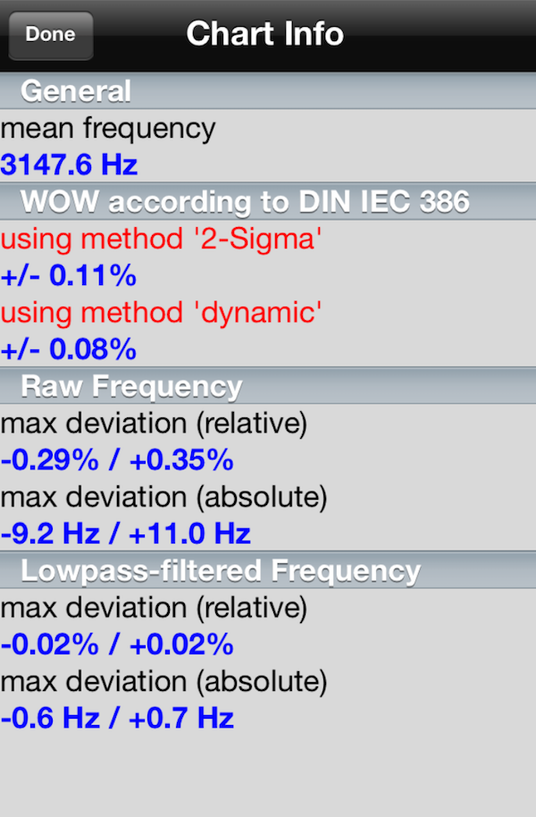

The PlatterSpeed app numbers and graph look good considering the Classic SB Superpack’s price point. First note that the turntable spins at just a shade slower than perfect at 3147.6Hz for a 3150Hz test tone. That’s a negligible deficit that a strobe wouldn’t pick up. WOW is low and the low pass filtered frequency deviations both relative and absolute are very low.
Looking at the graph, you’ll note that the low pass filtered green line is not the straightest you’ll have observed (if you’ve been paying attention to this in the AnalogPlanet turntable reviews). I suspect that’s due to the speed controller’s attempt to keep things “tidy” but having to work at it due to the relatively light platter. Still, both charts indicate good speed consistency and stability.
