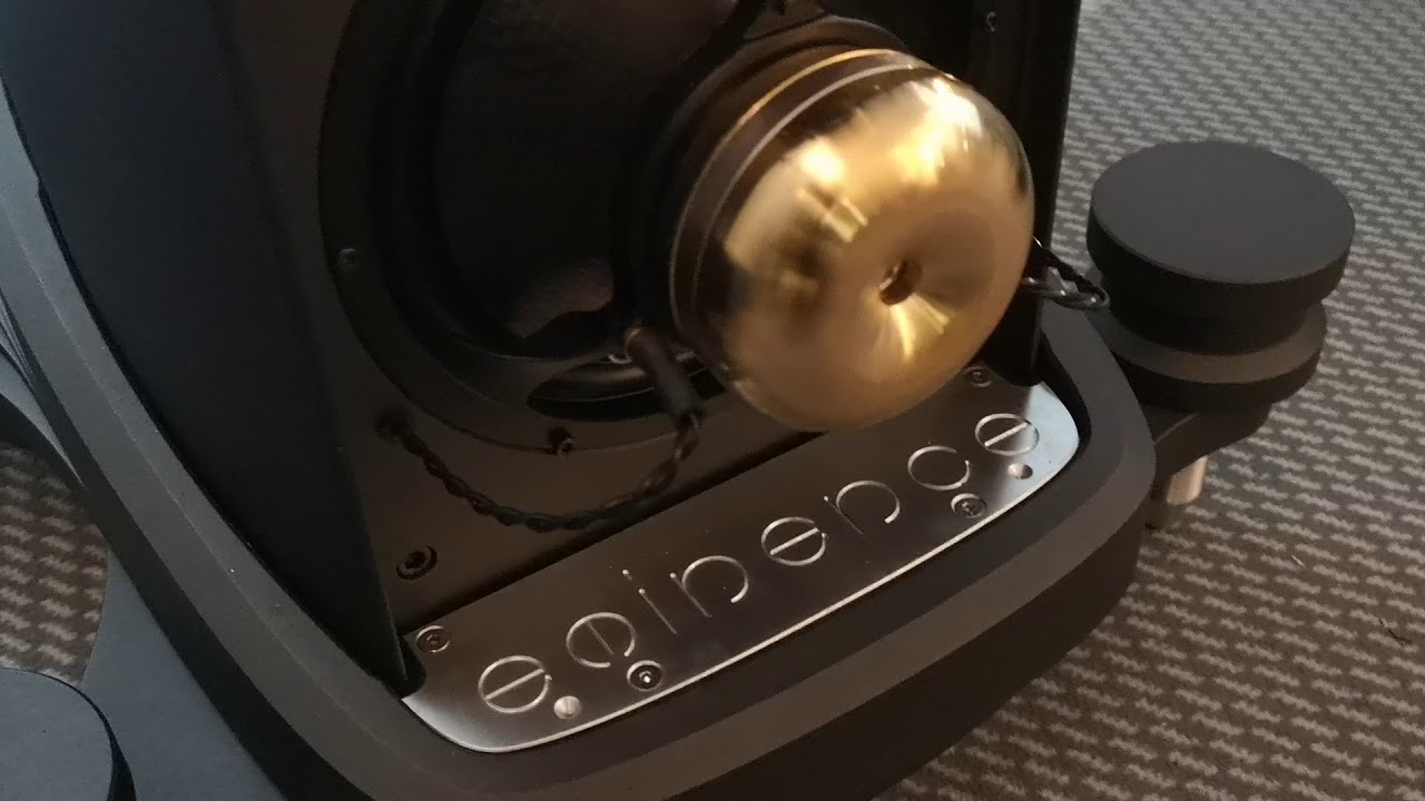

The ten-driver Eminence is a two-and-a-half-way design. You can see in Fig.1 that the lower two “backward-facing” drivers in the baffle are mated to two identical 7" drivers inside the cabinet in an isobaric configuration (we’ll address this design element in more detail later). The next two drivers up the baffle handle the lower bass. Just above the upper-most backward-facing woofer is a 7" midrange, and then the tweeter. The top two 7" drivers handle the upper bass. As you can see in Fig.1, each driver array is mounted in its own sub-enclosure within the cabinet. All the sub-enclosures are sealed, except for the one housing the isobaric woofer array, which is ported out the bottom of the cabinet. Two pairs of binding posts are provided for bi-wiring.
The cabinet has been made as small as possible so that its sonic contribution is minimized. The smaller the cabinet, the easier it is to damp, and any resonances that remain will produce less unwanted cabinet sound. The narrow baffle and its curved shape also reduce diffraction. Despite the cabinet’s relatively modest size, the internal volume is considerable, owing to the thinness of the carbon-fiber composite structure. The speaker has a very small visual presence when viewed from the listening position. I can’t think of another flagship-level loudspeaker with this small an enclosure or footprint.
