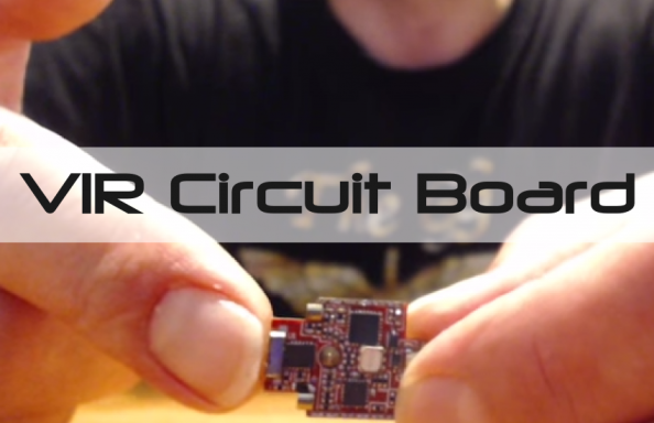

Description
The VIR is a state of the art electronic module created by GG, this latest GG innovation has taken 3 years in design and production.
The reason for the size is part of the design, Imeo wanted to make something very small to reduce the overall size of the mod. As well as the size the main purpose of VIR is to offer a product that does more than provide a good vape, it offers a much safer vape.
It achieves this in a number of ways all powered by the tiny PCB which is the heart of VIR. The technology behind VIR is all programmed into a unit the size of a thumbnail.
The VIR introduces a new paradigm in the vaping world, Imeo himself describes it as: "Real Greek Magic". An smart electronic module that understands your style of vaping.
It is not a temperature limit protection device, it is the first electronic module that provides real temperature control: you vape all the time at the specific configured temperature.
