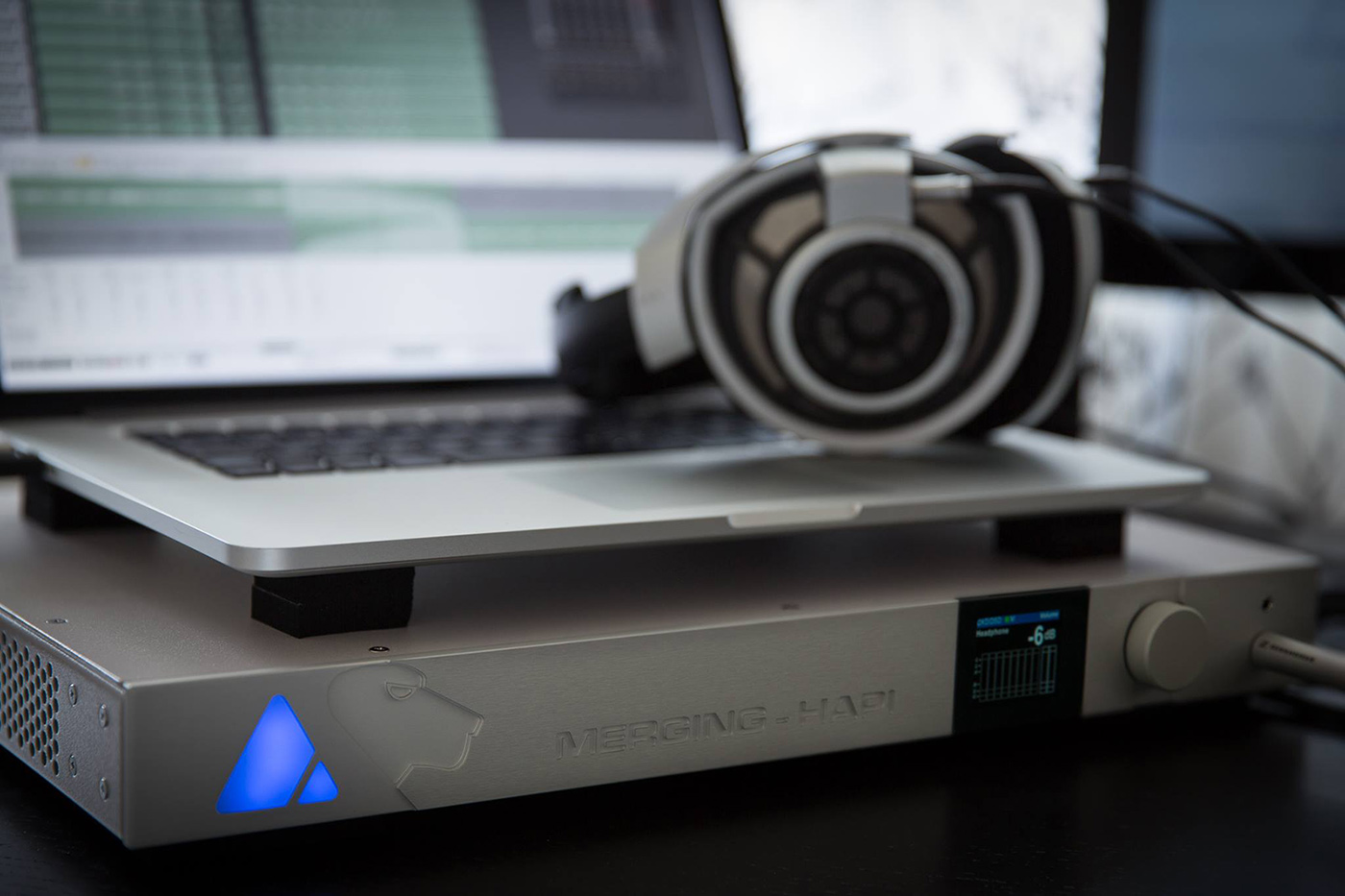

Not going that route would mean that in order to obtain a ‘pure’ DSD master no editing would be possible; unthinkable, except maybe for remasters of analog tapes. The pragmatic way out has become: make your recording in PCM, edit and mix digitally, then convert to DSD. This is how the vast majority of SACD’s has been made. This also allowed to convert the A-to-D output directly to PCM in stead of via DSD, thus avoiding at least one DSD step.
If a recording made in DSD has to be processed, e.g. the loudness has to be adjusted or some equalizing is required, then the DSD signal has to be converted to PCM in order to be able to do the processing. In the PCM format the signal can be processed, i.e. “produced” as required in order to get a final version. In such a case it does not make sense to do a recording in DSD to start with. A PCM recording at e.g. 88.2kHz / 24 Bit would make much more sense. After the production process the file can always be converted to DSD if required.
Because it has been extremely difficult to carry out DSP operations (for example performing EQ, balance, panning and other changes in the digital domain) in a one-bit environment, and because of the prevalence of solely PCM studio equipment such as Pro Tools, the vast majority of SACDs—especially rock and contemporary music, which rely on multitrack techniques—are in fact mixed in PCM (or mixed analog and recorded on PCM recorders) and then converted to DSD for SACD mastering.
To address some of these issues, a new studio format has been developed, usually referred to as DSD-wide, which retains the high sample rate of standard DSD, but uses an 8-bit, rather than single-bit digital word length, yet still relies heavily on the noise shaping principle. DSD-wide is PCM with noise shaping—and is sometimes disparagingly referred to as "PCM-narrow"—but has the added benefit of making DSP operations in the studio a great deal more practical. The main difference is that "DSD-wide" still retains 2.8224 MHz (64fs) sampling frequency while the highest frequency in which PCM is being edited is 384 kHz (8fs). The "DSD-wide" signal is down-converted to regular DSD for SACD mastering. As a result of this technique and other developments there are now a few digital audio workstations (DAWs) that operate, or can operate, in the DSD domain, notably Pyramix and some SADiE systems.
