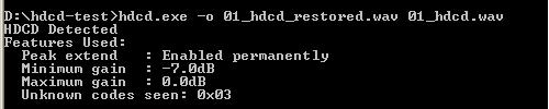

Το δοκιμάσα πάλι και κάτι βγάζει (φωτό)
Ανάλυση των δύο:
-hdcd_cd
Left Right
Min Sample Value: -30243 -31811
Max Sample Value: 31441 32131
Peak Amplitude: -.36 dB -.17 dB
Possibly Clipped: 0 0
DC Offset: 0 0
Minimum RMS Power: -113.61 dB -103.99 dB
Maximum RMS Power: -5.68 dB -3.7 dB
Average RMS Power: -20.42 dB -18.95 dB
Total RMS Power: -18.01 dB -16.38 dB
Actual Bit Depth: 16 Bits 16 Bits
Using RMS Window of 50 ms
-hdcd_restored
Left Right
Min Sample Value: -17217.63 -21524.13
Max Sample Value: 19826.94 24805.5
Peak Amplitude: -4.36 dB -2.42 dB
DC Offset: 0 0
Minimum RMS Power: -112.73 dB -114.73 dB
Maximum RMS Power: -11.65 dB -9.31 dB
Average RMS Power: -26.44 dB -24.97 dB
Total RMS Power: -24.03 dB -22.38 dB
Actual Bit Depth: 20 Bits 20 Bits
