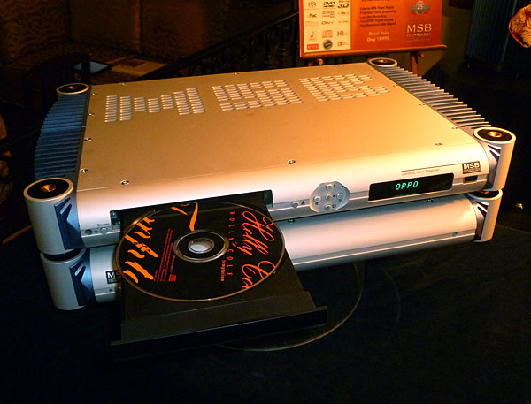

The attack of the clones...:126:
CES 2011 και εχουμε :
1. BDP-93/95 Nuforce Edition : 3 models 93NE ($899), 93NXE ($1.299), 95NXE ($2.495)
zone A / region 1 only
φωτο
2. Cabridge Audio Azur 751BD ( 800 GBP )
3. MSB Technology Universal Media Transport ($3.995)
177.681
