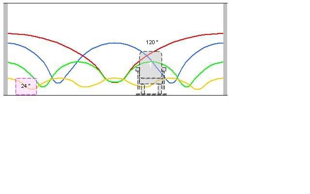

Na ena kalo paradeigma, se domatio 7x4.5mt, to opoio dialexa tuxaia.
Exoume enan tupo pou exei to sub sti gonia tou domatiou, kai kathetai opou tou aresei, giati etsi tou eipe o filos tou.
Exo diagramma apokkrisis xamilou , gia na deite tis diafores.
Stin proti periptosi, O,TI kalodia kai na valei, to xamilo tha einai xalia.
Epeidi omos o calibrator den sernetai sta gonata gia na psaxnei, oute allazei tous konous apo atsali se alouminio,mpas kai ftaixei to mpaso, opos upostirizoun ta katastimata, kanei kapoies allages , kai deite pos allazei i appokrisi.
To software auto einai tis www.designcinema.com , ean anarotieste. :D
PLAI PRIN http://i106.photobucket.com/albums/m267/dstamos/side.jpg
MPROSTA PRIN http://i106.photobucket.com/albums/m267/dstamos/front.jpg
APPOKRISI PRIN http://i106.photobucket.com/albums/m267/dstamos/responsebefore-1.jpg
META... http://i106.photobucket.com/albums/m267/dstamos/frontafter.jpg
http://i106.photobucket.com/albums/m267/dstamos/sideafter-1.jpg
http://i106.photobucket.com/albums/m267/dstamos/responseafter.jpg
Elpizo na peirate mia idea, ti kanei i ixitiki rithmisi se ena sistima, anexartitou timis. :D

Το soft δεν είναι της HAA?
Με αyτο δουλεύω για τις πρώτες επεμβάσεις αλλά δεν το είχα πάρει από την DCP.
Μας το είχαν δώσει στο σεμινάριο :?
2.488
383
To pira apo ton Dennis Erskine.
O Dennis Erskine einai ki autos ekpaideutis tis HAA, alla didaskei mono level II.
Ego pos kai den to pira tote? :?
To thema einai pos mporei kapoios na dei tis diafores tou prin-meta, eite einai hi-endas, eite hi-fiakias! :D
