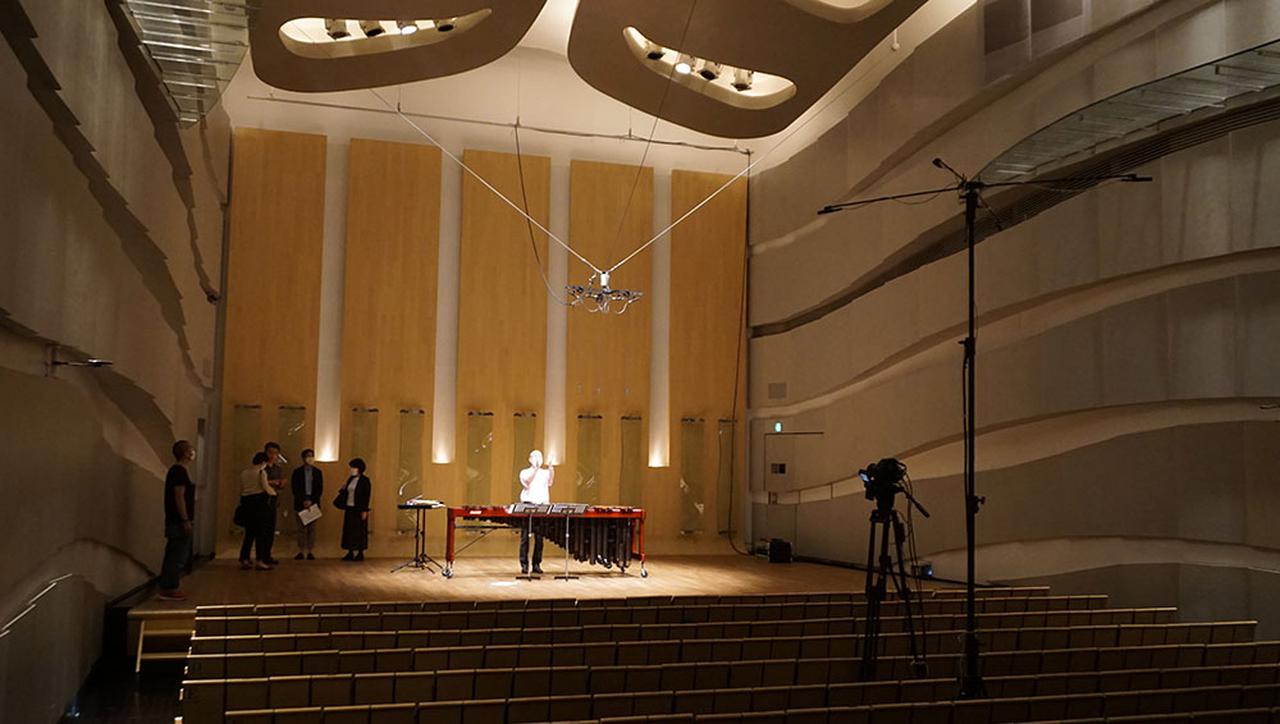

As part of our 10th Anniversary celebrations, on October 28th we will support the live-streaming of the piano and drum duo concert by Mayo Nakano and Takanobu Baba at Hakuju Hall in Tomigaya to AURO HQ Belgium. Organised together with the well known Japanese broadcaster WOWOW this will be the world's first live image distribution of 3D audio using the AURO-3D immersive audio coding technology Auro-Codec
οποιος τελει, εδω θα κανει προσπαθεια.
ειναι και για 5.1 οσοι δεν εχουν auro3d :biggrin:
