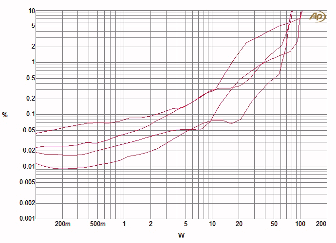

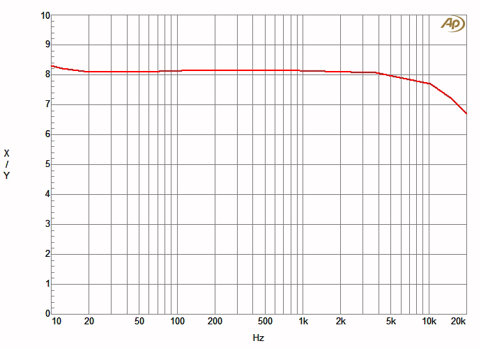

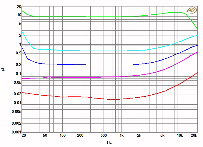

Εντελώς τυχαία κοίταγα τώρα τις μετρήσεις ενός λαμπάτου Audio Research VT80...
Δείτε εδώ: https://www.soundstage.com/index.ph...ion-vt80-stereo-amplifier&catid=97&Itemid=154
Chart 2 - Distortion as a function of power output and output loading
(Line up at 20W to determine lines)
Top line = 4-ohm SMPTE IM distortion
Second line = 4-ohm THD+N
Third line = 8-ohm SMPTE IM distortion
Bottom line = 8-ohm THD+N
Chart 3 - Distortion as a function of power output and frequency
(8-ohm loading)
Red line = 1W
Magenta line = 10W
Blue line = 30W
Cyan line = 60W
Green line = 75W
Chart 4 - Damping factor as a function of frequency
Damping factor = output impedance divided into 8
Damping factor 8 κυρίες και κύριοι, που φώναζε και ο ΚώσταςEAR πριν χρόνια.
