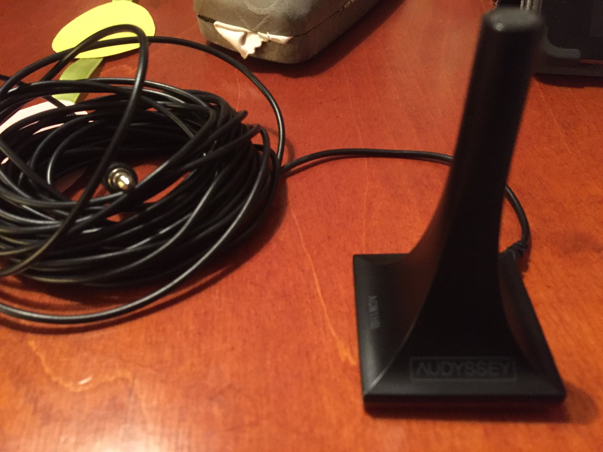

ΥΣ: O denon δεν εχει το μικροφωνο της audyssey και αν καποιο μελος το εχει για πωληση και δεν το χρειαζεται ας στειλει μηνυμα καθως στη κινοτεχνικη μου ειπαν για μετα το πασχα με παραγγελια.

δεν είναι σωστό να βάλεις όποιο μικρόφωνο να'ναι πάνω, νομίζω πρέπει να κάνεις παραγγελία με το serial number του ενισχυτή.

Είπα "νομίζω", αλλά για να είμαστε ακριβείς όλο το στόρυ έχει ως εξής.
d)4. Do I have to use the mic that came with my AVR or PrePro?
The easy answer to that is yes. Your Audyssey mic has a calibration file which is stored inside your AVR or prepro. If you use a mic from another unit, then there is a chance that the calibration file will be inappropriate for that mic and the whole calibration will be off as a result. So to be absolutely sure, then always use the mic that was bundled with your unit.
However, it is also possible to use the mic from another unit of the same brand as your unit - eg, a Denon mic with a Denon unit, an Onkyo mic with an Onkyo unit and so on. The caveat to this is that the mic must be of the same type and model. Early Onkyo units, for example, were supplied with a black, round, flat mic (often called a 'puck' mic for its vague resemblance to an ice hockey puck). Later Onkyos were supplied with a silver mic shaped like a long pyramid or the Eiffel Tower. These 'puck mics' and 'Eiffel Tower' mics are notinterchangeable. The current mic used by Onkyo is designated ACM1H and this is printed on the box the mic comes in.
Note for Denon units:
The ACM1H mic is interchangeable with the DM-A409 mic used with Denon AVR-XX09/X89 through AVR-XX12 models. Older Denon models use the following mic types, neither of which is compatible with each other or the newer DM-A409/ACM1H mics:
  • XX06: DM-S205 (hockey puck style)
  • XX08/X88: DM-A405 (tower style)
  • 4308/5308/AVP: DM-A505Z
  • 5308/AVP (w/3D upgrade): DM-A409
With the introduction of the new Denon AVR-XX13 models, Denon is now including the new "ACM1HB" black mic which Audyssey has confirmed is interchangeable with the DM-A409 (Denon) and ACM1H (Onkyo, Marantz) mics.
(Thanks to AVS Member jdsmoothie for Denon mic information)
UPDATE June 2012: Onkyo, Marantz and Denon units now all use the same ACM1HB mic.
If you damage or lose your mic, they are available from your unit manufacturer for around $US25. Be very careful about buying from other sources such as auction sites as there have been counterfeit mics (especially from non-USA eBay resellers) seen there (as verified by Audyssey) and these will quite probably not be properly calibrated by your unit's calibration file.
Long story short - take care of your mic and preferably use the one that came with your unit.

Είναι τόσο απαραίτητη η χρήση του μικροφώνου?
Αν ορίσουμε τις αποστάσεις manual δεν είναι το ίδιο πράγμα?
43.528
78.570
Με το μικρόφωνο γίνεται ισοστάθμιση, οι αποστάσεις είναι απλώς bonus.

Άλλο το μικρόφωνο μετρήσεων, άλλο της βιντεοκάμερας, άλλο του Audyssey.
Για μετρήσεις, UMIK-1 απο την PSA.
