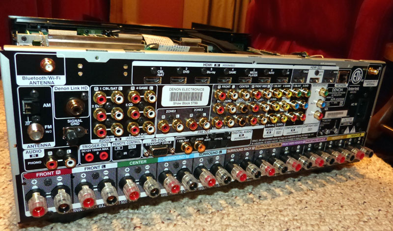

With the low setting engaged, no matter how many channels were driven, the output was limited to about 25 watts/channel with one channel driven and significantly less with all channels driven (18 watts for seven channels driven). Denon jumped on the impedance switch bandwagon to get the UL 4 ohm rating, but severely choked off performance in doing so. This is likely due for two reasons, inadequate heat sink area to keep the receiver running cool enough for the rating, and an overzealous and cautious safety engineer that took things just a little too far. Regardless of whatever speaker impedance you have, under NO circumstance do I EVER recommend using the low impedance setting. Just leave it at the default 8 ohm setting and forget there is even an option to change it.......Regardless of whatever speaker impedance you have, under NO circumstance do I EVER recommend using the low impedance setting.
Όταν επιλεγεί το 4Ω για τα ηχεία, ο ενισχυτής περιορίζεται σε λιγότερα απο 25W ανα κανάλι...

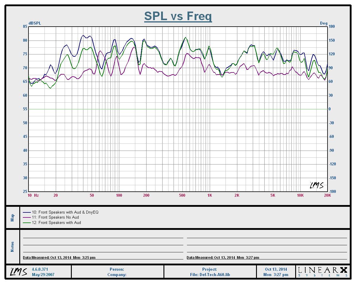

Τέλειο το κάνει.
ειναι θεμα .....μεγαλες βουτιες με 12db διαφορα !!!!!!
ειναι +/- 6 db το οποιο θα λεγαμε οτι δεν χρειαζεται καν να μπεις στον κοπο να κανεις αυτοματη ισοσταθμιση ...παιρνεις ενα ντεσιμπελομετρο μετρας σταθμες και βαζεις αποστασεις ηχειων....και αποτι δειχνει παιζει καλυτερα φλατ ο av
