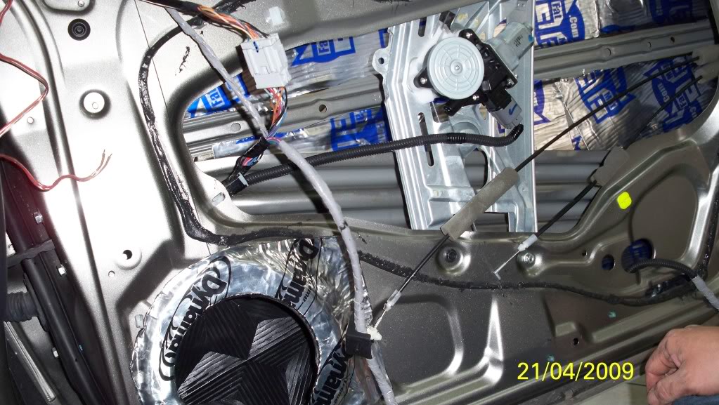

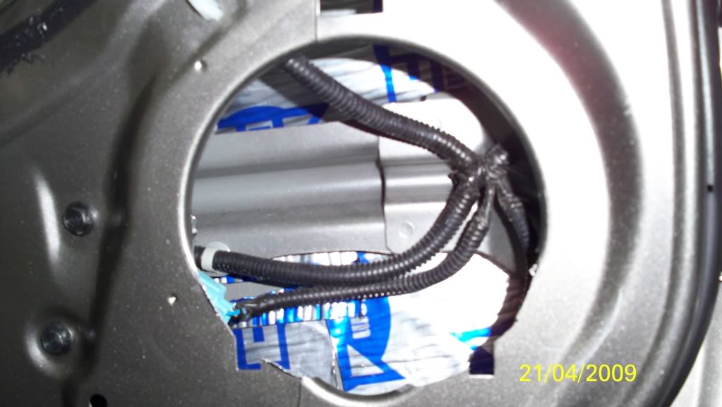

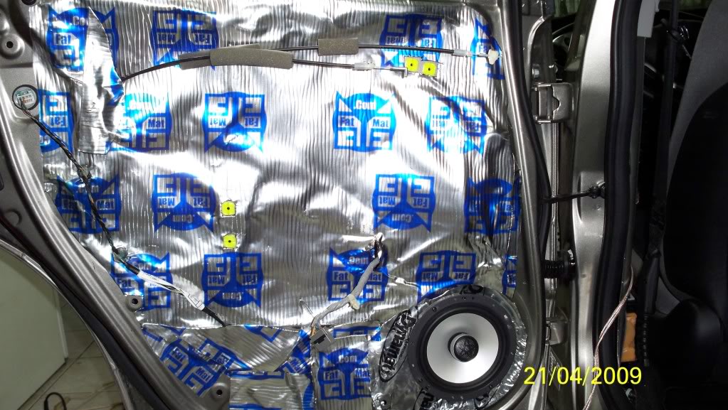

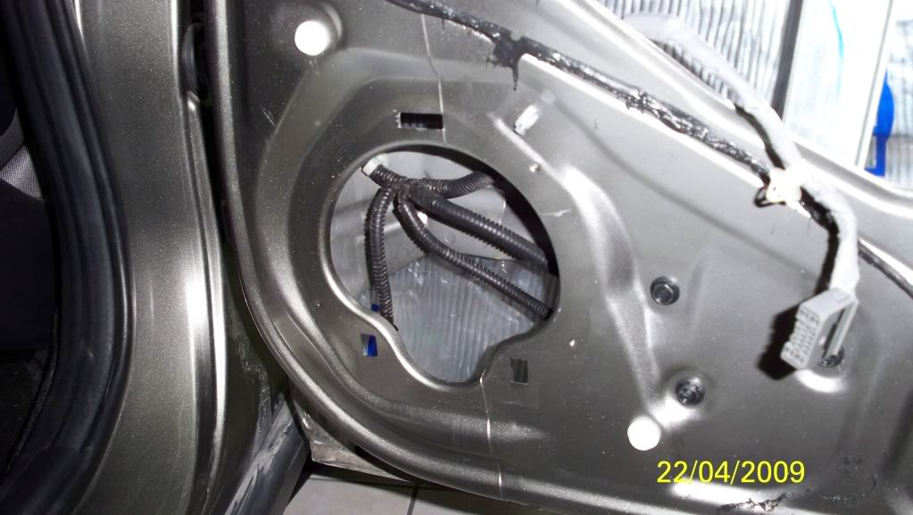

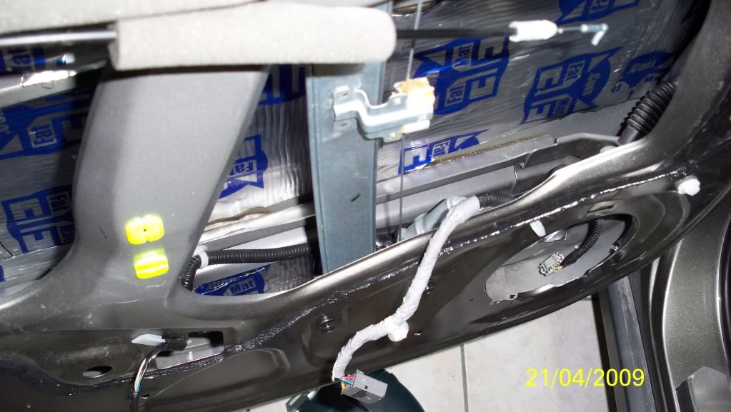

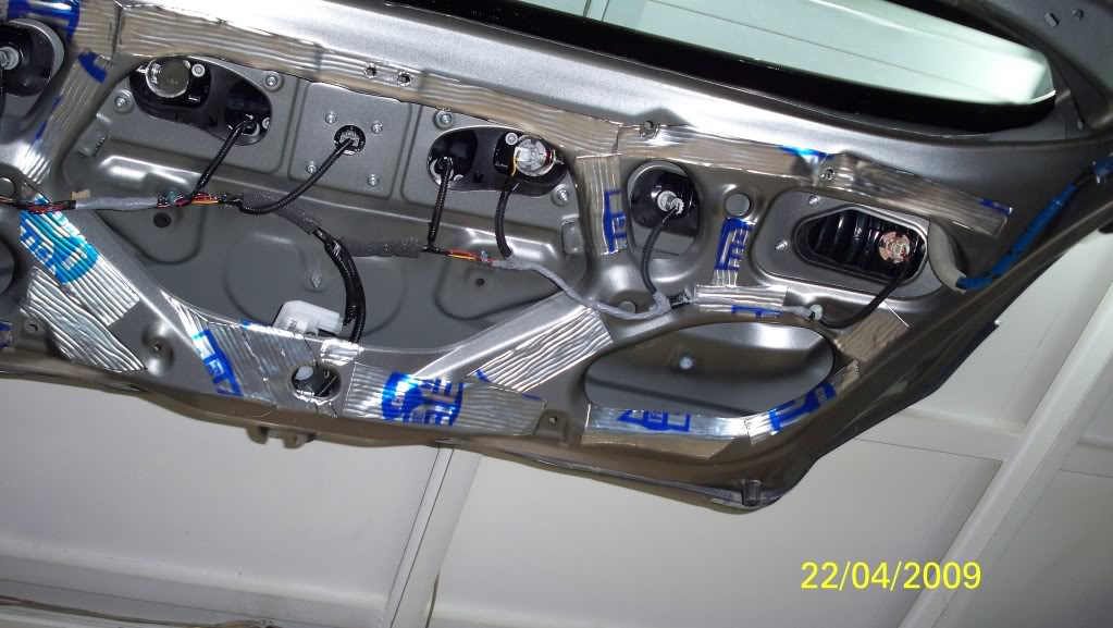

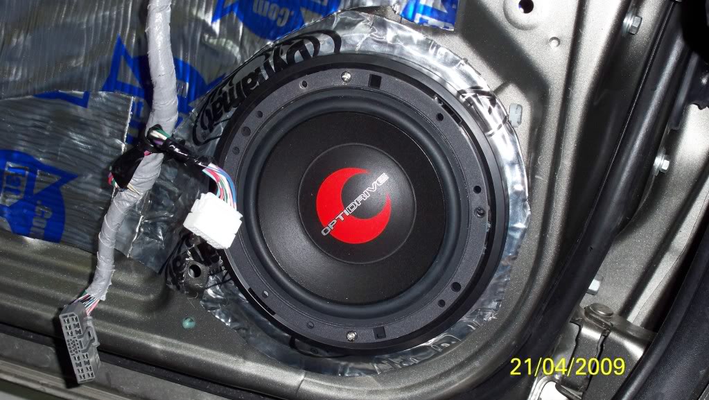

πρωτο μελημα ηταν η ηχομονωση στις πορτες.το fat mat ειχε υπολογισθει και αγορασθει μονο για αυτο το λογο και ευτυχως ηταν υπερ αρκετο...
ολες οι πορτες απογυμνωθηκαν και ενα διπλο στρωμα φατ ματ τοποθετηθηκε,dynamat γυρω απο τα ηχεια και dynoxorb πισω απο τους μαγνητες των ηχειων...

PROBLEMS....
during the installation we faced minor problems.
1.placing the new speakers was impossible,so we had to trim a little all 4 doors at that spot.
2.spacers were used for the front only,in order to have enough clearance from the windows
3.dynaxorb was not placed in the rear windows due to a door's nerve....
4.I had to put back the original speaker fascia (incorporated on the panel) as it is too risky to try and cut it off and be replaced by the new one....

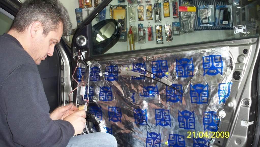

Απάντηση: Honda civic '08-Pioneer-Lanzar.

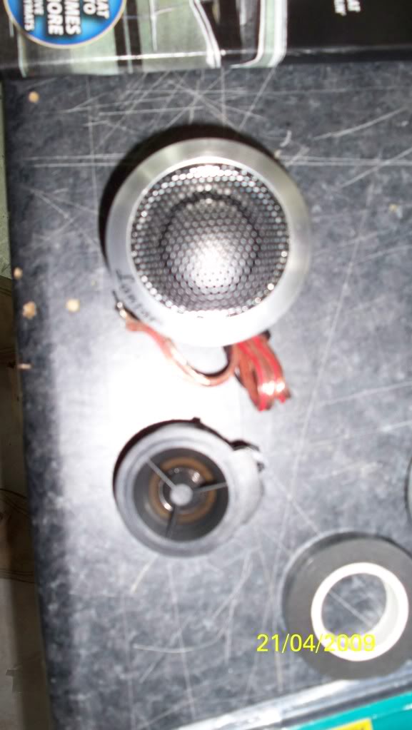

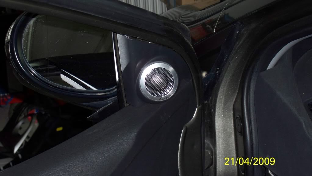

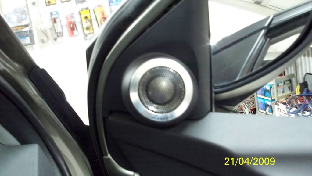

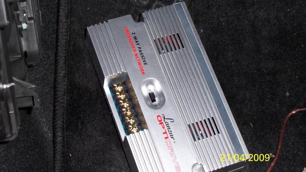

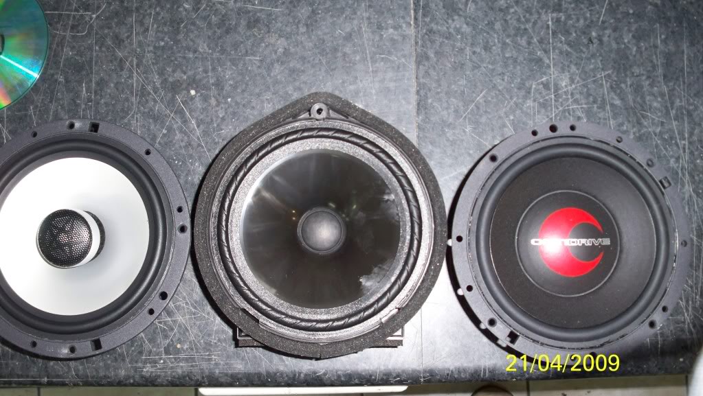

that is the end of day one.... (doors day )
here are some more pics of the tweeter, the front huge crossover, and comparison of the old and new speakers....

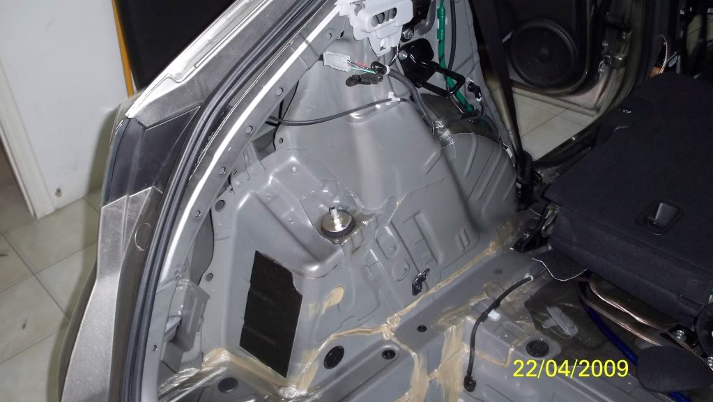

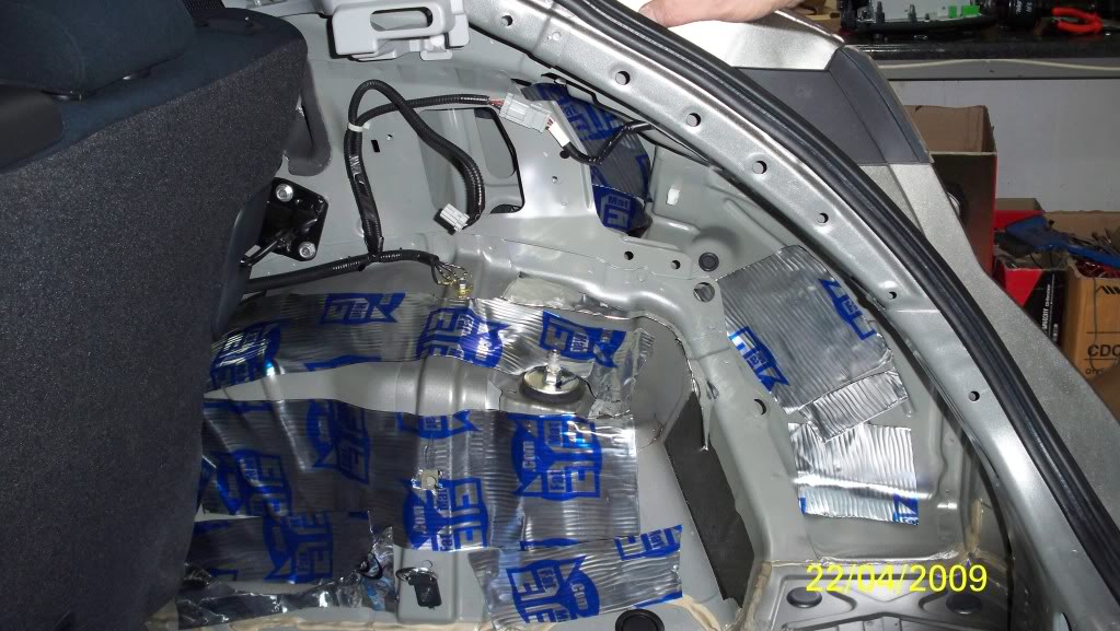

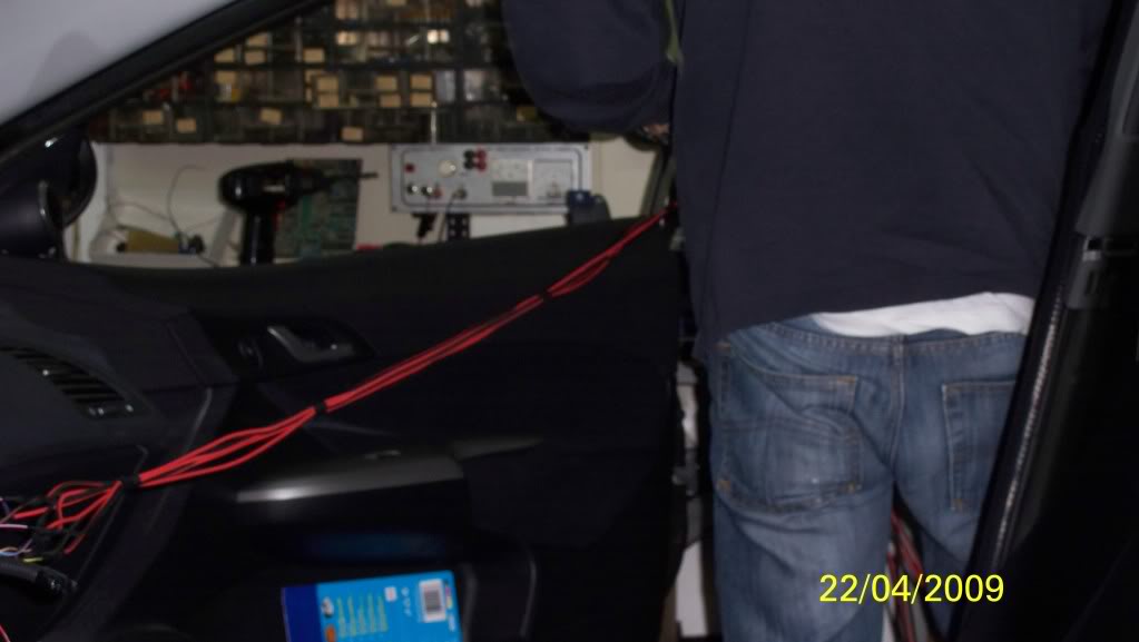

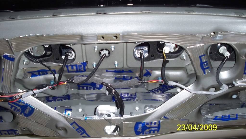

την 2η μερα περασαμε στο πισω μερος για την τοποθετηση της καμερας.πηρε ρευμα απο την οπισθεν και πλεον εχω ματια και πισω....
για την τοποθετηση απογυμνωθηκε ολη η 4η πορτα και μονωθηκαν καποια κομματια...
δειτε πως ηταν πριν και μετα....

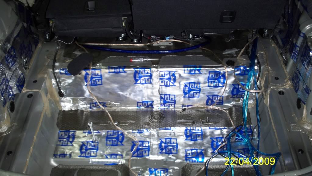

και αφου υπηρχε περισσευμα "την επεσα" στο χωρο αποσκευων......
για να μπει η καμερα βγηκαν για λιγο ολα τα πισω φωτα,και να'τη τοποθετημενη.....

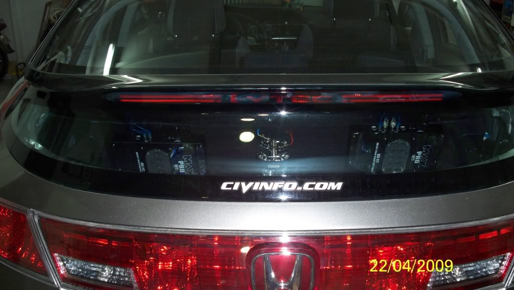

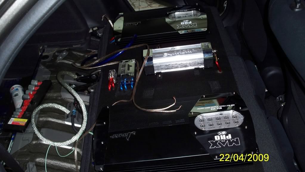

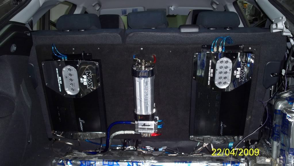

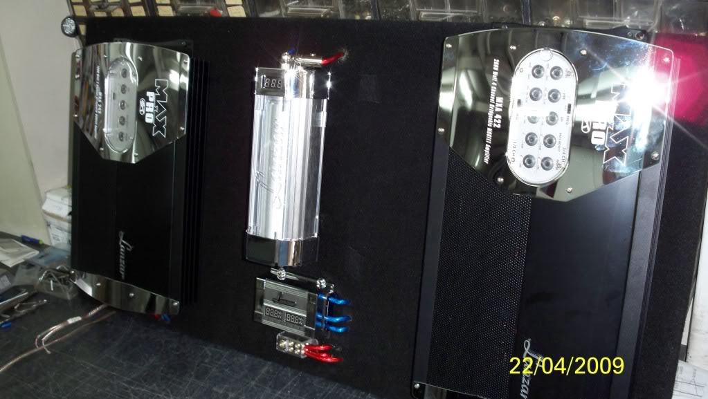

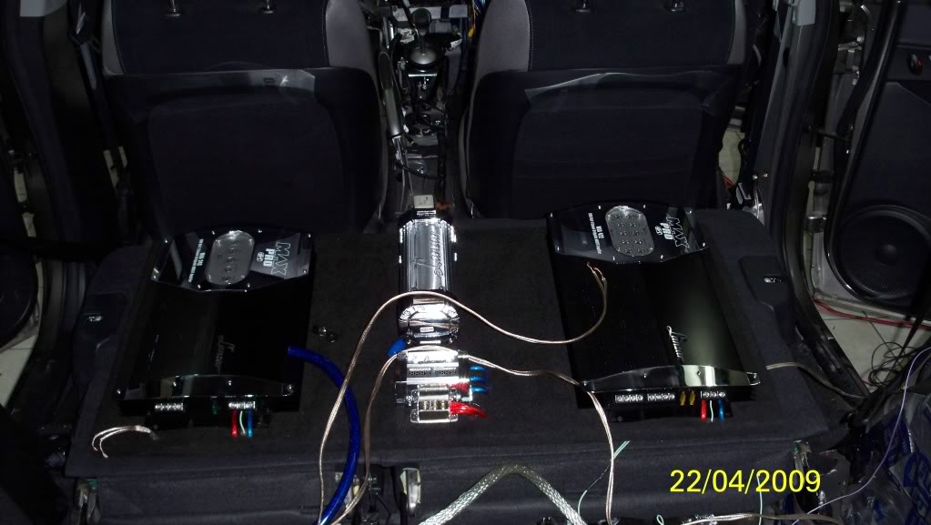

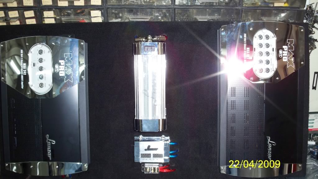

At the same time another Honda fan who works in the shop,jumped on the amps....
Along with the capacitor,the fuse block and a grounding unit, were mounted on a wooden board 1m x 0.5m and then mounted on the back of the rear seats....
no more 60/40 for me....
here is my shining sound armor....

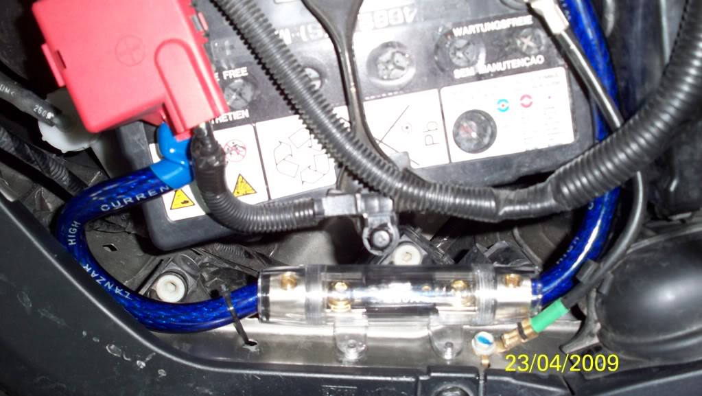

take a look at the 0 AWG power cable trying to get through to the engine bay,and the 150A fuse box...

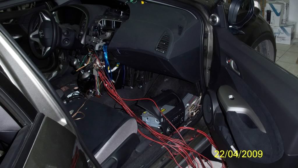

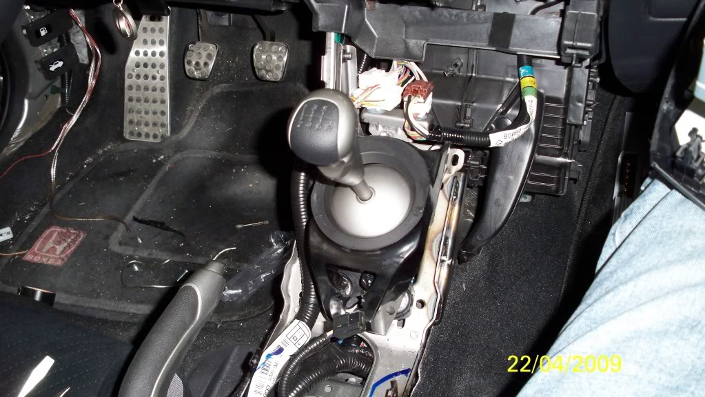

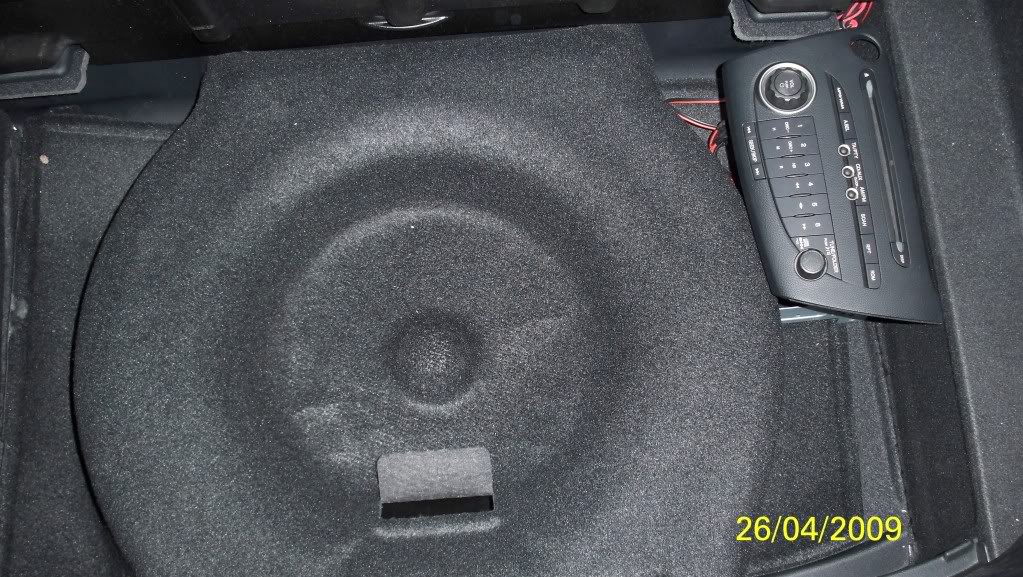

the 3rd day,it was Pioneer day.....
the mayhem that is created when the H.U. is removed is well known...
after preparing the "cable spaghetti" that would connect the new with the old one,it was "lobotomized" :138: and now rests in peace with the spare tire...
