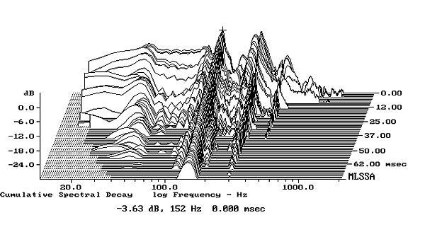

A wrinkle in the impedance-magnitude trace at 150Hz suggests a cabinet resonance of some kind at this frequency. Indeed, investigating the enclosure panels' vibrational behavior with a simple plastic-tape accelerometer (footnote 1) while it was supported on three upturned cones revealed a strong resonance at 152Hz on all surfaces. Fig.2 was taken with the accelerometer at the center of the top panel; this resonance is indicated with the cursor, and there are two more resonant modes an octave higher, at 300Hz. However, while there also some higher-frequency modes on the side and rear panels, these were at different frequencies. This suggests that the idea of using a thin-walled cabinet to maximize the quality of a speaker's midrange reproduction —proposed by, among others, Harbeth founder Dudley Harwood when he worked at the BBC in the early 1970s—does work as promised. However, I do wonder if the mode at 150Hz contributed to Art Dudley's feeling that the HL5plus had a "warm tone."
image: https://www.stereophile.com/images/615HLS5fig2.jpg
Read more at https://www.stereophile.com/content...-loudspeaker-measurements#tZ4Pxe2JBmdO1hPg.99
Και το συμπερασμα των μετρησεων;
"Other than that lively enclosure, which is a deliberate design decision—note AD's comment about "the consistently truthful, present manner with which they reproduce singing voices"—the Harbeth Super HL5plus's measured performance is beyond reproach.John Atkinson
Μαλλον ουτε ο J.A. δεν μπορει (ξερει) να βγαζει τεχνικα συμπερασματα...
