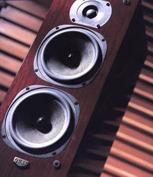

The 22L is the top of the line, featuring three drivers in a ported compact tower cabinet, a 6 1/2″ bass unit, an identical looking bass/midrange driver, and a 1 1/2″ soft dome tweeter. Crossover points are specified at 150 and 3 kHz. The enclosures are bi-wired, with high quality gold plated binding posts that accept spades or bananas, and come with substantial gold plated rods between them (for those who do not bi-wire), and those pesky little plastic plugs in the banana holes, thanks to IEC paranoia. Power handling is specified at 300 watts max, and nominal impedance 6 ohms, with sensitivity at 89 dB.
The cabinets are beautifully finished, and the Quad web site describes the process: The lustrous piano finish is applied to each speaker by hand over a period of seven days, each of which involves a coating of lacquer which must then dry at an ambient temperature before being cut and polished. The final coat is polished to a high gloss finish to produce one of the finest finishes seen on any loudspeaker in this class.”
“The 22L is the flagship of the range. This tall, floorstanding model with ultra low distortion twin KEVLAR drivers produces a fast, dynamic bass, extending to around 30 Hz at the lower end for real impact and a compelling sense of scale. Bass detail is excellent, tracking precisely every nuance of the deepest double bass, while maintaining an area of open space around instruments.” The cabinet is rear ported just above the binding posts at bottom.
“The tweeter fascia plate is engineered for a smooth frequency response and excellent dispersion. This is further aided by the flush mountings of this plate and the bass/mid unit into the cabinet front baffle.” “A profiled phase plug provides additional cone axial rigidity and also improves off-axis performance.”
”Phase coherency is particularly important to ensure the bass integrates perfectly with the treble, and, of course, to create a truly holographic stereo image - the hallmark of a classic Quad sound. This tweeter is so controlled; [that] it measures typically less than 1% distortion from 103dB (equivalent to normally loud playback) output at a distance of 1 metre.”

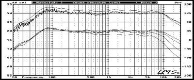

All that revealed (and claimed), it seems a good time get to the measurements, which are, in a word, spectacular. Virtually a straight line from 200 to 10,000 Hz, frequency response rolls off gently above and below after a very mild hump from about 190 down to 70 Hz. From there down, it slopes smoothly, down 2 dB at 50, and 5 dB (relative to 1 kHz) at 30, with appreciable response at 20 Hz. Up top, we see a smooth rolloff above 10 kHz, off 4 dB at 15, and 10 dB at 20 kHz. A little bit of character is offered in a 2 dB treble rise between 5 and 8 kHz on axis, but this smooths at 15 degrees and a controlled rolloff occurs beyond 30 degrees off axis. You might say that this is a very British speaker in its sound, with only that slight hint of upper class assertiveness, and a bit of public school mellowness of voice….rawther like the announcers (or programme presenters) on the Beeb’s Third Program. Ahem.
Impedance varies somewhat more than frequency response, reaching 5 ohms on either side of the single bass peak at about 17 ohms, and jumping to 19 ohms at 1.5 kHz. It dips to 4 1/2 ohms at high frequencies, suggesting a stable amplifier be utilized (”no singleended valves, please, Charles”). The phase angle through crossover, seen below impedance, goes from +20 to about -47 degrees, a little more than one might like in a speaker otherwise this excellent, but let’s move to its effect on imaging, as we turn to the listening tests.
