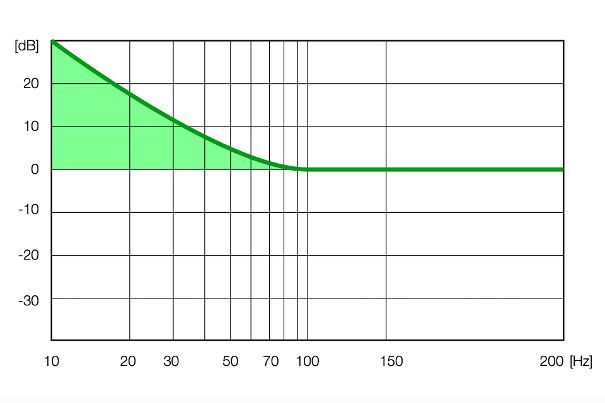

A measurement in the near field of the bass driver and a subsequent measurement in the room shows this effect very nicely. In this context, it is important to distinguish between the room gain and the room modes. The effect of room modes is narrow-band and appears as narrow peaks or dips in the frequency chart. The room gain is a gentle, even increase towards low frequencies.
Room gain in a medium-sized room. The green area shows the sound pressure “gain” through the room.

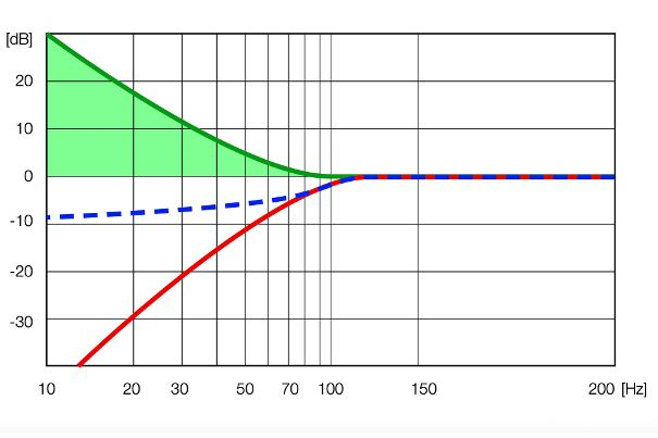

The graphic now shows the level curve (red) of a loudspeaker X (in an anechoic chamber). The dashed curve (blue) shows the overall curve of the loudspeaker in the room. In this fictitious example, the curve is slightly falling.
The same graph with a steeper rolloff of a speaker Y produces a much less deep bass.
