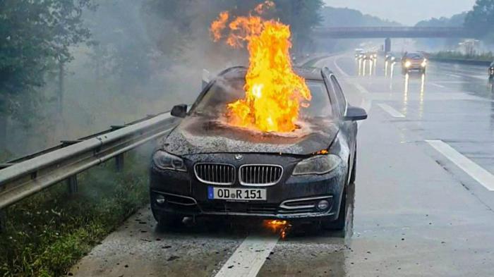

Δεν είναι και τόσο καινούργιο θέμα, ενώ η BMW ως συνήθως, έκανε τη πάπια για καιρό.
Tελικά, είναι τα κάτωθι:
  • BMW 1 Series (114d, 116d, 118d, 120d, 125d), manufactured between November 2011 and September 2017.
  • BMW 2 Series Coupe and Convertibles (218d, 220d, 225d), manufactured between July 2013 and December 2017.
  • BMW 3 Series Saloon, Touring and Gran Turismo (316d, 318d, 320d, 320ed, 325d, 330d, 335d), manufactured between December 2011 and November 2017.
  • BMW 4 Series Coupe, Convertible and Gran Coupe (418d, 420d, 425d, 430d, 435d), manufactured between May 2013 to July 2017.
  • BMW 5 Series Saloon, Touring and Gran Turismo (518d, 520d, 525d, 530d, 535d), manufactured between March 2011 and December 2017.
  • BMW 6 Series Coupe, Convertible and Gran Coupe (640d), manufactured between March 2011 and April 2015.
  • BMW 7 Series Saloon and LWB (725d, 730d, 740d), manufactured between January 2012 and April 2015.
  • BMW X1 (s20d, x25d), manufactured between May 2011 and April 2015.
  • BMW X3 (18d, 20d, 30d, 35d), manufactured between August 2010 and October 2017.
  • BMW X4 (20d, 30d, 35d), manufactured between December 2013 and June 2017.
  • BMW X5 (25d, 30d, 40d), manufactured between April 2013 and June 2017.
  • BMW X6 (30d, 40d), manufactured between March 2014 and June 2015.
The DVSA’s head of vehicle engineering, Neil Barlow, told Which?: “Our engineers have worked closely with BMW to ensure that the fix is satisfactory and appropriate for UK models and conditions.
“We continue to ensure BMW contacts owners of affected vehicles so their cars can be assessed and made safe.”
To find out if your vehicle has been affected by a recall, use the Driver and Vehicle Standards Agency (DVSA) website.
43.728
79.275
Οι B47/Β57 (απο το '14) δεν έχουν θέμα.
Οι N47/N57 το είχαν.
As the cars equipped with this engine are coming of age, some hoses in the engine bay can start to break down. This is not to be ignored, even though this does not illuminate the CEL, it just sets a code in the ECU. If the vacuum hose supplying the EGR cooler bypass valve gets a hole rubbed in it, or breaks down from old age and oil spray, the EGR cooler won't get bypassed during the engine warmup period. This causes excessive buildup in the cooler matrix, and when the engine warms up these solid chunks of buildup can detach from the EGR cooler and get sucked into the plastic intake tube, melting holes in the intake tube, causing a massive boost leak and in very rare cases an engine fire.

Εγώ πήγα και μου το άλλαξαν αλλά χρειάστηκε να φάω 2 μέρες από τη ζωή μου.
Την πρώτη έπρεπε να πάω για να ελέγξουν με μικροκάμερα αν όντως έχει παρουσιάσει πρόβλημα και μόνο αν έβλεπαν πρόβλημα θα το άλλαζαν (αφού έκαναν παραγγελία το ανταλλακτικό, οπότε δεν γινόταν να το κάνουν την ίδια μέρα).
Δηλαδή έπρεπε να ταλαιπωρηθώ εγώ για να μην μπει η BMW σε παραπάνω έξοδα και αλλάξει προληπτικά και κάποιο που δεν έχει παρουσιάσει μέχρι στιγμής πρόβλημα. Λες και αποκλείεται να παρουσιάσει αργότερα, εφόσον ήδη ξέρουν ότι πρόκειται για προβληματικό εξάρτημα!
Για να μην πω ότι το πλασάρουν ως "καμπάνια" (δεν το λένε ανάκληση) και δεν το είχαν ανακοινώσει στα μέσα, τυχαία το έμαθα.
Το μόνο θετικό ότι μαζί με το ψυγείο αλλάζουν και τη βαλβίδα AGR η οποία μου είχε χαλάσει ΞΑΝΑ, μέσα σε 6-7 μήνες από όταν την είχα αλλάξει και πάλι. Αν με ξαναπιάσουν πελάτη σφυρίξτε μου... >:(
Είσαι 100% σίγουρος; Γιατί εμένα είναι B47 και όπως είπα μου το άλλαξαν, αφού πρώτα επιβεβαίωσαν πως είχε πρόβλημα.
