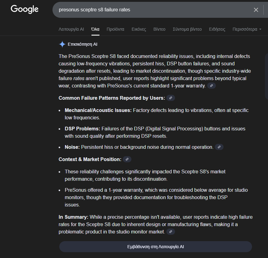

Πήρα απάντηση από την presonus.
Hi Thodoros,
Internal components are generally available for as long as the speaker is produced. Once the speaker is discontinued, parts are no longer produced and stock will vary for an indeterminate period of time until it has been used.
και ο Θεός βοηθός.....
