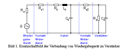

RCA Cables
RCA cables are so named because they are equipped at both ends with RCA connectors (sometimes misspelled as "Cynch"). This connector type is a standard in consumer hi-fi electronics, and deviations from it are extremely rare these days. While your playback device and amplifier are equipped with RCA jacks, the connecting cables have RCA plugs at both ends. Each transmission channel consists of a single-core cable with a braided shield that also serves as the ground wire. For stereo applications, two single-core cables are often combined to form a two-core cable, which is usually a twin-core cable where the two individually shielded conductors lie side by side. To determine the theoretical influence such an RCA cable can have on the sound, let's start with the output of the playback device, for example, the CD player.
``` This delivers a voltage of roughly one volt (shown as generator G in Figure 1) and, in well-designed devices, has an output resistance Ra of less than 100 ohms, while in poorly designed devices it can reach up to 5 kΩ. The voltage is carried to the socket via circuit traces or an internal cable. At the transition from socket to plug, a contact resistance Rs1 can be detected, which, even in lower-quality plugs, is only a few milliohms (thousandths of an ohm). Therefore, solid plugs, especially those with gold plating, are pointless. Furthermore, gold contacts are less suitable for this application than a layperson might assume, given the precious metal: Electrically equivalent contact can be achieved with tinned or nickel-plated surfaces, which are also significantly cheaper for the end customer (the difference in manufacturing costs is minimal anyway)! Gold-plated connectors have the advantage of not corroding and therefore functioning reliably for many years, provided they are not exposed to grease (e.g., from cooking fumes), which tends to seep between the contact surfaces over time and increase contact resistance, potentially leading to a complete break in the connection. Tinned or nickel-plated connectors, on the other hand, may require disconnecting and reconnecting every few years due to the oxide layers that form, in order to restore the low contact resistance.
The cable itself has a very low ohmic resistance (Rk), a noteworthy capacitance (Ck), and an extremely low inductance (Lk). At the other end, the connection between the plug and the amplifier socket is made, with a contact resistance (Rs2). The amplifier, in turn, has an input resistance (Re) and an input capacitance (Ce). The equivalent circuit diagram for the entire path is therefore as follows:
The resistors Ra, Rs1, and Rk, connected in series, can be combined into a single resistor, which we will call Ra'. Resistor Rs2 forms a voltage divider with the input resistor Re. Because the value of Re is typically around 100 kΩ or more, while Rs2, at a maximum of 100 mΩ, is at least a million times smaller, the static voltage attenuation, which is not noticeable in the sound but only in a reduced volume, is so small that it can only be measured with great difficulty and is certainly inaudible. It amounts to less than 0.0001% or -0.000009 dB. Therefore, Rs2 can be considered negligible. Ck, Re, and Ce are connected in parallel, so capacitors Ck and Ce can be combined into a single capacitor, which we will call Ce'. Lk, together with this Ce' (i.e., Ck and Ce), essentially forms a low-pass filter. The value of Lk is extremely small, at a few billionths of a henry, while Ck is a maximum of 200 pF for a cable length of one meter, and the typical value of Ce is unlikely to exceed 100 pF. This results in a maximum value of approximately 300 pF for Ce'. Assuming a comparatively large value of 250 nH for Lk, the resulting cutoff frequency is over 18 MHz (18,000,000 Hz), at the upper end of the shortwave range. This is so far above the audible range and also above the range that the amplifier can process that this inductance can simply be neglected. Strictly speaking, Lk also forms a low-pass filter with the input impedance Re. However, its cutoff frequency of 63 GHz (63,000,000,000 Hz) is so high that such frequencies can only be generated with great difficulty using current technology (extremely shortwave radar devices operate in this range). This results in the following slightly simplified equivalent circuit diagram. Please note that the simplification mainly concerns the mathematical aggregation of multiple resistors and capacitors. Only components that are certain to have no effect on the sound have been omitted.
As anyone with electrical engineering knowledge can easily see, this is a combination of a voltage divider (Re and Ra') and a low-pass filter (Ra' and Ce'). The voltage divider is completely irrelevant from a sonic perspective, as it only slightly reduces the volume (a volume control works no differently). With a value of 5 kΩ for Ra' (which is exceptionally high and unfavorable; practical values are more like 100 Ω) and 100 kΩ for Re, the attenuation is only about 0.5 dB. However, the low-pass filter could certainly influence the sound. For a so-called RC low-pass filter, the cutoff frequency f0, at which there is already an attenuation of 3 dB, is calculated using the following formula:
With the values assumed above (Ce' = 300 pF, Ra' = 5 kΩ), the cutoff frequency is over 100 kHz. Since this is still five times higher than the audible range, any audible effect is negligible. With a more realistic Ra' (100 Ω), the cutoff frequency is even 5.3 MHz, far beyond acceptable limits. To force an audible effect, one would have to resort to drastic measures: Take a completely idiotic output stage with an output impedance of 10 kΩ and run the signal to the amplifier via a 5 m long cable. Since we assumed an extremely poor cable with 200 pF per meter, the cable capacitance alone is a considerable 1000 pF; an unrealistic value. Add to that the amplifier's input capacitance of 100 pF, resulting in a Ce' value of 1100 pF. With these far-fetched values, we finally arrive at a frequency of approximately 14.5 kHz, at which some individuals might perceive a slight sonic impact. However, many people will not notice any degradation in sound even under these conditions because, firstly, the level at 14.5 kHz has only dropped by 3 dB, and secondly, the highest audible frequency for many people is already below this value.
As you have seen, several extremely unfavorable factors have to coincide for the connecting cable between the playback device and the amplifier to have any sonic effect. And very importantly: this only results in a high-frequency roll-off similar to what you can achieve with the treble control found on most amplifiers. We are not talking about a degradation of sound in the sense that the music has less depth, sounds less full, has less dynamic range, suffers from poor imaging, sounds unmusical, sounds impure, or any of the other things that are often claimed! In extreme cases, we're talking solely about slightly attenuated high frequencies, nothing more. A cable simply can't do more than that in reality.
With the 10 kΩ output impedance mentioned in the example, it would objectively be advisable to discreetly dispose of the faulty device anyway. And instead of the long, cheap cable factored into the calculation, which probably doesn't even exist in practice (not even in the €0.50 range), one could simply use the cable that's usually included or buy a very inexpensive RCA cable from an electronics store that would solve the problem before considering a high-end RCA cable costing several hundred euros, which can't solve a single problem that a very inexpensive cable can't also solve. Surprisingly, it's not uncommon to find so-called high-end devices with quite high output impedance. The justification often given is that this allowed them to omit an impedance converter at the output, which could supposedly affect the sound. A ludicrous argument! In this case, you need a low-capacitance cable, meaning one that is as short as possible, or, if the cable length must be long, one with low capacitance per meter. If you have the option, it's best to make it yourself as described in the next section.
Tip: If you're going to this unnecessary trouble to ease your conscience (even though you now know it's pointless), or if you need a low-capacitance cable due to a long run, then you should buy some RCA connectors and RG-59 coaxial cable from an electronics store. RG-59 is designed for RF applications and is characterized by low capacitance and, most importantly, a braided, and therefore dense, shield. It has an outer diameter of approximately 4 mm. Other 75-ohm coaxial cables have similarly good properties. If you're skilled at soldering, you can make an RCA cable from these components that, from an electrical engineering perspective, can't be improved upon for this application. A cinch cable manufactured in this way has only one disadvantage, which is, however, very serious in high-end circles: As a stereo cable, it costs well under 5 euros, and this low price alone disqualifies it from high-end applications. The only objectively real disadvantage is that the cable is quite stiff and doesn't tolerate small bending radii. The RG-179 performs significantly better in this regard, despite having virtually identical electrical specifications. However, due to its small outer diameter of 2.5 mm, which completely lacks any rugged appearance, it will only be met with ridicule in hi-fi circles.
Finally, a note: The cable's capacitance behaves exactly like a normal capacitor. Accordingly, its value can be easily measured with a capacitance meter. Even inexpensive digital multimeters often have a capacitance meter.

Ποσα χρονια ειναι γραμμενο αυτο το αρθρο ?
Οποτε σου απανταω
Συμφωνα με αυτα που γραφει αυτος, τα ηλεκτρικα χαρακτηριστικα του καλωδιου Αντισταση χωρητικοτητα αυτεπαγωγη και θωρακιση τελικα δεν παιζουν κανενα ρολο στην ακροαση
εκτος βεβαια αν το καλωδιο που εχεις ειναι τοσο μαπα που εχει ενα απο αυτα τα προβληματα στον υπερθετικο βαθμο .
Σωστα μεχρι εδω ?
Συμφωνα με αυτο που λες εκατομμυρια ακροατες που συζητανε, εντοπιζουν και καταλαβαινουν διαφορες στα καλωδια ειναι μαλακες , ειναι πρεζονια , placebo , δεν ξερουν τι τους γινεται και παραλληλα η εταιριες που πουλανε καλωδια και 2 και 3 χιλαδες για ενα RCA ειναι ασχετοι ηλιθιοι και απατεωνες
Το αρθρο παραβλεπει πραγματα τα οποια μολις προσφατα ασχοληθηκε φυσικη να ανακaλυψει με ερισμα αυτο που λενε οι ακροατες
Οι ακροατες εχουν δικιο να λενα οτι ακουνε διαφορες Η φυσικη ανελαβε να εξηγησει το ΓΙΑΤΙ .
