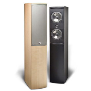

Λοιπον,
PSB Alpha T1 Tower
Frequency Range On Axis @ 0° ±1.5dB 55–21,000 Hz
Off Axis @ 30° ±1.5dB 55–10,000 Hz Lf Cutoff -10dB 45 Hz
Sensitivity
1w (2.83V) @ 1m, IEC-filtered Pink Noise, C-weighted
Anechoic Chamber 89 dB
Typical Listening Room 91 dB
Impedence
Nominal 8 Ohms
Minimum 6 Ohms
Input Power
RMS, Clipping < 10% of the Time
Recommended 15–120 Watts
Program 60 Watts
Acoustic Design
Tweeter (Nominal) 3/4″ (19 mm)
Aluminum Dome with Ferrofluid
Woofer (Nominal) 2 x 5 1/4″ (130 mm)
Metalized Polypropylene Cone
Damped Rubber Surround
Crossover 3,300 Hz, B3
Internal Volume Design Type 1.19 cu ft (33.4 litres)
Bass Reflex
2 3/4″ (70 mm) Rear Port
Video Shielded
Size (W x H x D)
Millimeters 179 x 907 x 300 mm
Inches 7 1/16 x 35 3/4 x 11 13/16″
Net Weight
Kilograms 13.2 kg/each
Pounds 29 lb/each
Shipping Weight
Kilograms 15.9 kg/each
Pounds 35.0 lb/each
Finish
Black Ash, Maple or Sienna
Features
Dual, 5-Way Gold-plated Binding Posts
Aluminum Grille
Adjustable Spikes and Rubber Levelers
