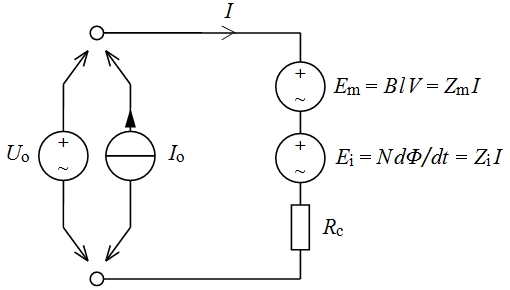

χμμμ...λίγο άσχετο, αλλά έχει ενδιαφέρον...
The delusion of "damping factor" ;)
According to a rampant myth, a high "damping factor" (ratio of nominal load impedance to amplifier output impedance) is needed to deal with the back-EMF, to prevent who knows what errors from happening in the amplifier or the feedback loop, and of course, to control cone motion. (The quotation marks have been used because it is an artificial metric created for marketing purposes and not deriving from any relevant operational equations.) It is not recognized that the Rc is already there, often about 6 Ω, so making any minor increments or decrements to its value doesn't determine anything.
There are also not any distortion mechanisms involved in Rc, and adding a bit more linear resistance to the circuit does not alter the distortion scheme either. The amplifier always sees the motional EMF as nothing else than an additional (complex-valued) impedance (Zm) that appears on top of the DC resistance. From the amplifier's standpoint, dealing with this peaking in impedance does not differ in any way from dealing with any other peaks that there may occur along the impedance curve.
Even normal temperature variations in the voice coil make empty any efforts to gain any benefit from a high DF. As the temperature coefficient of copper resistance is 0.4%/°C, resistance increases of roughly 50% are possible within rated operation. Thus, even if there would be an infinite DF determined for a room temperature speaker, on continued high-level passages there can be some 3 Ω of additional resistance, which drops the effective DF down to 8/3 = 2.7. Not something to tout.
http://www.edn.com/design/consumer/...periority-of-current-drive-over-voltage-drive
http://www.current-drive.info/
The Serious Flaws of Voltage Drive:
http://www.current-drive.info/6
