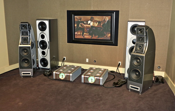

Να βάλουμε και κανένα εξωτερικό λινκ, όχι πως δεν έχουν γραφεί όλα εδώ, αλλά έτσι, για ποικιλία. Άσε που έχει και ωραίες φωτογραφίες για χαλβάδιασμα ;-)
Δεν του βάζω ποινή που τα έχει στο πάτωμα: α) γιατί πρέπει να είναι λιγάκι βαριά να τα σηκώσει: και β) γιατί τα έχει τοποθετήσει σωστά στο L/4.
"You cannot achieve a good outcome if you do not physically optimize the placement of the main speakers in the room first. We carefully positioned, leveled, and spiked the main, speakers maximizing their performance without a woofer prior to beginning our efforts couple them with our woofers. When we initially setup our dual JL Audio F113 woofers, we connected both to the same LFE output on Anthem AVM-60. The woofers were physically separated, one close to the left main speaker, the other close to the right main speaker, hidden behind the screen. Then, Dan McMillan, our local JL rep, recommended using the 2nd LFE output on the Anthem AVM-60 to run a separate cable to each woofer, pairing one woofer with each main speaker. To get them acoustically time-aligned, we fed an 80Hz test tone into an unused analog input on the Anthem AVM-60. We then inverted absolute phase of the left main speaker (plus becomes minus, minus becomes plus) and adjusted the phase control on the left woofer to the point with the least output. To do this you place your head equal distance between the woofers driver and the main speakers bass drivers. You rotate the phase control back and forth quickly at first to hear the full extent of the difference, and then move slowly to find the center point of the lowest output. When complete, correct the left main speaker's wiring and repeat the process on the right channel.
Getting the woofers and main left/right channel speakers rhythmically aligned made a big improvement. Then we attacked the high-pass and low-pass crossover points. We listened to all options in 10Hz increments between 40Hz and 100Hz, and landed on 80Hz because it worked best in our installation."
Read more at https://www.stereophile.com/content/superb-sound-definitives-music-matters-14#pUjDpudj1GzyTQoi.99"

Αυτό που ξεσηκώνει στο setup με Wilson & Dan D'Agostino,είναι ότι το λ4 λ4 αλλά και η καλωδιοσαγιονάρα (Transparent) καλωδιοσαγιονάρα.:gotcha:
χεχεχε, παίρνω τα γκριμμ και 6 σαμπς και τα ρέστα εκδρομή, Λάγκο Ματζόρε, Λίμνες Αυστρίας και στην επιστροφή Βενετία
περισσεύουν και για ένα τουτού για την παντόφλα!!
Είναι νωρίς ακόμη για να βλέπεις...Όνειρο Θερινής Νυκτός.:p
