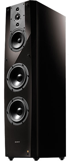

Ωπ.....για δες.... μεγαλες εταιριες μαλλον το θεωρουν σημαντικο....
The biggest external difference concerns the tweeter. Or tweeters. The 'AR2 had a conventional if high-quality, 1" silk-dome tweeter with a motor that featured a circular array of six neodymium magnets that left the rear of its diaphragm unobstructed. The 'NA2ES also uses a 1" silk-dome tweeter sourced from Scan-Speak, but mounts it vertically between two 0.75" fabric-dome "assist" tweeters. All three tweeters share the same faceplate and cover the same frequency range. I asked Sony's designer, Yoshiyuki Kaku, what he was trying to achieve with this three-tweeter array, which Sony calls the I-Array.
Mr. Kaku explained that he'd been listening to a Sony "lifestyle" speaker, the Sountina, that had been developed by another group within the company. The Sountina had an unusual cylindrical tweeter with a 360° radiation pattern. Though the Sountina was not a "hi-fi" design, the sound of its tweeter was remarkably lifelike, and very different from that offered by normal directional dome tweeters. That experience set Kaku thinking about how he might get the same result from a conventional speaker, to widen its radiation pattern at high frequencies to better match that in the midrange and bass. The target was therefore to design a tweeter with a directivity similar to that of the midrange driver and woofers. Simply making the tweeter's dome smaller would increase the top-octave dispersion but compromise power handling. The solution turned out to be a vertical array of a single 1" tweeter flanked by two smaller-diameter tweeters, these having wider dispersion above 10kHz but slightly lower sensitivity. The benefit would be more top-octave energy in-room without affecting the flatness of the on-axis response.

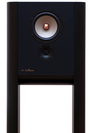

http://www.grimmaudio.com/site/assets/files/1088/speakers.pdf
Regardless of the room, speakers give themselves away by having a response significantly deviating from flat or by producing excessive amounts of non-linear distortion. A speaker that is good on these two counts already sounds great in an anechoic room. Placed in a real room a speaker betrays its presence by its off-axis radiation. Too wide dispersion causes the “omnidirectional brass section” effect while strongly frequency-dependent dispersion makes the direct/indirect balance frequency dependent as well.
The LS1 is designed as a transportable compact system. Dipole or cardioid cabinets are therefore out of the question. Accepting that the LS1 will be omnidirectional at low frequencies, we can not make high-frequency directivity too strong. What we can do is decide where to put the baffle-step frequency. Psychoacoustics tells us that below about 300Hz the ear will no longer clearly discern direct sound, first reflections or reverberant sound. Pre- sumably the evolutionary background of this is that the vocal range starts here. Anyhow, we can live with a transition to omni below 300Hz. If we can get reasonable, constant directivity above that, we have a design spec!

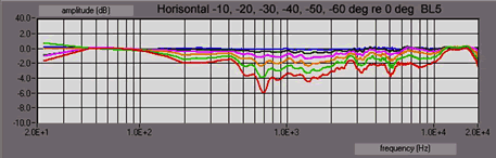

Quiz: Επειδή το συγκεκριμένο ηχείο είναι πολύ διαφορετικό από τα συνηθισμένα:
(Horizontal dispersion beolab 5)
και επειδή έχει περιορισμένη διασπορά στο κατακόρυφο επίπεδο, τι room treatment χρειάζεται στις μεσο-υψηλές και σε ποιά σημεία;

Απάντηση: Απορρόφηση στα σημεία ανάκλασης από τους πλαινούς τοίχους (και όχι διάχυση). Τίποτα στο πάτωμα και οροφή.

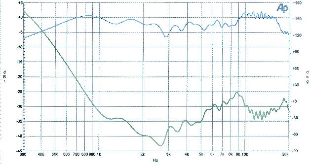

Fig. 1: Frequency response (blue) and phase response (green) 2 meters on axis.

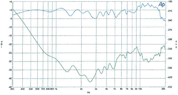

Fig. 2: Frequency response (blue) and phase response (green) 2 meters off axis (approx. 45 degrees).
9.110
8.905
The most obvious difference between the measured response of the BeoLab 5 and that of any other speaker is the complete absence of high-frequency rolloff at any angle off axis horizontally. Compare Fig. 1 and Fig. 2. Those are my quasi-anechoic (MLS) curves from 300 Hz up, taken at 2 meters on axis and approximately 45° off axis, respectively. There is virtually no difference between the two curves, all the way up to the highest frequencies. Fig. 2 could actually have been taken at 85° off axis with little or no effect on the response—the speaker just doesn’t care! That’s unique to the Acoustic Lens Technology. There is, however, something slightly disturbing about the curves. They ought to be quite flat but show instead a shallow S-shaped bend, dipping in the upper midrange and peaking in the treble range. That vaguely S-shaped profile is evident at all output levels and no matter how close or far the measurement microphone is placed. It appears to be the signature of the BeoLab 5. I asked the design engineer at Bang & Olufsen whether this was deliberate “formatting,” perhaps based on listening-test preferences. He vehemently denied that and sent me B&O’s own frequency-response curves to prove that the speaker is flat. The funny thing is that the B&O curves also suggest the S-shaped profile in amplitude response but, on the other hand, indicate dead-flat power response above 1 kHz. Now, I don’t have the technology (or the patience) to do the large-scale reiterative solid-angle averaging required to derive an accurate power response, so I’ll have to give B&O the benefit of the doubt. I’m wondering, however, why the BeoLab 5 can’t have flat amplitude response—at least on axis and at moderate angles off axis—like some of the other top-notch speakers out there that also have excellent power response.
As far as vertical dispersion is concerned, it is severely limited by the three circular disks that constitute the tops and bottoms of the acoustic lenses. This is not just a byproduct of the design but an essential part of the design philosophy. B&O believes in preventing floor and ceiling reflections, in preference to the arguable sonic benefits of greater vertical dispersion. More about that below.

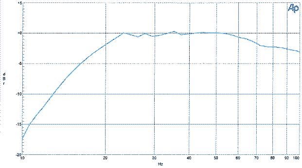

The nearfield low-frequency response of the speaker, before any adaptive in-room correction, is shown in Fig. 3. It is as good as it gets, flat down to an f3 of 18 Hz with only ½ dB ripples. That 15" subwoofer and its 1000-watt ICEpower amplifier are state-of-the-art. Distortion of a 40 Hz tone at a 1-meter SPL of 95 dB is shown as an FFT spectrum in Fig. 4. That’s a very loud level for such a low frequency—as loud as I’m willing to tolerate in my laboratory when I do my measurements—and the numbers are very good. The –41 dB second harmonic translates to 0.89%, the –48 dB third harmonic to 0.4%, the –60 dB fourth harmonic to 0.1%. You can’t get much lower than that, and even if you could the difference would be inaudible. I did not take any other distortion measurements because at higher frequencies the distortion is inevitably lower, typically approaching zero in the top three octaves of the audio band. This is clearly a very low-distortion loudspeaker.
Fig. 3: Nearfield small-signal response of woofer (adaptive bass-control calibration set to “neutral”).

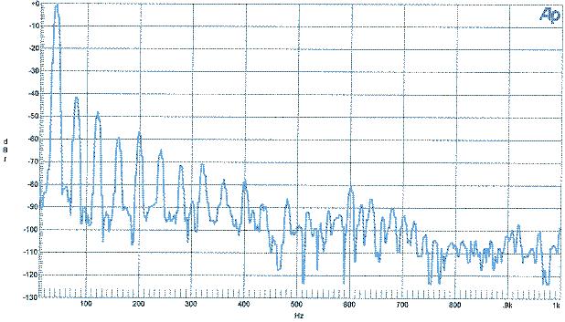

Fig. 4: Nearfield spectrum of a 40 Hz tone at a 1-meter SPL of 95 dB.
