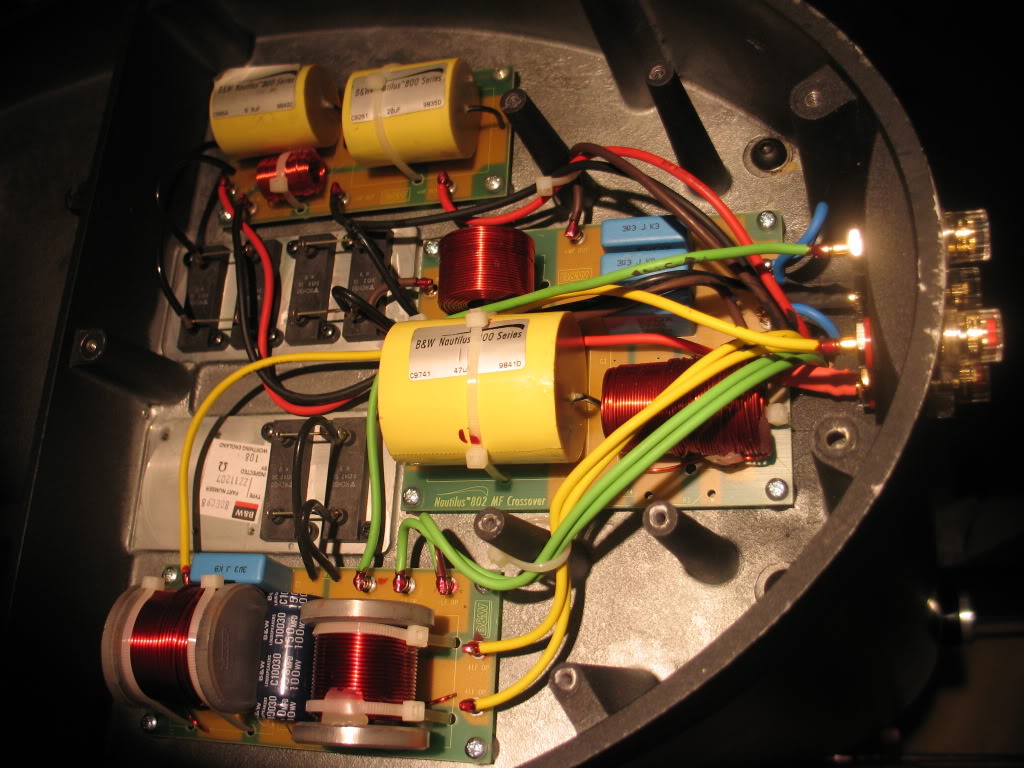

Hello from Holland everyone!
First of all I thank Vlasis for initiating this discussion and for the pictures.
Also, many thanks to Kostas Papas for sharing the links to crossover schematics.
To give to this discussion my 2 cents in return, here comes my tip and feedback to Vlasis.
I was searching the web for long time to find those and you guys are great! I have won few auctions of some B&W drivers and enclosures on Ebay (usa, uk and germany). Now I am able to build by myself a DIY Nautilus with a pair of N803S tweeters, a pair of N800 Signature Midds with Marlan enclosures and N802 basses. Last 2 weeks were a pair of N800 drivers on the UK site of ebay but the seller just refused to sell to anyone outside of UK. The both drivers were finally sold in UK for only 65,- (20times cheaper new price).
From the N802 crossover design I'll use only the midd crossover section as for the tweeter I'll go for a single 4,7 mF Mundorf Supreme as a filter ( cut-off F= 4229Hz to above), just as in the S and D series. This because my S version tweeters have the same suspension as the D version, so a 1st order filter is the best. The less components, the better, in this case. Your N802 tweeter can do much better in my opinion if you change the all tweeter crossover with just a capacitor of 5mF (cut-off f = 3975Hz to above).
At this crossover N802 design of the tweeter, I see this inductor of 0,077mH has a cut-off F = 16500Hz and below. This is going to the min. I am not an expert, but with other words it seems that you get not much above this frequency as signal in your tweeter! Is this not strange? What if this is true, could it be that B&W make its own technical restrictions in order to protect the performance of the more expensive models?
I understood Vlasis wanted some more transparency and brightness in the middle area and tweeter frequencies. I am wondering if those 400 euro's are worth for what you got in return? Let me share with you a very simple way to gain great details in High area (and Middle area, too, if you want).
This method will do for most of the speakers build with crossover where a resistor or more are serial mounted. On your B&W N802 both Mid and HI have 2 resistors in parallel, each of 3,3 Ohm. Those from the entrance of the crossover are just simple attenuators. They do nothing but flat out (or cut out) the level of the signal.
Keep in mind that cca 2-3dB less means you hear almost twice as little, 6 dB 4 times etc.
You updated the capacitors to your N802. I think what you had original were just fine. If you will short-cut or change the resistor ( 2 of 3R3 in parallel = 1,65 Ohm ), then you will gain 3dB extra witch is double as much detail. Of course you can replace with a lower value, to reduce from this initial 3dB attenuation. Those attenuators are in some of the cheap and expensive speakers. In mine, at home I change them only for the tweeter, for the time I keep the speakers, no mater witch brand it is.
So, to keep things simple: if you do nothing and use an equalizer you can never achieve the effect of brilliance in detail as you do if you just reduce in part or totally ( by short-cut) of those attenuators.
As a result the overall frequency response of the speaker will not be linear anymore and will be permanently modified, in means that the tweeter will give you more signal => more details, etc.
But hey, nothing is more personal than the way we hear. I personally like a little more brightness, clarity and lots of details in musical high tones. I am happy and amazed by the difference in detail, hearing the music without the resistors before the tweeter :) And, finally, this makes sense, just see that not for nothing the B&W constructors decided not to use resistors in the tweeter of the 800 models !
Of course, I say give it a try, you can do this experiment, hear and you will see :)
Thanks Vlasis and Kostas and I Wish you all great listening pleasure!

Απάντηση: Crossover B&W NAUTILUS 802...
Στην φωτο που βλεπετε επανω ειναι το board των υψηλων με τους δυο πυκνωτες των 6 και 20 mf.
Στην μεση ειναι η πλακετα του midrange με τους πυκνωτες των 3χ 3,3 mf και τον μεγαλο των 47 mf.
Kαι η κατω πλακετα με τον axial ηλεκτρολυτικο των 150 mf και τον 1 mkp στα 3,3 mf της ΕVOX μαλλον της Rifa.
βλεποντας τωρα το θεμα , και βλεποντας τι υλικα φοραγε μεσα (χρεπια) φανταζομαι θα ακοσες καλη διαφορα......

Απάντηση: Re: Crossover B&W NAUTILUS 802...
κοιτα , να δεις ενα πυκνωτη mudorf supreme , θα δεις οτι δεν χωρα χωρις μοντιφα στο εκει κροςοβερ.
Απο εκει και μετα αν και τα υλικα του ειναι συμπαθητικα για τυπικα υλικα οπως σωστς λες.Αν του χωσεις γιενσεν μουντορφ με λιγο κοπο, και τροπο ακους αλλα πραματα.Και δεν ειναι οτι το ηχειο πριν δεν επαιζε και τωρα παιζει.Ηθελα να ηξερα γιατι πηρε υλικ απο αγλλια ? απο γερμανια τα βρισκω φτηνοτερα.Προσφατα ειχα την χαρα να γαργαλησω καμποσα κρος σε διαφορετικες μαρκες ηχειων.
Αλλο πραμα το παιζειν με τα κρος .Μα αλλο πραμα, οσο πιο χρεπέ ηταν το ηχειο τοσο μεγαλυτερη η διαφορα.Πηνια αντιστασεις πυκνωτες ειναι ενα μεγαλο θεμα.Απο οσοες βελτιωσεις εχω κανει ολα αυτα τα χρονια οι πιο αξιολογες ηταν σε ηχεια.
στην πλακετα του τουιτερ , αν βλεπω καλα φορα 2 πυκνωτες, ο ενας ειναι 20αρης.
Αν δεις (θα εχεις δει ενα μουντορφ ) 20αρι ειναι μεγαλυτερος απο τους 2 που φορα αυτη η πλακετα.
Και δεν μιλαμε για τιποτα γαριδοειδη πυκνωτες τυπου ηχειων του κιλου (μην καψω κανενα παλι).Αλλα για ψιλομεγαλους πυκνωτες.
