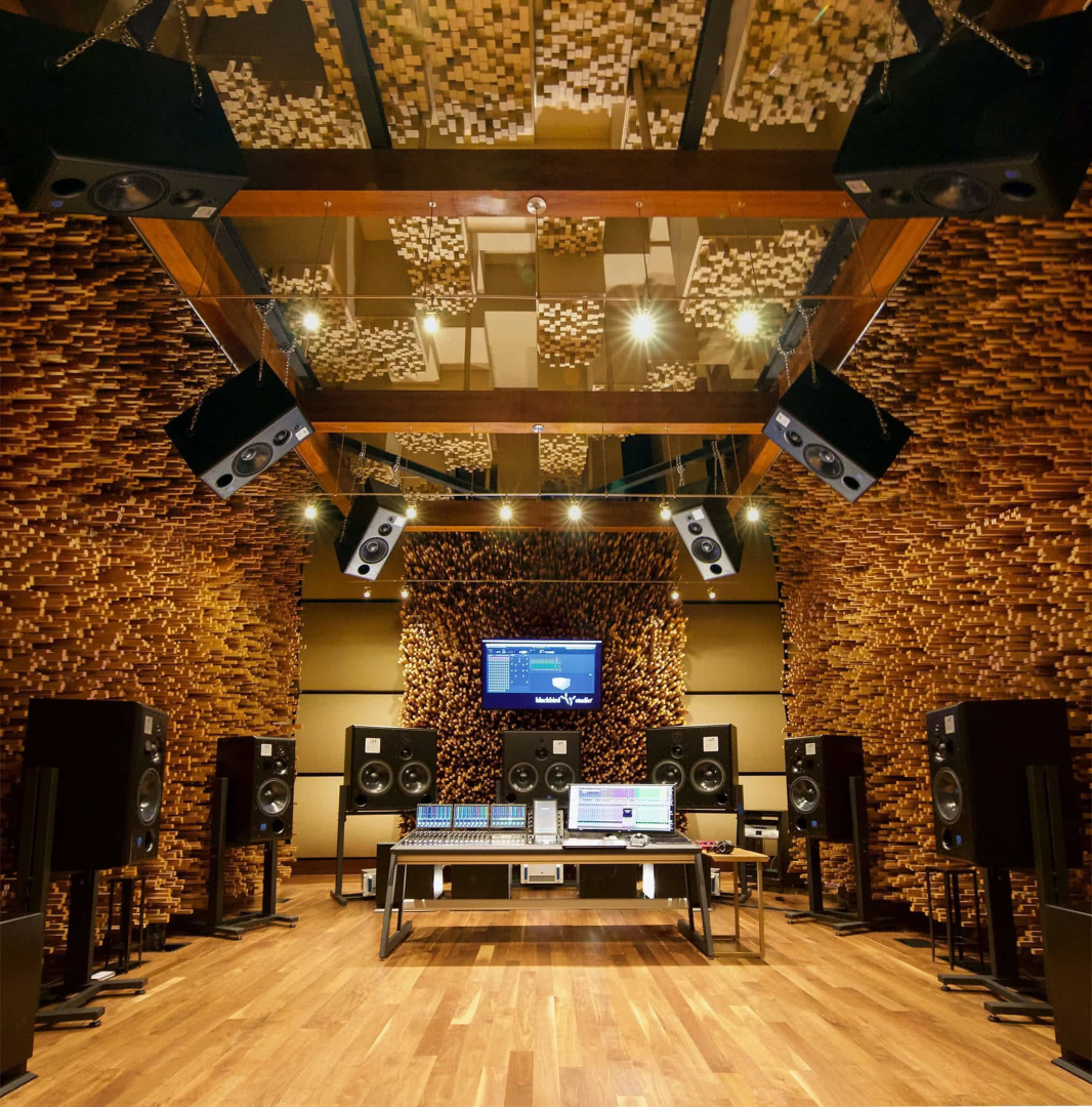

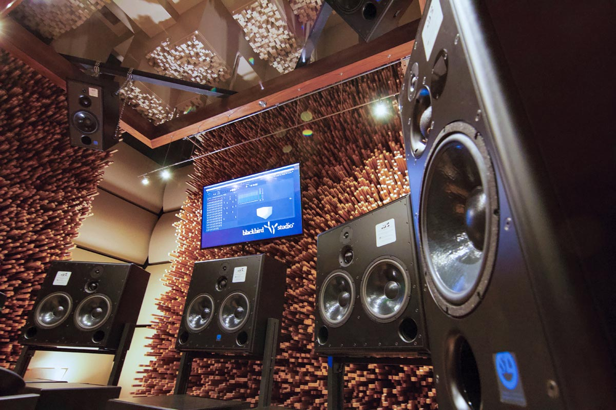

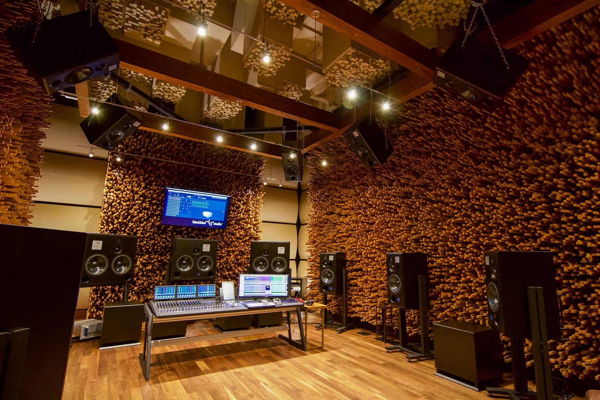

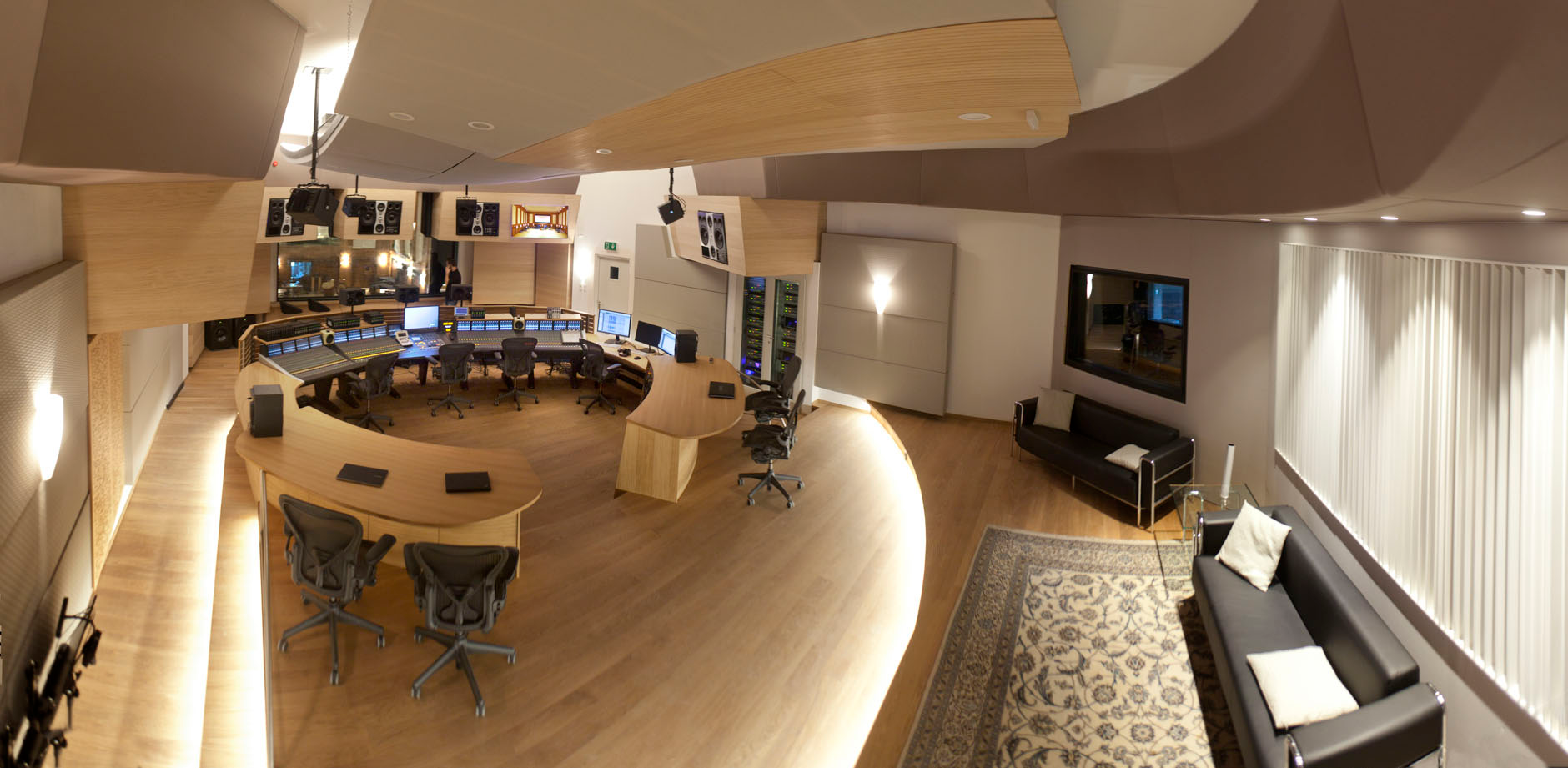

Black Tornado Studio , Κοπεγχαγη
9.1.6 , Dynaudio Core
With Apple Music and Tidal now embracing Dolby Atmos, a wide variety of existing music is being remixed for this immersive format.
And, of course, an increasing share of newly-recorded music is also released for Dolby Atmos playback. Therefore, it was a natural next step for Black Tornado Studio in Copenhagen, Denmark to literally expand their sonic palette by upgrading to a 9.1.6 speaker system. The reason for this particular configuration instead of the more commonly used 7.1.4 is due to the size of the control room.
"Our control room is quite large, and in order to cover the area sufficiently, we added a few extra speakers, as well as two Core Subs to handle the LFE-channel," explained co-owner and audio engineer, Lars Lundholm.
"This setup gives us the benefit of having a pretty large sweet spot by the console, which means that we can have an entire 5-6 piece band listening to immersive mixes at the same time rather than taking turns."
The speaker system consists of 15 three-way Core 47 studio monitors for the surrounding and upper layers, as well as two Core Sub subwoofers for the LFE-channel. When calibrating the room, Dolby's engineer did bass management on every single speaker, and obviously room-corrective EQ and delay adjustments were carefully applied as part of the Atmos certification process.
"We have been using Dynaudio BM15A speakers for many years for near-field monitoring so when we decided to upgrade to immersive sound, we had no doubt that Dynaudio's Core series would be the perfect choice," Lundholm adds. "We ran pink noise through the speakers overnight to break them in properly, and the immersive tracks we have played through the system after the Dolby Atmos calibration simply sound amazing. We can't wait to welcome recording artists to this brand-new, mixing environment and help them present their music in Dolby Atmos." ,,

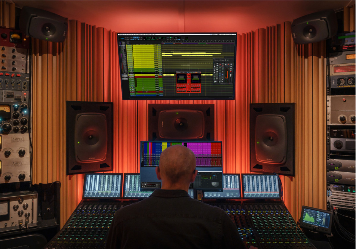

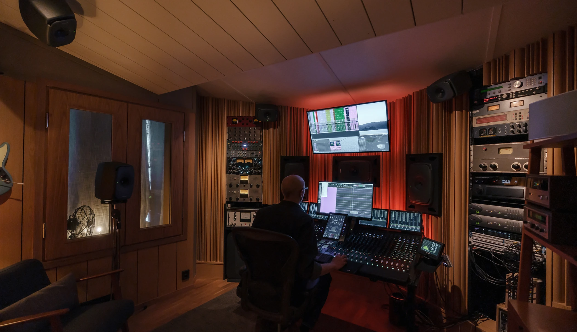

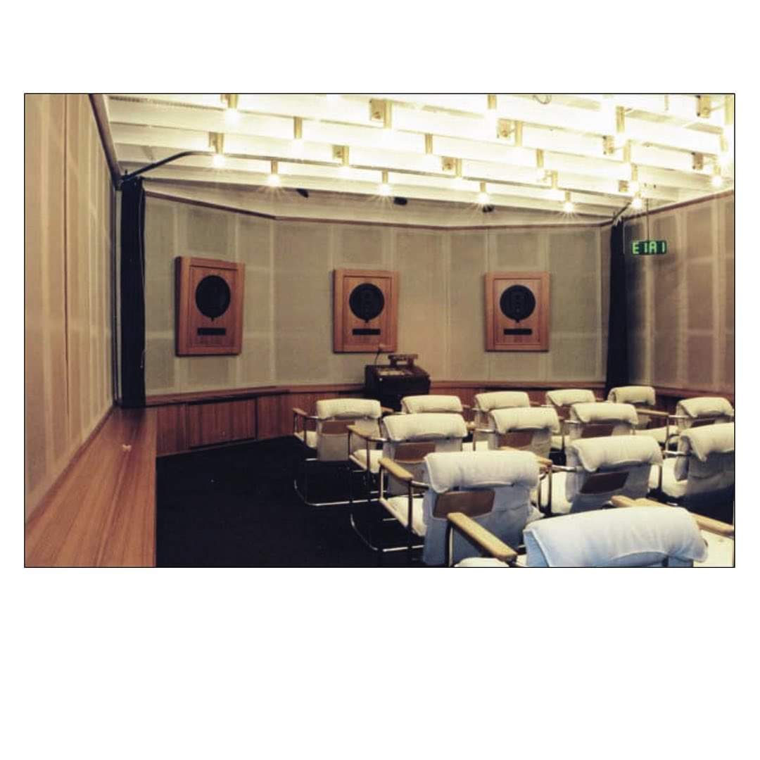

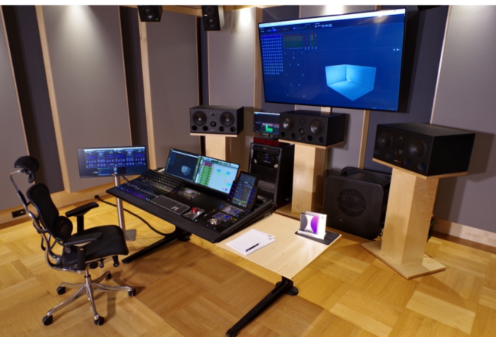

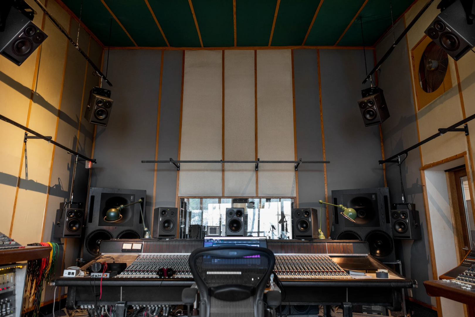

Portia Street Studios, Λος Αντζελες
7.1.4 Neumann KH 310 & KH 120
,,In the bass the new monitors are supported by two existing 18-inch subwoofers.,,
“The transition between the 310s and the height speakers is seamless. I don't feel there is an audible separation anywhere between the two KH models and their individual frequency responses.”
,,Παρά τον μεγάλο αριθμό ηχείων που στοχεύουν στη θέση ακρόασης, ο Ely προσθέτει: «Ένα άλλο πράγμα που με εντυπωσιάζει είναι ότι μπορείς να δουλεύεις με αυτα τα μονιτορς για πολύ μεγάλο χρονικό διάστημα. Δεν είναι ότι ακούω πολύ δυνατά, αλλά λαμβάνοντας υπόψη ότι υπάρχουν πάντα 11 ηχεία στο κεφάλι μου, είναι αξιοσημείωτο ότι δεν αισθάνεσαι κουρασμένος μετά την ακρόαση».
Αν και ένα σύγχρονο μονιτορ συστημα για τις πιο πρόσφατες ιμερσιβ μορφές μουσικής απαιτεί συνήθως πρόσθετη υποστήριξη για τα μπασα, σύμφωνα με τον Ely τα KH 310 είναι εγγενώς ικανά να παράγουν πολύ χαμηλές συχνότητες: «Άκουσα τα 310 χωρίς υπογούφερ και έχουν ενα απροσδόκητο χαμηλο για το μέγεθός τους.» Ενώ οι διαστάσεις του χωρου επισκοπησής του απαιτούν την ενσωμάτωση υπογούφερ στο σύστημα, ο Ely λέει: «Σε μικρότερα δωμάτια δεν χρειάζεται απαραίτητα να προσθέσετε υπογουφερ στα 310s».
Αυτο πρεπει να πονεσε λιγουλακι τους απανταχου μπασοκεφαλους:p :D

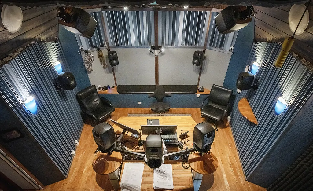

TRTPK Studio, Ουτρεχτη Ολλανδια
5.817
10.058

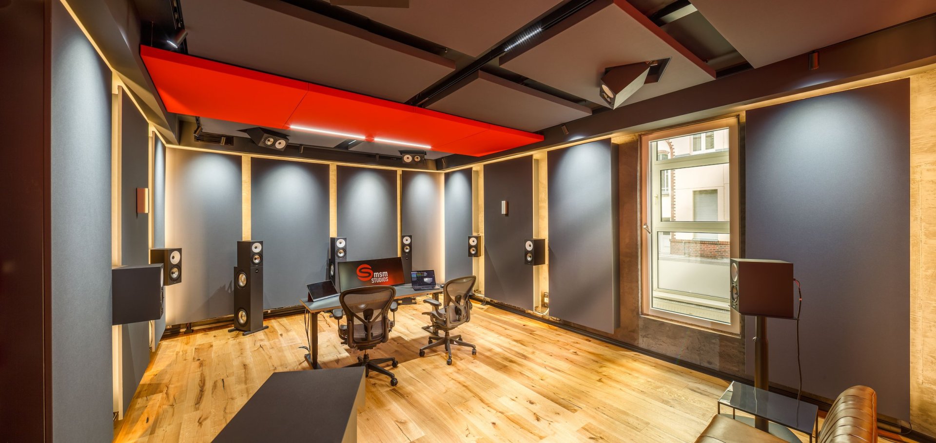

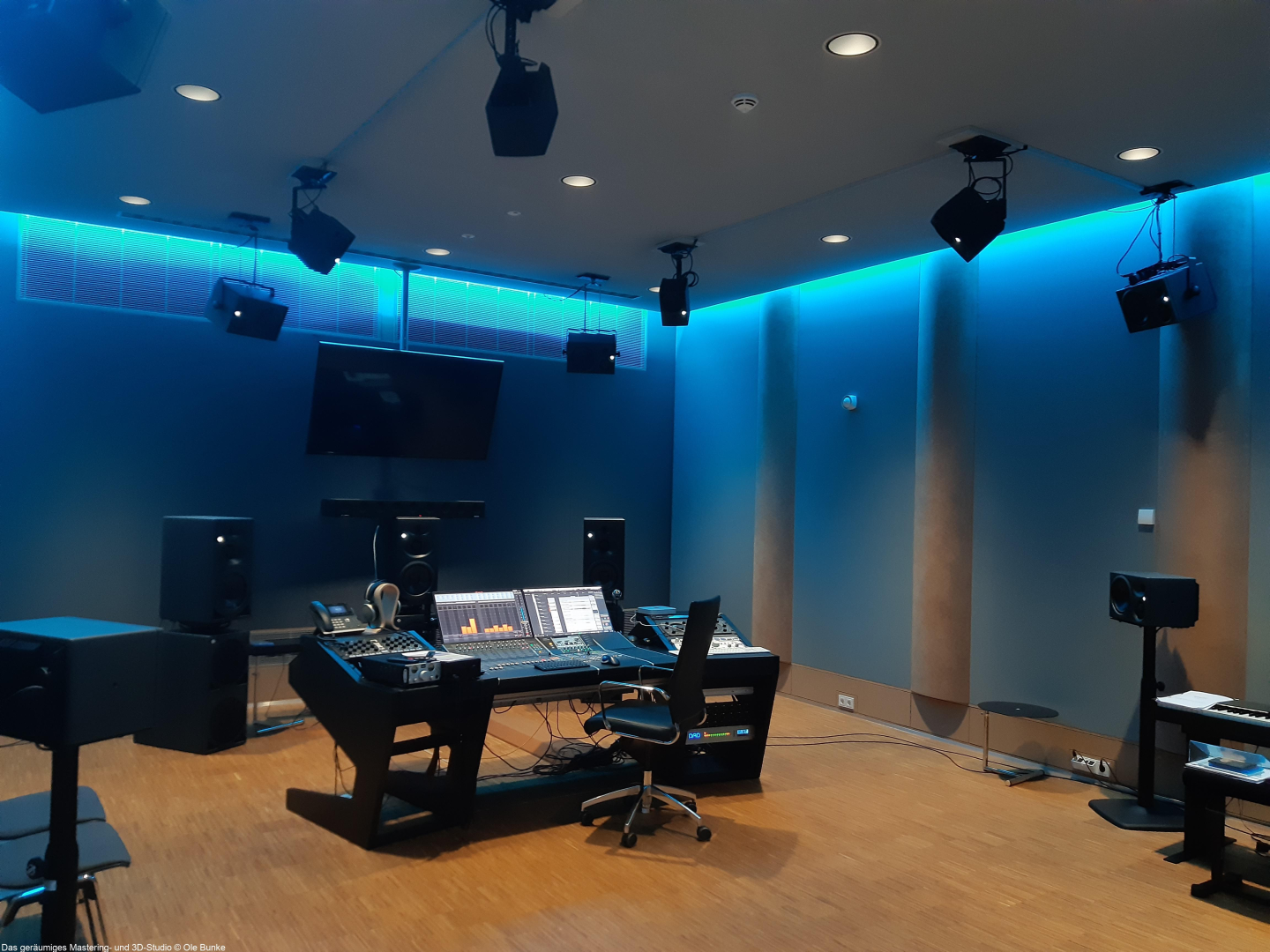

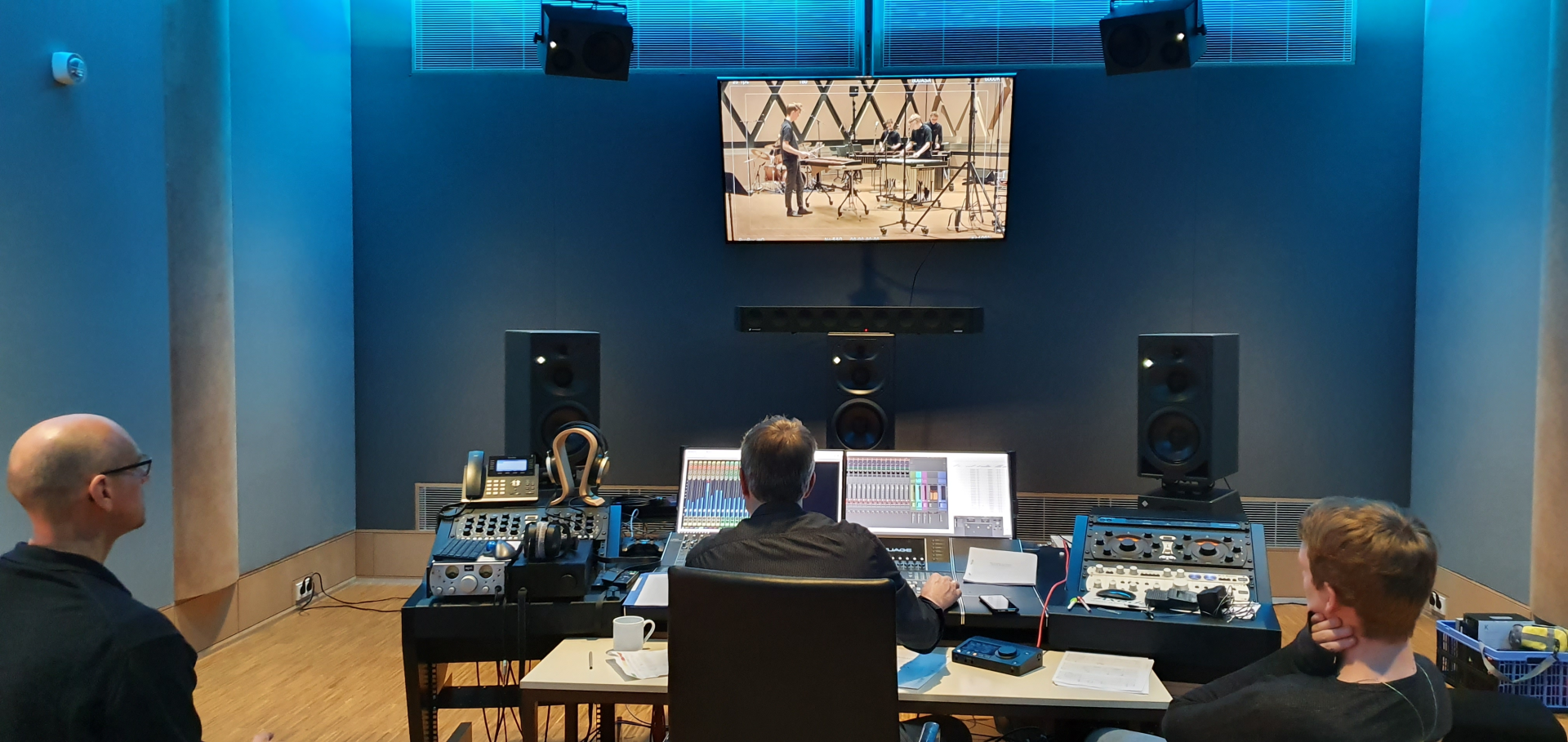

Bauer Studios, Ludwigsburg Γερμανια
«Πέντε KH 310 σχηματίζουν τον κύκλο surround. αν χρειαστεί μπορούμε να προσθέσουμε άλλα δύο KH 310 για 7.1. Το υπογούφερ είναι KH 870. Για τα ηχεια οροφης χρησιμοποιούνται τέσσερα KH 80 DSP.

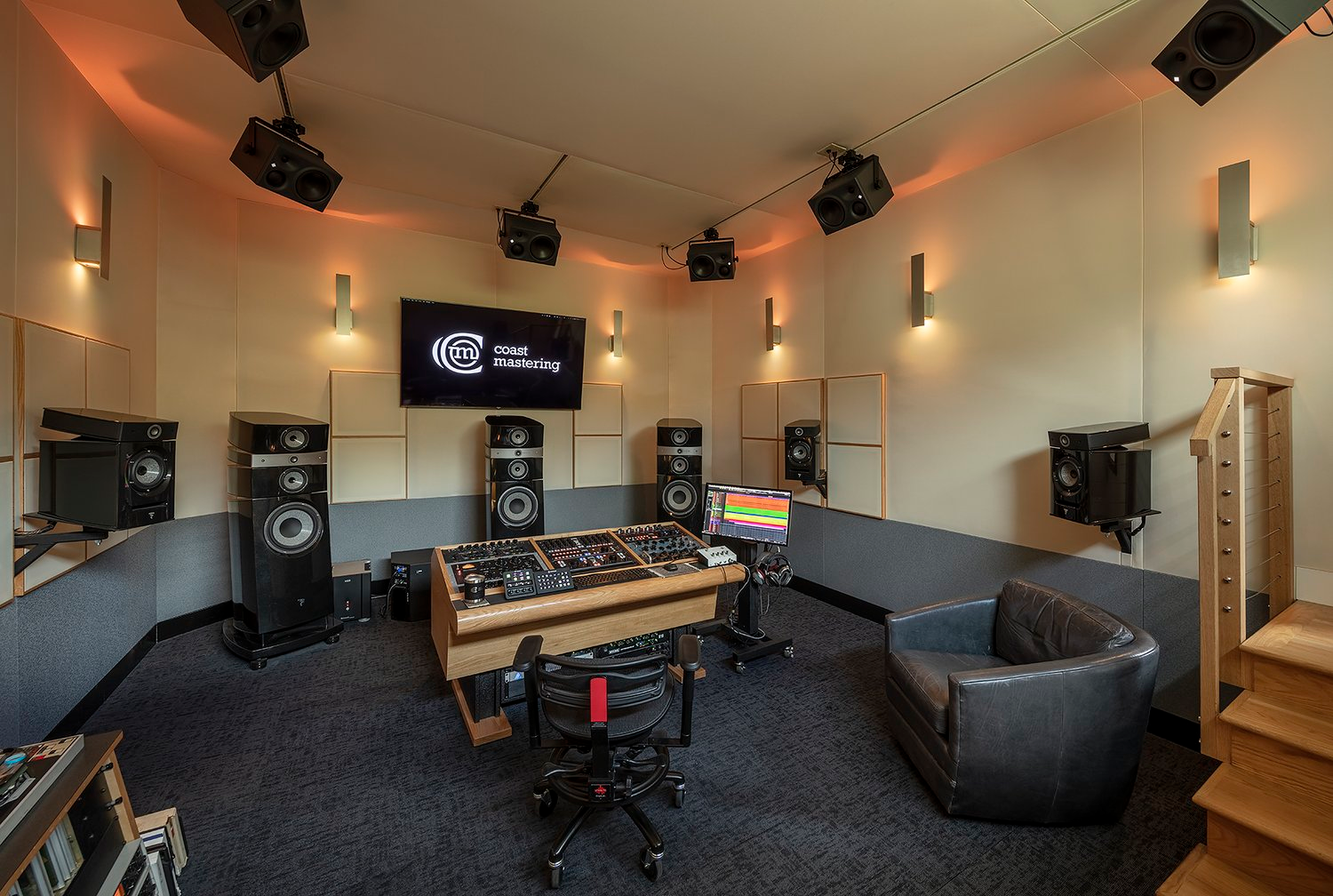

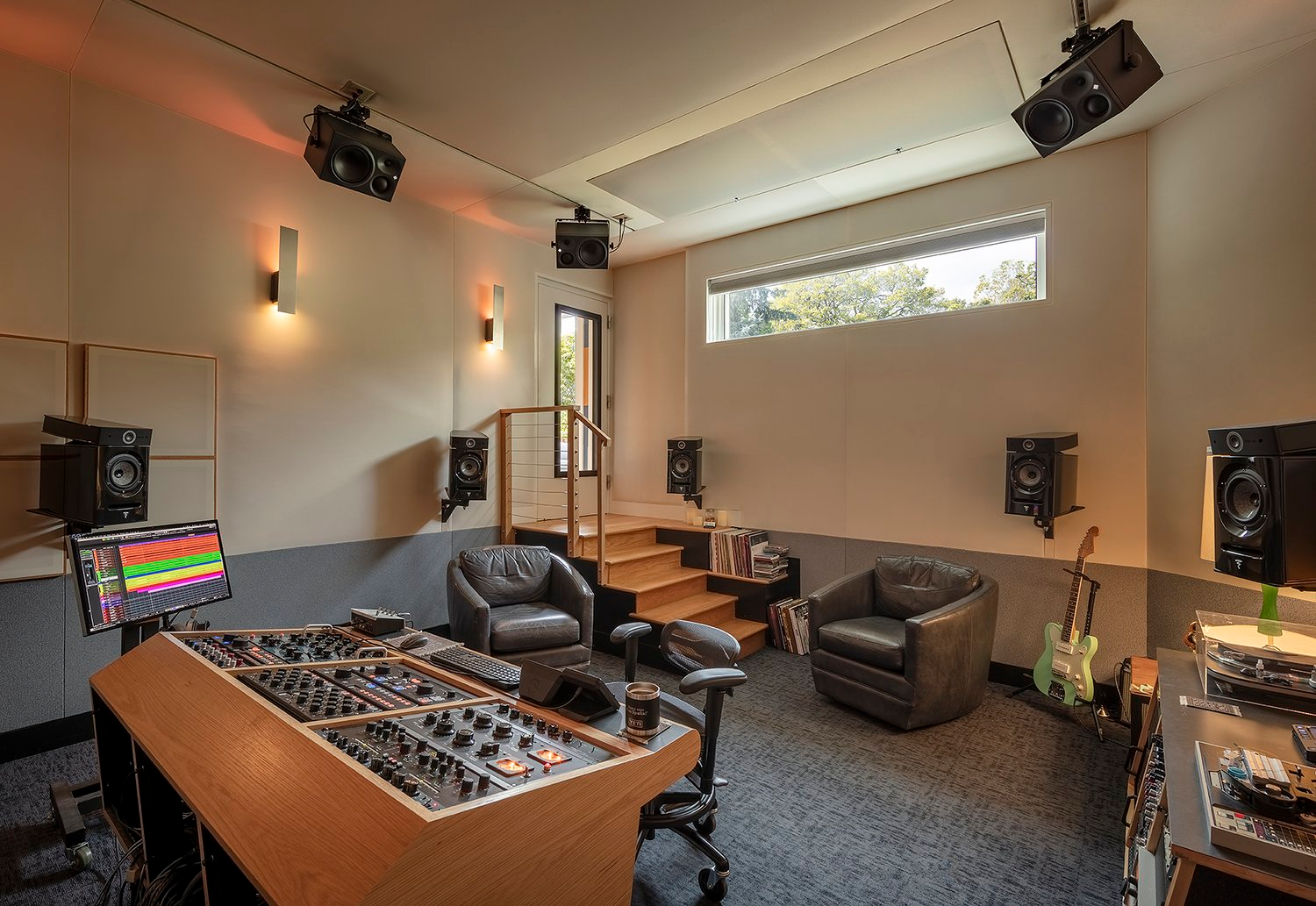

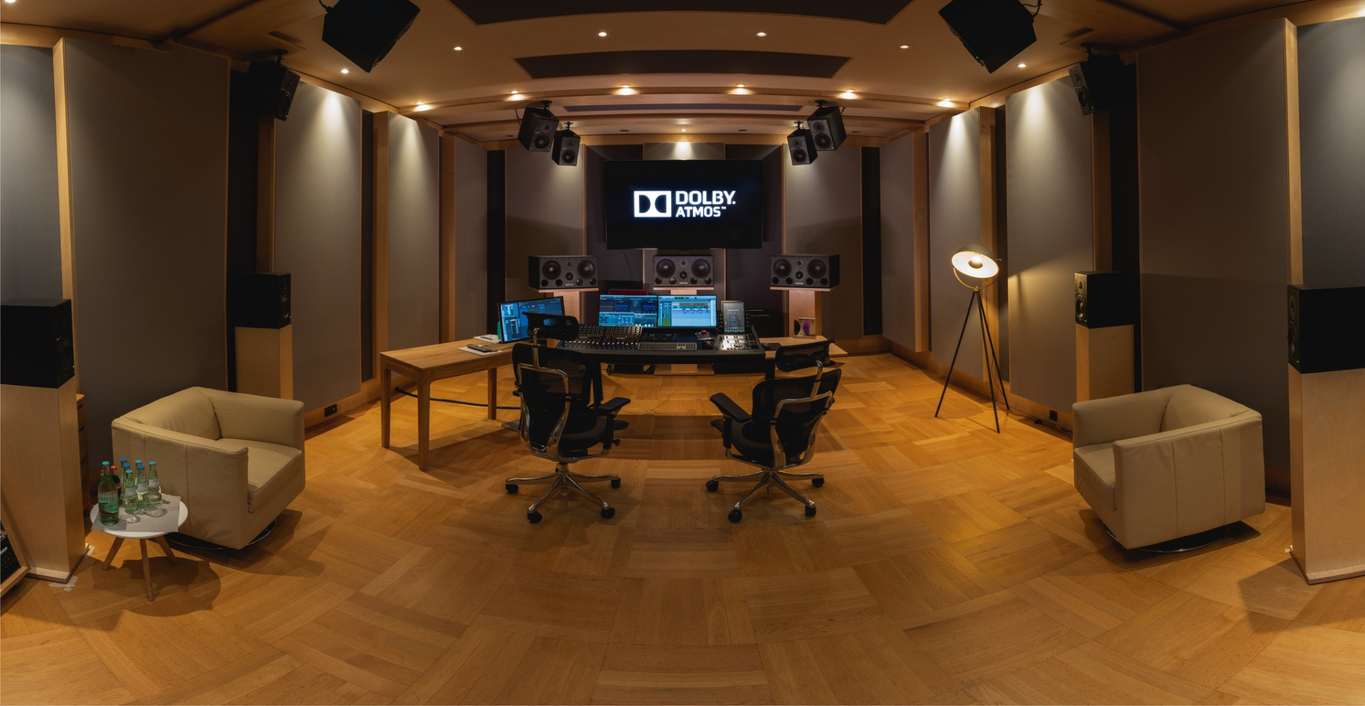

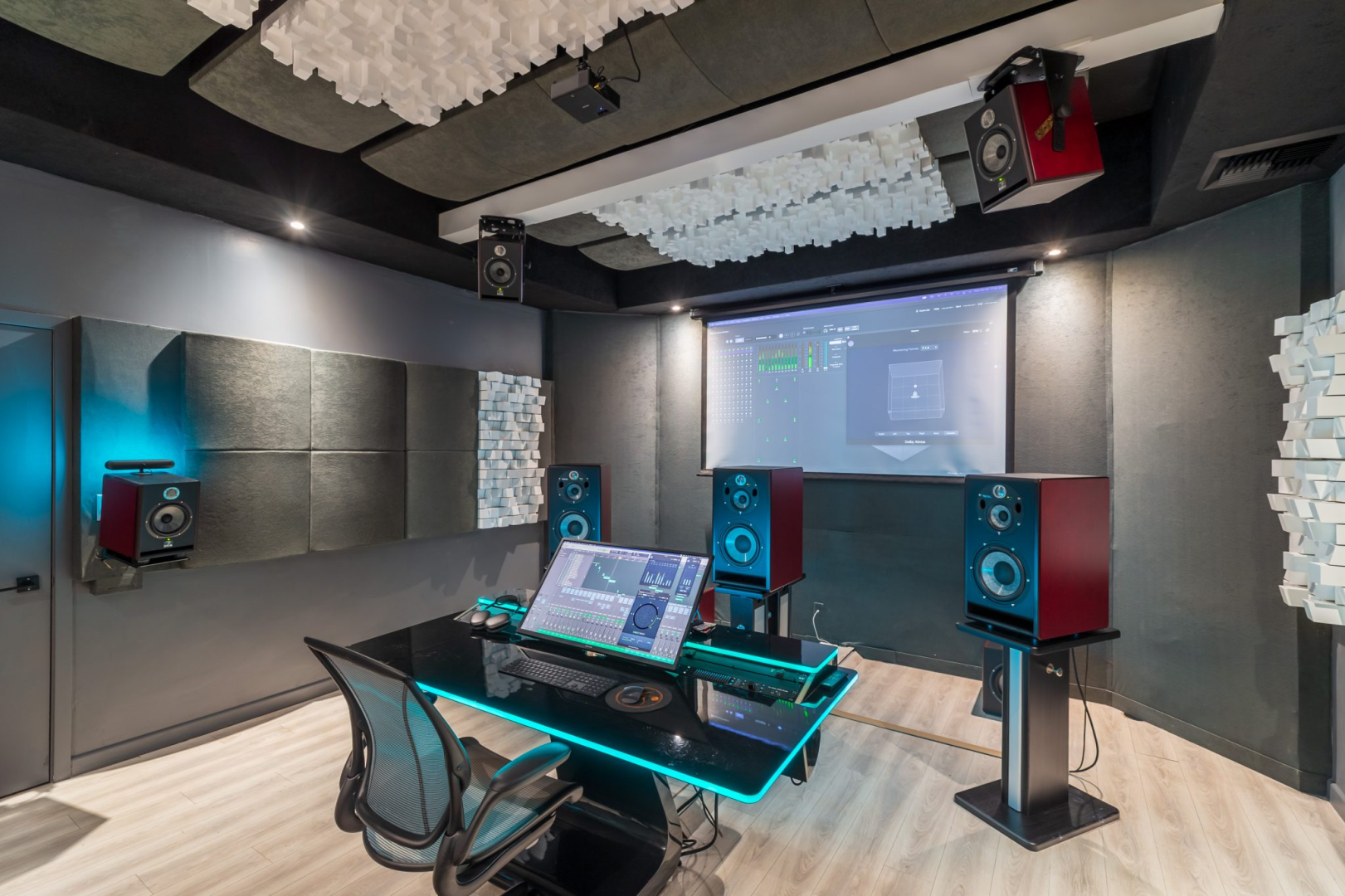

Coast Mastering Studios , Berkeley, Kalifornien
Το υβριδικό σύστημα 9.1.6 αποτελείται από ηχεια Focal Stella και Focal Diablo Evo με ενισχυτές Bricasti για το βασικό επίπεδο, ένα υπογούφερ Meyer Sound Amie και έξι Neumann 310 στην οροφή. Τα ηχεία οροφής είναι προσαρτημένα σε ράγες, έτσι ώστε να μπορούν να ρυθμιστούν για διαφορετικα φορματ.

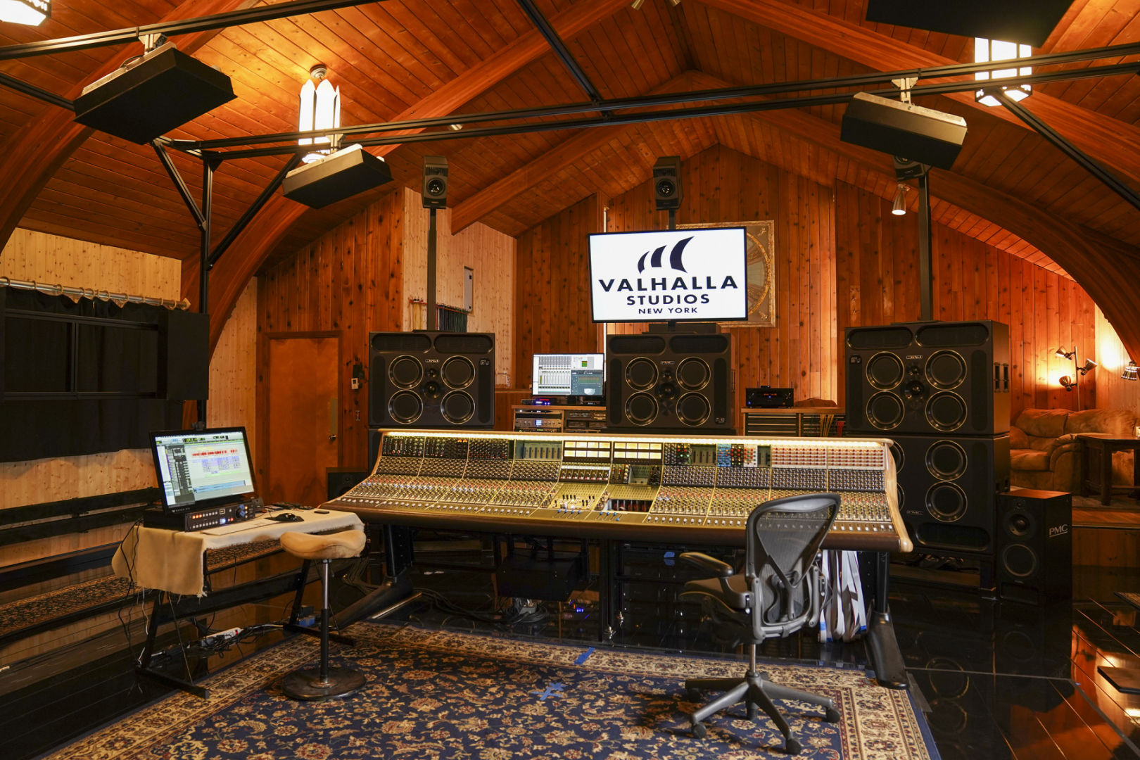

Valhalla Studios, Νεα Υορκη

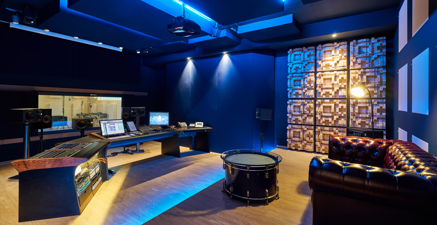

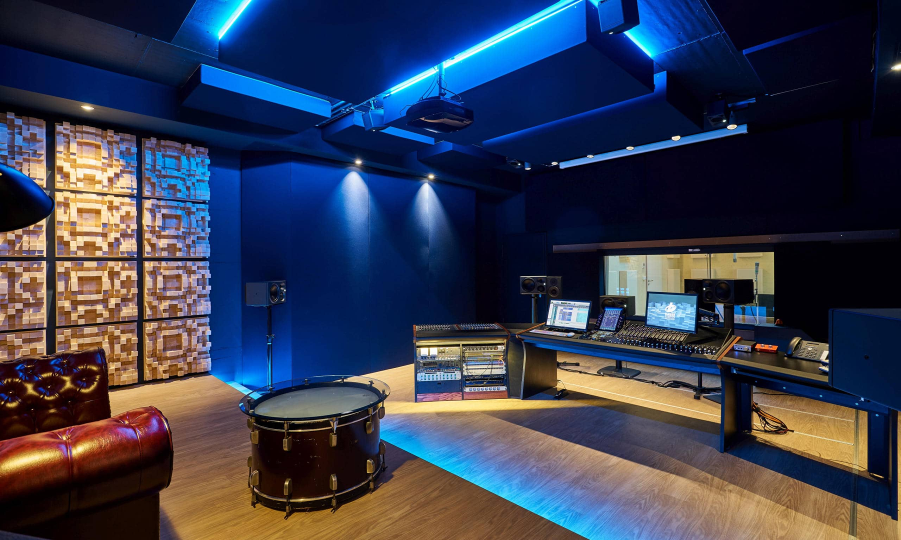

Νεο ιμερσιβ στουντιο στην καρδια της Γερμανιας στο Βερολινο. MSM Studio και στο Βερολινο πλεον περα απο το γνωστο του Μοναχου.
Θα χρησιμοποιηθει για δικες τους πολυκαναλικες μιξεις , για παρουσιασεις και επιδειξεις καθως και για παραγωγες τριτων που δεν εχουν το απαιτουμενο χωρο και εξοπλισμο.
Προκειται για room in room κατασκευη απο τα χερακια του γνωστου Jochen Veith (Acoustic Design by JV.ACOUSTICS ).
Στην ομαδα του Stefan Bock προστεθηκαν και οι Hans-Martin Buff & David Merkl. Δεν θα σας δειξω τι κοσμος μαζευτηκε στα εγκαινια.
Η δημιουργια ενος πολυκαναλικου στουντιο στην πρωτευουσα ηταν επιβεβλημενη, αλλωστε οπως λεει και ο Στεφαν μπορει κανεις να συζητα ωρες με τους ενδιαφερομενους για τον πολυκαναλικο ηχο αλλα μια ακροαση μερικων λεπτων στο στουντιο ειναι καθοριστικη.

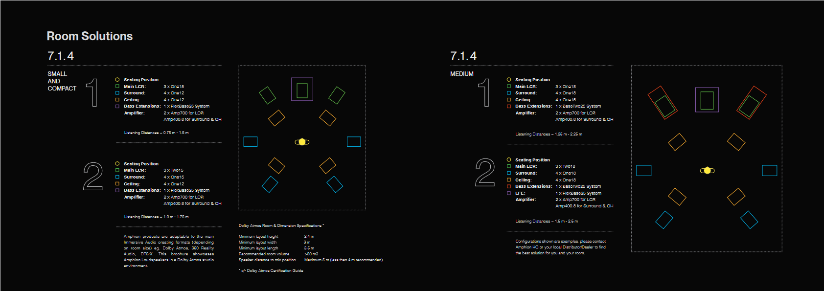

Το Σεταπ αποτελειται απο ηχεια της φιλανδικης εταιρειας Amphion σε διαταξη 9.1.4 . Δοκιμασαν διαφορα ηχεια και κατεληξαν σε αυτα οπως αναφερει ο Stefan Bock. Ο Στεφαν ειναι επισης οπαδος των front wides διοτι κλεινουν ομορφα το κενο αναμεσα στα προστινα και τα σαραουντ καναλια. Τα ηχεια οροφης τοποθετηθηκαν με τετοιο τροπο ωστε να μπορουν να αναπαραχθουν ικανοποιητικα ολα τα πολυκαναλικα φορματς βλεπε Auro 3D, Atmos κτλπ. Κατοπιν συζητησεων με την Universal και αλλους πελατες παραιτηθηκαν απο την τοποθετηση 6 ηχειων στο ανω επιπεδο. Κεντρικος επεξεργαστης, ενας τρινοφ Altitude 32.

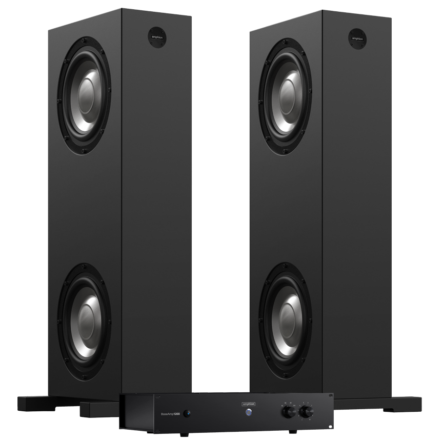

Εδω φτανουμε στο ενδιαφερον σημειο. Δεν υπαρχει καποιο bass management. Στον χωρο υπαρχει ενα σαμπ κατω δεξια ,δεν φαινεται στις εικονες, μονον σε βιντεακι, το οποιο εκτελει χρεη LFE. Τα μπροστινα ηχεια εχουν γινει με την προσθηκη καταλληλων υπογουφερ σε full range.
Για να μην ξεχνιομαστε, για καθε μπροστινο δορυφορο 1 υπογουφερ με 2 10ιντσα και 2 παθητικους ακτινοβολητες. Η εξηγηση για μια τετοια επιλογη ειναι οτι δεν ηθελαν να μπλεξουν με διαφορες φασεις και αλλα παρομοια θεματα και τα ηχεια κατεβαινουν χαμηλα. Οι δορυφοροι ειναι αν καταλαβα ιδιοι διοτι η ομοιογενεια εδω αποτελουσε βασικη προτεραιοτητα.
Υποθετω οτι βαλαν τα παρακατω ηχεια: Amphion One18 με 6,5 woofer
προεκταση μπας Base Two 25 . Εδω το εχω να πω κατι , αλλα θυμηθηκα την παροιμια με τον κουφο και την πορτα:biggrin:
Επισης βρηκα και ενα paper της Amphion για πολυκαναλικες διαταξεις στο σαιτ της.

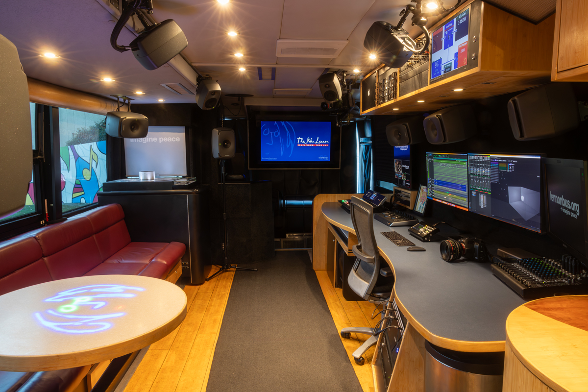

There are several Lennon buses now making appearances in the U.S. and Europe. These are full-fledged audio and video production studios on wheels, with each bus appointed a crew of three producers/educators who live onboard and facilitate programs designed for small, medium and large groups.
Earlier this year, the US bus got a major studio overhaul, which included installing a Dolby Atmos / immersive monitoring system.
