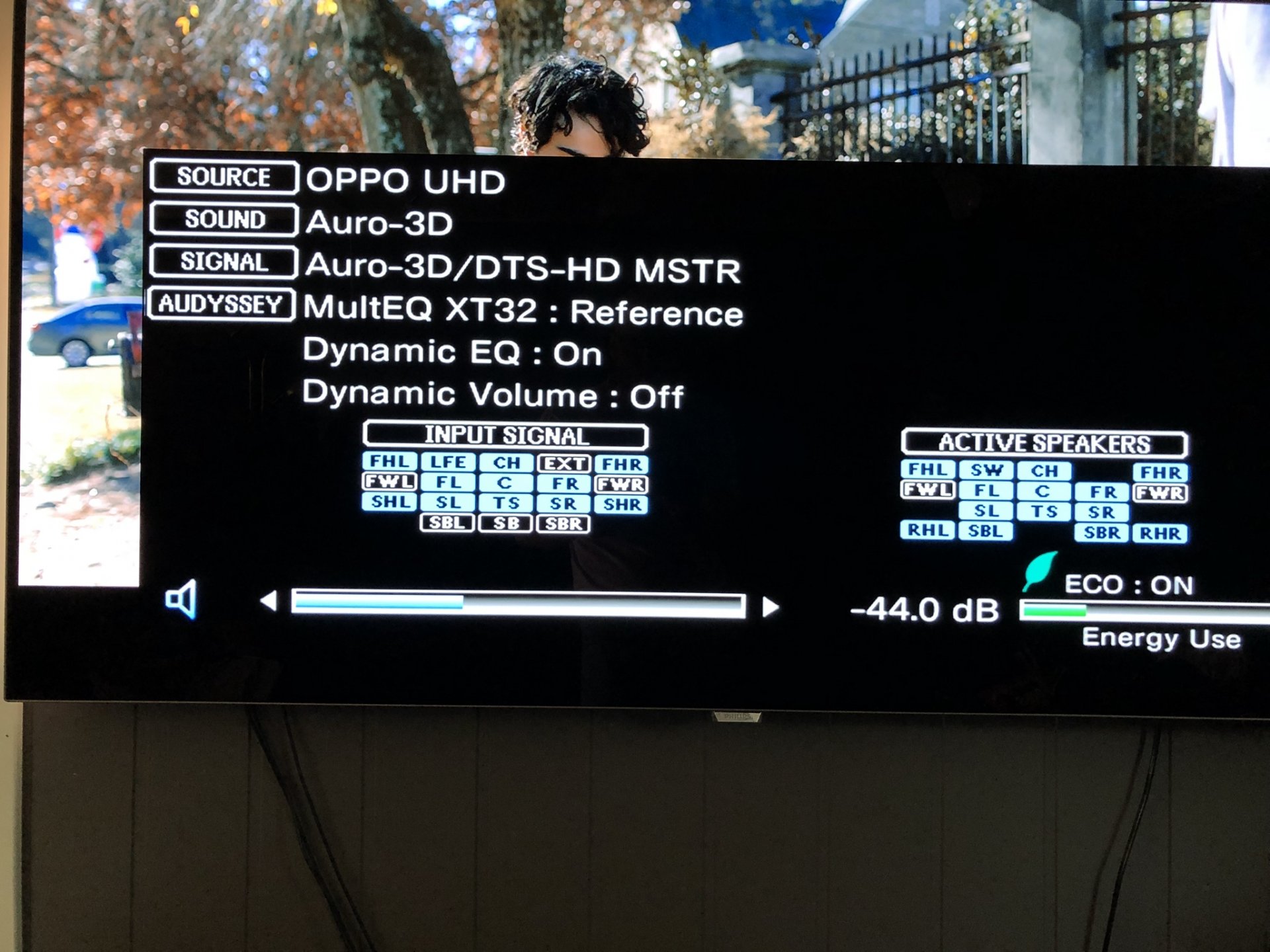

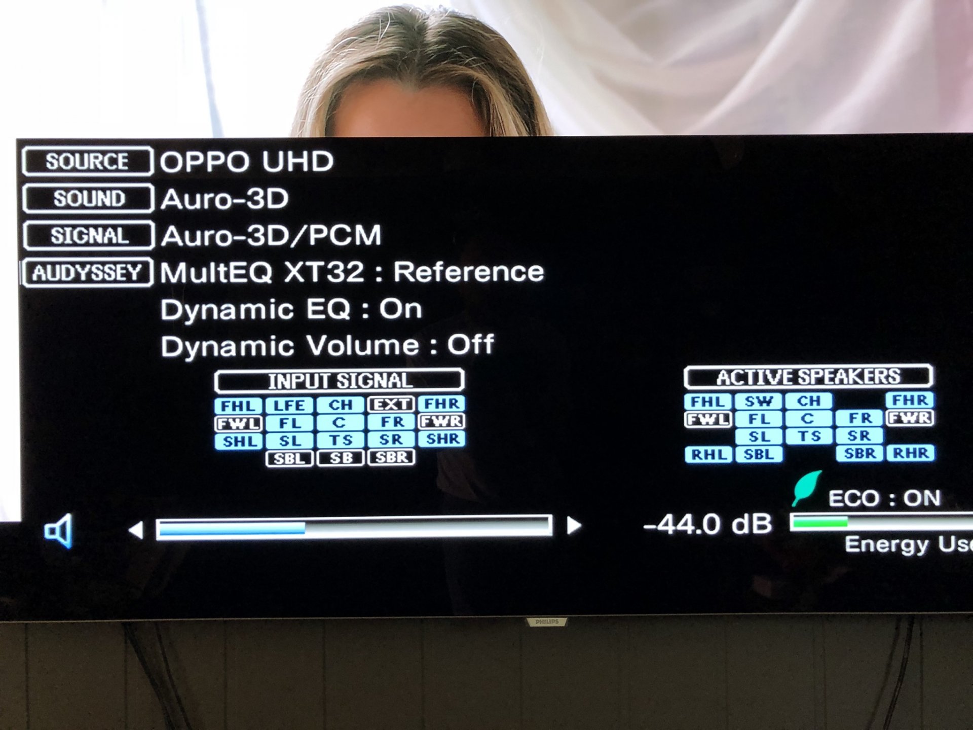

μιας και το εχεις Γιαννουκο, να σου πω οτι εχει το καλυτερο Audio Decoder απο ολα τα oppo που περασαν και πιθανοτατα και απο ολα τα αλλα player που κικλοφορουν ως σημερα ;)
εσυ βεβαα δεν μπορεις να το δεις μιας και δεν εχει auro3d ο av σου
για την εικονα μολις παραλαβω τον προβολεα :D

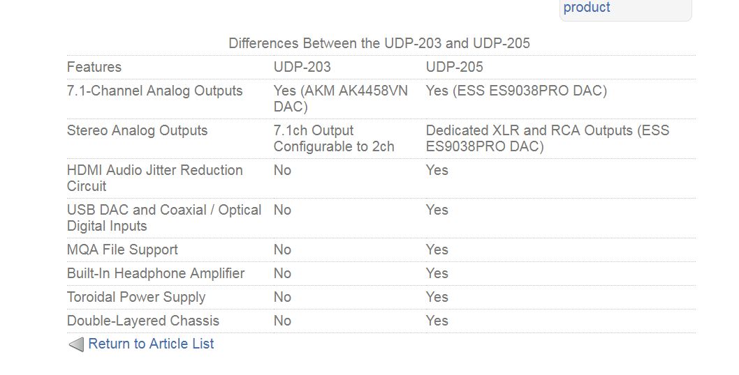

Σταυρο παρακατω που διαφερουν τα δυο player, σιγουρα ο μηχανισμος ειναι ο ιδιος και στα δυο απο κει και περα αλλαζει ολη η φιλοσοφια στα υπολοιπα.
Understanding the Differences Between the UDP-203 and UDP-205
The OPPO UDP-203 and UDP-205 share many of the same primary components, and while the UDP-203 and UDP-205 are identical in performance when it comes to video, the UDP-205 offers a number of enhancements in terms of audio.
The UDP-205 features improved sound quality from its analog audio outputs courtesy of its implementation of dual 32-bit ESS Technology ES9038 PRO reference DACs, a toroidal power supply, and two sets of dedicated stereo analog outputs (balanced XLR and unbalanced RCA) for 2-channel enthusiasts. Customers who do a great deal of critical music listening using a very high end, analog connected system will benefit most from these additions.
The UDP-205 also features a high precision HDMI clock and special HDMI audio jitter reduction circuit on its HDMI Audio Only output. For more information about this feature, please read the following KB article here.
As of November 2017, the UDP-205 supports the audio format MQA (Master Quality Authenticated). Customers are able to play MQA files from connected USB hard drives and thumb drives, DLNA servers, and SMB shares.
Finally, the UDP-205 also features a headphone amplifier for use with high-quality headphones, as well as three additional digital audio inputs to take advantage of the internal DACs (optical, coaxial, and a 2-channel asynchronous USB DAC input.)
https://www.oppodigital.com/KnowledgeBase.aspx?KBID=131&ProdID=UDP-205
