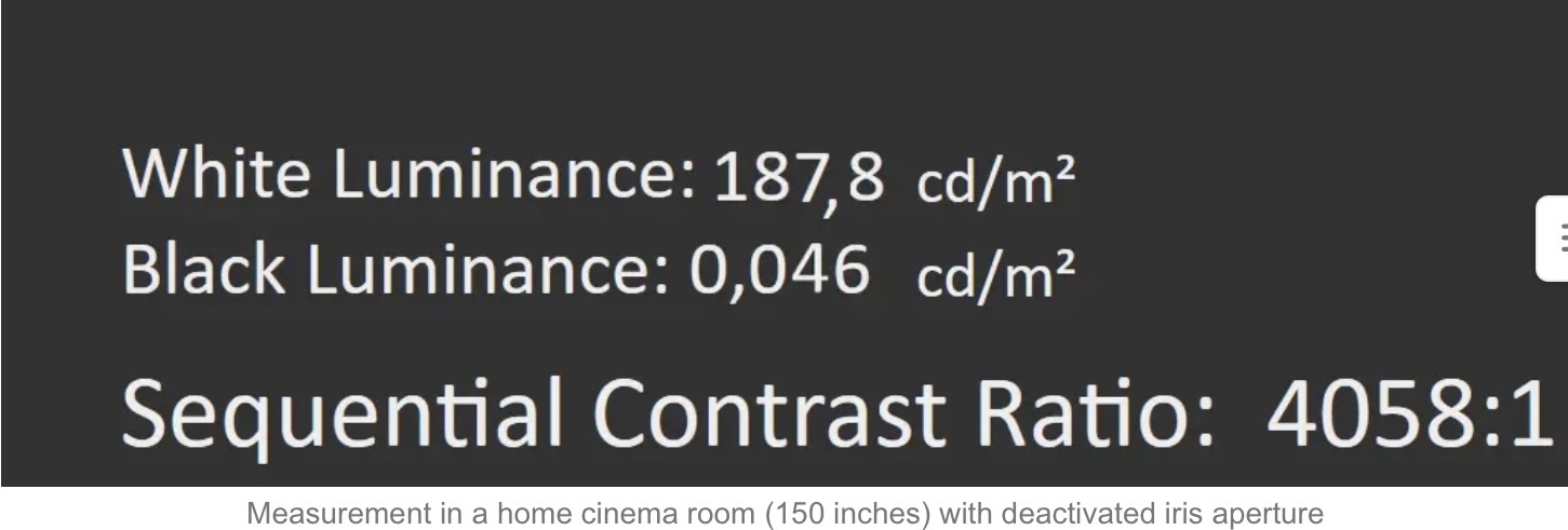

Συγκεκριμένα για τον Valerion Max .
Measured dry, the value is slightly below 2000:1 – measured between the brightest and darkest image of the projector, without any digital aids or image processing.
Through the fine internal control of the lasers, the projector achieves a usable contrast of around 4058:1. Strictly speaking, this is not native contrast, but an electronically optimized value that cannot be deactivated by the user.
If the Iris statically somewhat closed (level 4 of 6), the black level can be further improved. This way we achieve a practical image effect of 6669:1. This means that the VisionMaster Max does not reach the reference values of modern LCoS or D-ILA projectors The result is impressive. The interplay of native and dynamically enhanced contrast, along with signal processing, creates an image that, in practice, significantly exceeds the measured values alone. With all dynamic corrections and real-time adjustments, we even exceed the Valerion VisionMaster Max's stated contrast ratio of over 50.000:1
Source : https://en.heimkinowelten.de/valerion-visionmaster-max-test-vorstellung/
