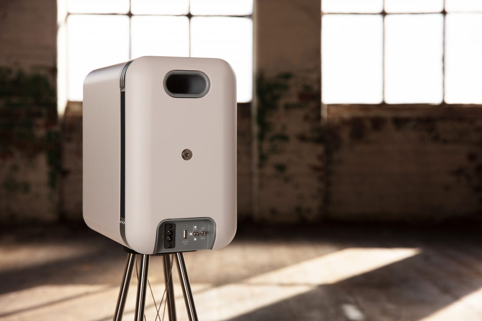

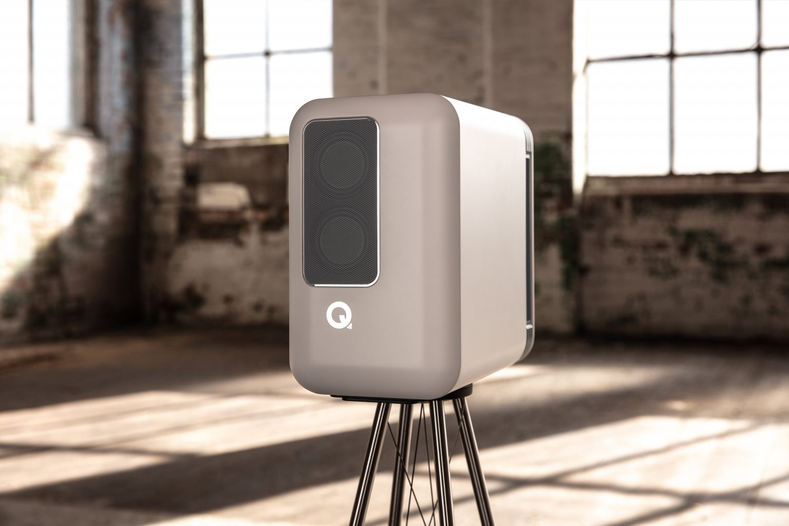

Q Acoustics introduces its first active loudspeakers: Q Active 200 and Q Active 400

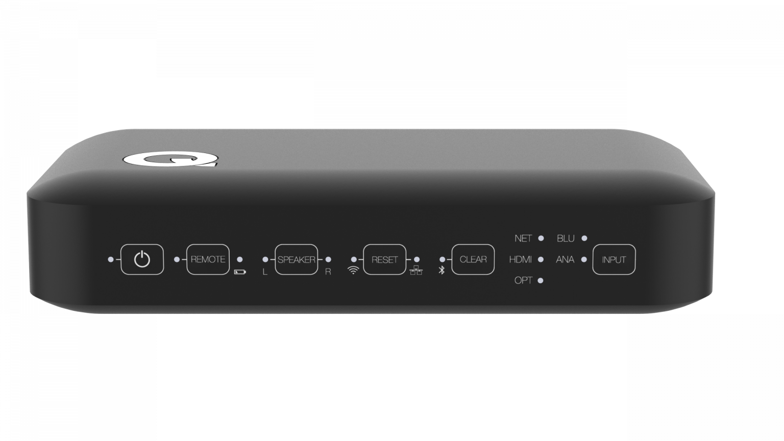

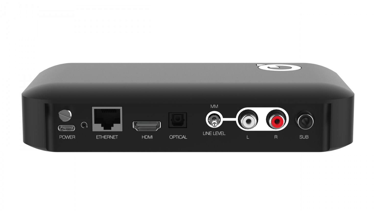

For wired sources, the Control Hub offers an HDMI ARC input, an optical digital input, an analogue line level input and a subwoofer output. You can also plug your turntable into the Hub – it features a built-in moving magnet phono stage.
The Q Active speakers are tuned to perform their best no matter where they are placed in your listening room. A switch at the back of the Q Active speakers lets you designate left or right channels, while another tells the speakers where they are positioned in a room – close to a wall, in a corner or out in free space. This information allows the Q Actives to fine-tune its low-frequency response to deliver the best possible sound for its environment.
Q Active 200 (£1,499 / $1,999 / €1,999 per pair, available October 2020)

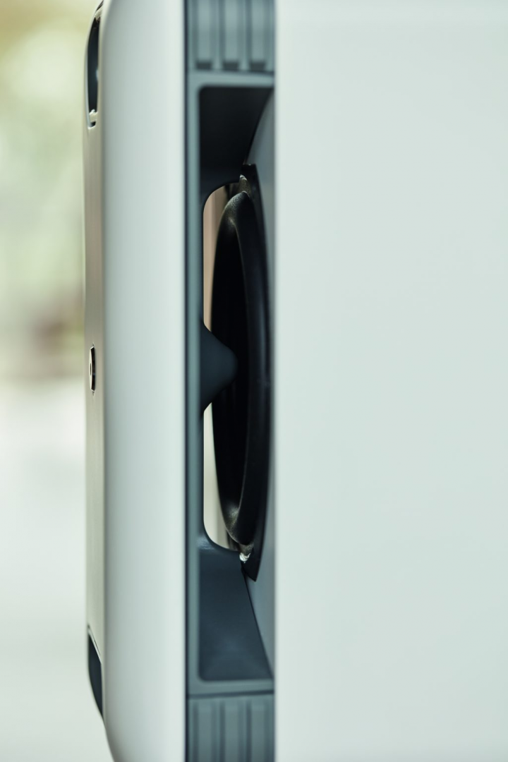

The Q Active 200 standmount speakers feature two 2.25in BMR drive units and a rear-firing 4.5in long throw subwoofer with a waveguide for excellent low-frequency bass performance. There are six discrete amplifiers powering the Q Active 200, resulting in a total power output of 280W.
The Active 200 can be equipped with the optional Q FS75 floor stands (£349/$499/€419 per pair). Inspired by the Concept 300’s Tensegrity stands’ principles of the 1951 Festival of Britain’s Skylon structure, this stylish four-legged stand eliminates unwanted vibrations to result in a purer sound.
Q Active 400 (available January 2021)
The Q Active 400 floorstanding speakers have the same BMR drive unit arrangement as the Active 200, but feature eight discrete amplifiers with 440W of total power output.
The key difference with the Q Active 400, besides its taller cabinet size, is that it features two rear-firing 4.5in subwoofers: one subwoofer at the top of the cabinet, one at the bottom. This arrangement neutralises the cabinet’s internal standing waves, which in turn reduces unwanted resonance and delivers a cleaner, tighter bass sound.
Both speakers will be available in two finishes: matte white and matte black.

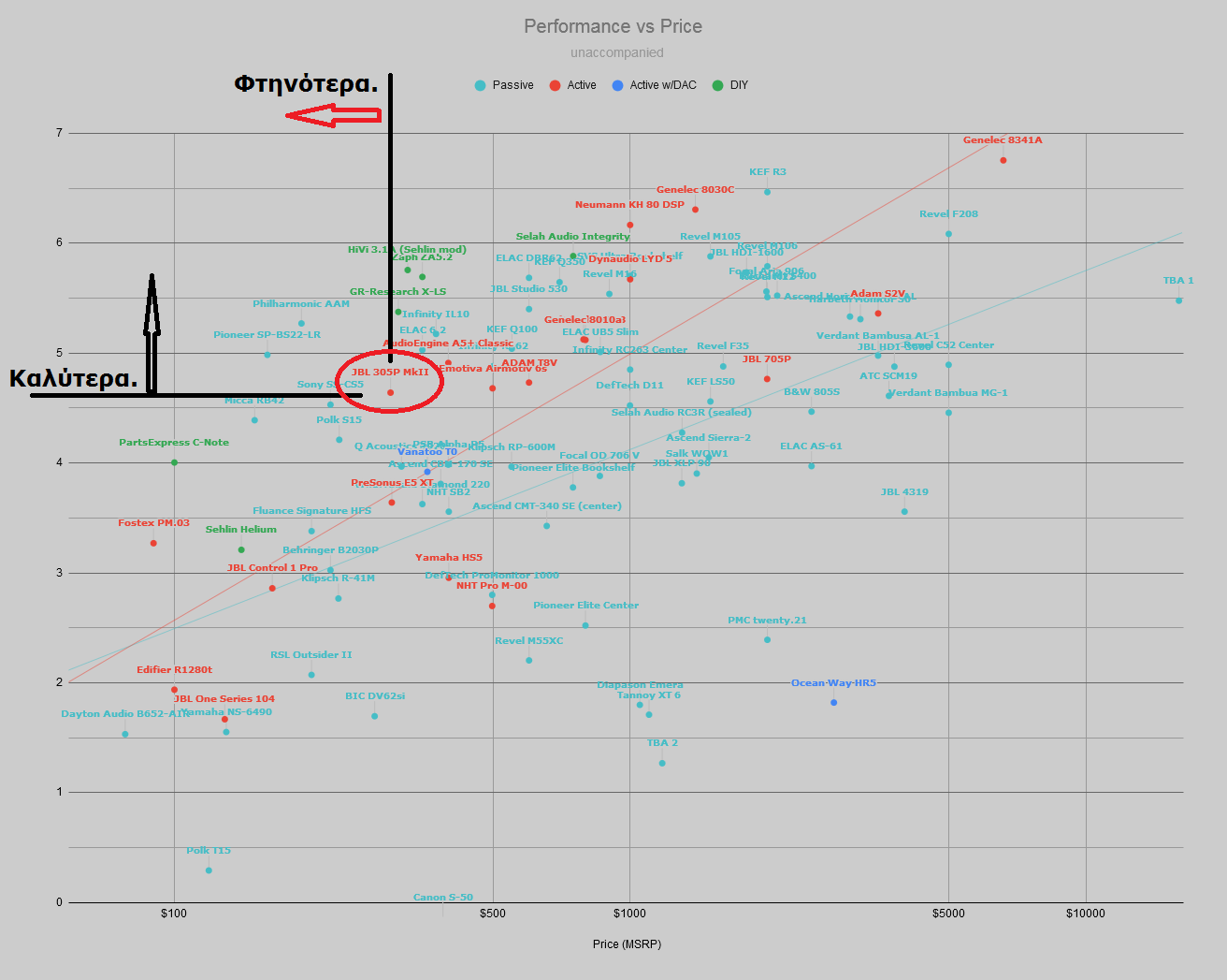

Εντάξει, δε χρειάζεται να ασχολούμαστε με την κάθε εταιρία που βγάζει ενεργά ηχεία. Μόνο με τις σοβαρές.
Στην παρακάτω εικόνα από εδώ
Εδώ είναι η "λίστα" με όλα. Για κάθε ρηβγιού έχει και παραπομπή.
Βλέπω ότι σε φτηνά ενεργά, δεν υπάρχουν καλύτερα από τα JBL LSR 305P με πολύ κοντά τους τα AudioEngine A5.
