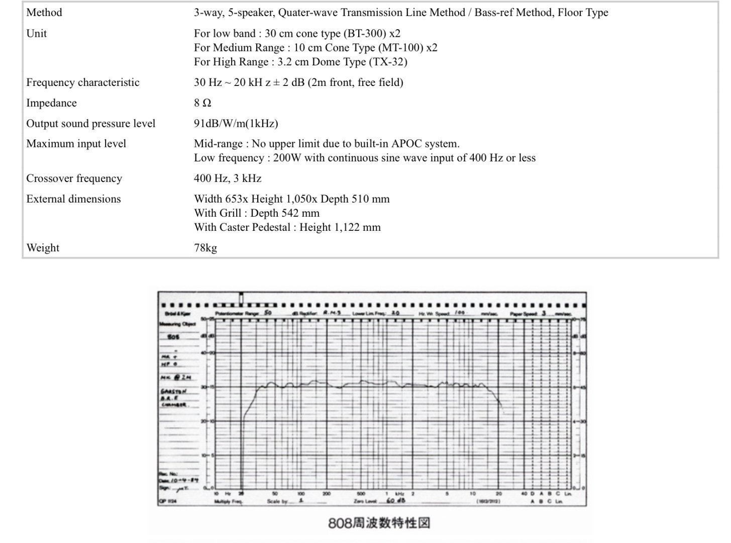

A professional studio monitor speaker jointly developed by Nakamichi and B & W.
The development of the 808 began in October 1981 when President Nimro Nakamichi asked B & W President John Bowe's to co-develop it. After that, based on the specifications presented by Nakamichi, two engineers conducted repeated technical negotiations and Mr. Bowers conducted hearing coordination in the trial listening room. The development took three years.
In the specifications presented by Nakamichi, there were 3 specific things written.
First, the flat frequency characteristics should be used to eliminate the colorization in the same way as in 801F to achieve an ultra-low distortion rate.
Second, the efficiency should be twice that of 801F to obtain 91 db at 1W input power.
Finally, the maximum sound pressure obtained in the listening room should be on the order of 120 db (125 db at peak).
The background to these requirements was the judgment that the monitoring capability of digital recording would become an essential requirement for pro-monitor speakers in the future, and that it would be necessary to support not only classical music but also all music sources….:biggrin:
