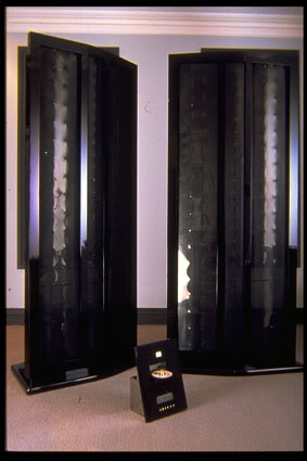

The EMPEROR speaker was designed from its inception to be the finest, reference class, full range electrostatic loudspeaker in the world. It takes advantage of the improvements in electrostatic technology over the past 20 years in every aspect of design.
5.WIDE DYNAMIC RANGE: By dividing the full range panel at around 150 Hertz from the subwoofer panels, the EMPEROR is able to generate over 120dB of acoustic pressure from 30Hz - 45kHz (at ultra-low frequencies of 15-20Hz, the spacing/film excursion limits the dynamic range to approximately 100dB reproduction at 20Hz).
.......... Unlike other 'reference' speakers which require satellite subwoofer sytems, the EMPEROR is able to reproduce low frequencies (-3dB point approximately 15 Hertz when fully broken in) without any sonic sacrifice. The sound is consistant in quality from 20 Hertz up to 45 kiloHertz because we use the same 13 micron polyester film for subwoofer and full range panels.
