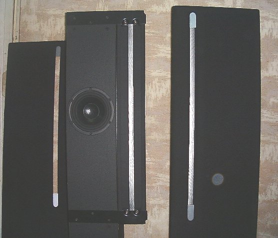

Apogee Slant 6
Specifications
Height 52½ inches
Width 14½ inches
Depth 14¼ inches
Bass driver 6.5" dynamic cone woofer
Midrange/tweeter 26" dipole aluminium ribbon
Max Sound Level 107db @ 4 meters
Sensitivity @ 3m 83.2dB (2.83V at 1m)
Frequency response 32Hz to over 25kHz
Crossover frequency 1kHz
Suggested amp power 50Wpc min 200Wpc max (8ohms)
Impedance nominal/minimum 6ohms / 4ohms
Weight 80lbs each
Finishes available Black Sand
Price (1996-7) $2500 (+$200 for magnetic shielding)
Apogee Slant 8
Specifications
Height 59½ inches
Width 17½ inches
Depth 17 inches
Bass driver 8" dynamic cone woofer
Midrange/tweeter 40" dipole aluminium ribbon
Sensitivity @ 3m ~86dB
Frequency response 26Hz to over 25kHz
Suggested amp power 100Wpc min 200Wpc max (8ohms)
Weight 120lbs each
Finishes available Black or Taupe Sand
Price (1996) $3995
Η Apogee εισήγαγε την σειρά των ηχειων Slant για να αντικαταστήσει τον υβριδικο Κένταυρο γύρω στο 1994 - 95. Δύο ηχεια παρηχθησαν για την αντικατάσταση των τριών Centaur. Το Slant 6 είχε 6 ½ "woofer κώνου και ένα 26" ριμπον. Το μεγαλύτερο υβριδικό, με την ονομασία Slant 8 είχε ένα 8 "woofer, σε συνδυασμό με ενα τουίτερ ταινίας 40". Τα Slant 6 και 8 εκθειάστηκαν πολύ από τα περιοδικά ήχου της εποχης, και ήταν πολύ δημοφιλή.

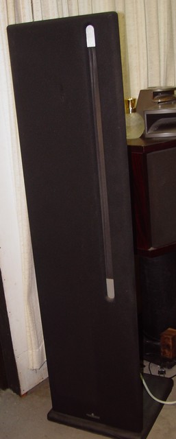

Apogee Cepheus 6
Specifications
Height 53 inches
Width 16 inches
Depth 12 inches
Bass driver 2 x 6.5" slot loaded dynamic woofers
Midrange/Tweeter 26" 6 element etched Aluminium ribbon
Max Sound Level Guessed at 107dB
Sensitivity @ 3m Guessed at 86dB
Frequency response Below 32Hz to over 205kHz
Suggested amp power High current 40W minimum
Impedance nominal/minimum 6 ohms / 4 ohms
Price at time of first sale (1996) Black Sand $3000Ash or Cherry $3300
Apogee Cepheus 8
Specifications
Height 61 inches
Width 20 inches
Depth 15 inches
Bass driver 2 x 8" slot loaded dynamic woofers
Midrange/Tweeter 40" 5-element etched Aluminium ribbon
Frequency response Below 30Hz to over 205kHz
Suggested amp power High current 50W minimum
Price at time of first sale (1996) Black Sand $4700Ash or Cherry $5000
Τα ηχεια Cepheus 6 και Cepheus 8 ήταν τα τελευταία υβριδικά ηχεία της Apogee. Σχεδιασμένα να αντικαταστησουν τα Slant 6 και τα Slant 8, τα Cepheus 6 και 8 χαρακτηρίζονται απο τα πρόσθετα γούφερ για την αύξηση της δύναμης του μπάσου.

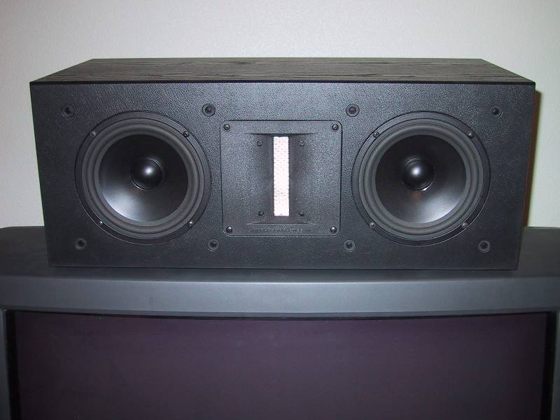

Apogee LCR
Η Apogee επίσης κατασκευασε ένα μεγάλο "LCR" ηχείο για χρήση ως Αριστερά, Κέντρικο, και δεξιό κανάλι σε ενα σύστημα home cinema. Μια καλή κατασκευή, η oποια ζυγιζε 40 λιβρες, το LCR της Apogee περιελάμβανε δύο 6 ½ ιντσών γούφερ σε μια διαμόρφωση D'Appolito γύρω από το 4 ιντσών ριμπον που ήταν περιστρεφομενο για χρήση είτε σε κατακόρυφη (κέντρο) ή οριζόντια (αριστερά ή δεξιά) τοποθέτηση.

Perseus.
Ο Perseus που παρουσιαστηκε το 1998, δεν ηταν τιποτα περισσοτερο, απο μια βελτιωμενη στα σημεια εκδοση του LCR.
Specifications
Height 24 inches
Width 9½ inches
Depth 11½ inches
Bass driver (2) 6.5" port loaded dynamic woofers
Midrange/tweeter 4" rotatable ribbon tweeter
Max Sound Level ~103db
Sensitivity @ 3m ~84dB
Frequency response 45Hz - 25kHz
Crossover frequency ~1kHz
Suggested amp power 100W (4 ohms)
Weight 40lbs each
Finishes available Black, veneer finish extra
Price (1996) $1000 Veneer finish $1100

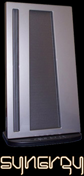

Synergy 1.5
To Synergy 1.5 δεν ειναι τιποτα αλλο παρα ενα Scintilla με βελτιωμενη ευαισθησια ωστε να μπορει να παιξει και με μικρους λαμπατους ενισχυτες οπως ισχυριζεται η εταιρια.
Specifications, in a typical ideal room (3000 cubic feet);-
Frequency response, full range 20hz-25+khz
Size on plinth 1.5m high, 0.45m deep, 0.9m width
Efficiency 95 db/w
Impedance 2.5 ohms
Ribbons Bass = LM
Midrange and TweetersSLW (Super Light Weight) foil
Crossover North Creek first order
Connections Passive and Active tri-connections
Partnering equipment from passive single amp to active triamp*,all steps in between available with no modifications. Amps can be 20-100w
Options XLM bass ribbons, Boccino Audio binding posts
Colours – any automotive colour on request*
amps must have less than 1mv dc offset and no turn-on/off transient noise
Pricing - subject to options, without crossover from $31,000USD, with crossover from $32,000USD
