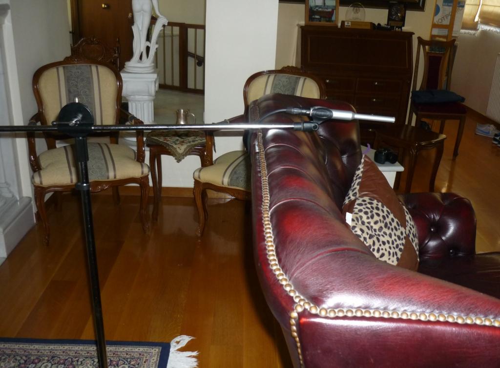

Μπορει!
Ο δερματινος καναπές εχει στα ακρα του γυριστή πλάτη έως το υψος του μικροφώνου.... xmmmmm....
Αν ήταν ο καναπές θα ήταν και στα 2 ηχεία...είπαμε, ο καναπές δημιουργεί τις 2 μεγάλες ανακλάσεις περίπου στο 1ms στην ΕΤC και των 2 ηχείων...
Τη γλύτωσε κι ο καναπές.... :D
Παντως ενω ειναι ομορφο το δερμα, ακουστικά (χωρίς πλάκα), το νοιωθω να πάλλεται στις μεσοχαμηλές, οταν ακουμπαω το χερι μου στο μπράτσο...

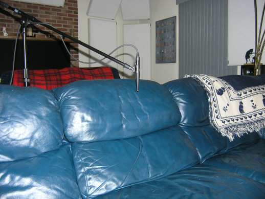

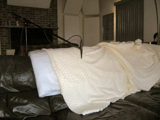

COUCH AND CHAIR REFLECTIONS
Even a reflective couch or chair back can cause severe comb filtering that damages clarity and spacial imaging. As a test, I measured my living room leather couch four ways - bare, with a thin blanket doubled up, with two-inch thick batting only, and with the batting plus a thick material called "Soft and Fluffy" that I bought at a local Jo-Ann Fabrics store.
The audible difference was substantial, though when measured the changes do not appear as large as they sound. Rather than post all four graphs showing small incremental improvements, the graph in Figure 2 at left shows the response four inches in front of the leather back when it's bare, and again with the batting and additional thick cover. This corresponds to the two setup photos at left.
I was surprised to see the response become a little worse at a few frequencies after adding the batting and cloth cover. So I measured again and got the exact same results. Such is the nature of reflections and comb filtering! But the sound is much better with the cover.
Even though it looks like the DPA measuring microphone in the photos is only half an inch in front of the couch back, that's just the camera angle and it's really about four inches away. Nothing was moved from one test to the next, so the improved response is due entirely to the addition of the batting and thick fabric cover.
