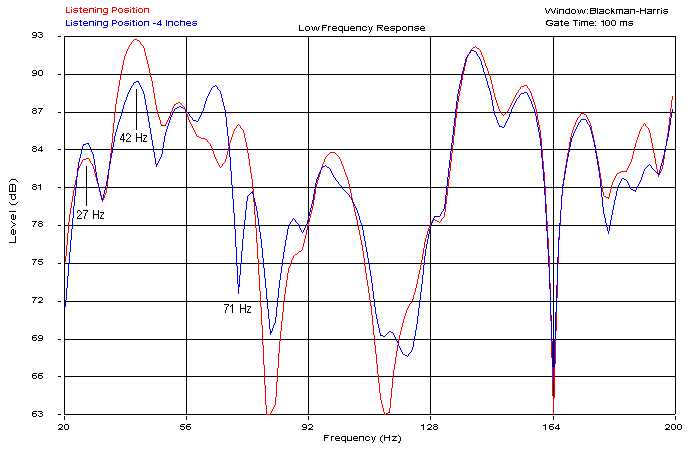

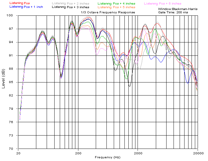

Αν ο τύπος τα λέει καλά, τότε δύσκολα τα πράγματα...:rolleyes:
http://ethanwiner.com/believe.html
Besides measuring the response at the listening position, I also measured at a location four inches away. This is less distance than the space between most adult's ears. At the time I was testing bass traps so I considered only the low frequency response, which showed a surprising change for such a small span.
Because of comb filtering, moving even a tiny distance changes the response by a very large amount at mid and high frequencies. Especially in small rooms having no acoustic treatment at the first reflection points. The response at any given cubic inch location in a room is the sum of the direct sound from the speakers plus many competing reflections arriving from many different directions. So unless you strap yourself into a chair and clamp your head in a vise, there's no way the sound will not change dramatically when you move even one inch.
Large variations in frequency response can also occur even in rooms that are well treated acoustically, though having bass traps greatly reduces the change at low frequencies. Figure 3 below shows the response I measured at seven locations one inch apart. These measurements were made in my rather large, well-treated home recording studio, not the same room as the graphs in Figures 1 and 2 above.
Since this graph shows seven curves at once, I used third octave averaging to show each response more clearly. Without averaging there is too much detail, making it difficult to see the "forest for the trees" so to speak. Besides a fair amount of bass trapping, the listening position in this room where the measurements were taken is mostly "reflection free," so variations in the response at higher frequencies are due mainly to things other than reflections from nearby boundaries. I verified this by looking at the impulse response - the two main reflections at 1 ms and 6 ms were down by about 14 and 16 dB respectively.

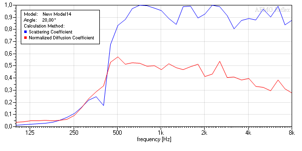

Λοιπόν, λογικά αφού κατασκευάστηκε το εργαλείο κοπής θα έχω μέσα στο ΣΚ έτοιμους 2-4 βηματικούς διαχύτες μεγέθους 120X80 έκαστος, υπολογισμένους με μέθοδο προσομοίωσης BEM (Boundary Element Method), βελτιστοποιημένους για διαφορετική κλίση ανά ζευγάρι για χρήση σε σημεία πρώτης ανάκλασης έκαστου ΟRION, η οποία ανάκλαση έχω προφανώς μετρήσει και μου χαλάει το ISD Gap που θέλω/μπορώ να πετύχω. Με την διάχυση αυτή προσπαθώ να διατηρήσω σχετικά την ενέργεια στον χώρο, αλλά να κατευθύνω την ενέργεια προς σημεία όπου από τις ανακλάσεις της μετά να έρθει σε μένα καθυστερημένη αρκετά msec μετά το ISD termination (που σε μένα δημιουργεί η ανάκλαση της πίσω ακτινοβολίας των orion) και διαχυμένη. Δεν ήθελα να χρησιμοποιήσω απορρόφηση ενώ θα ήταν πιο απλό για διάφορους λόγους εκτός του άνω.
Οι διαχύτες έχουν υπολογιστεί με στόχο να έχουν όσο πιο σταθερό Normalized Diffusion Coefficient στις πιο κρίσιμες συχνότητες μεταξύ 400-4000hz και η τιμή που έχω καταφέρει να φτάσω μετά από αρκετή προσπάθεια είναι αυτό να είναι μεταξύ 0,4-0,55 σε όλο αυτό το εύρος και μεταξύ 0,35-0,55 μεταξύ 350-7500khz, το οποίο γενικά θεωρείται πολύ καλό όπως καλό κρίνεται και το spatial response plot και σε υψηλό επίπεδο κινείται και το scattering coefficient που κινείται μεταξύ 0,8-1,0 σε όλες τις αντίστοιχες συχνότητες. Το δύσκολο που κατάφερα να συνδυάσω σε ένα βαθμό είναι η απόδοση τους και σε τυχαία γωνία καθώς και η απόδοσή τους μακριά στο λεγόμενο diffuse field. Δεν φαντάζεστε πώς αλλάζουν τα χαρακτηριστικά με μεταβολή της γωνίας...
Βέβαια καλό είναι οι διαχύτες να μετρώνται σε ομάδα των 4 πάνελς για να δεις πιο εύκολα πώς θα συμπεριφερθούν στη πράξη και εγώ δεν έχω αυτή τη δυνατότητα ακόμα, αλλά ας ελπίσουμε στη πράξη να μετρηθούν τα αποτελέσματά τους αναλόγως...αν όχι, δε πειράζει, θα ξαναπροσπαθήσουμε...άλλωστε είναι η πρώτη μου προσπάθεια σε άγνωστα νερά, καθώς δεν ανήκουν στους QRD κλπ διαχύτες. Tέλος του ΣΚ θα έχουμε τα νεότερα εκτός απροόπτου...

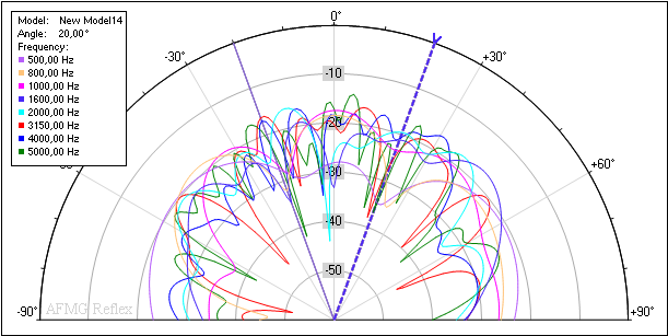

Μερικά διαγράμματα από την προσομείωση:

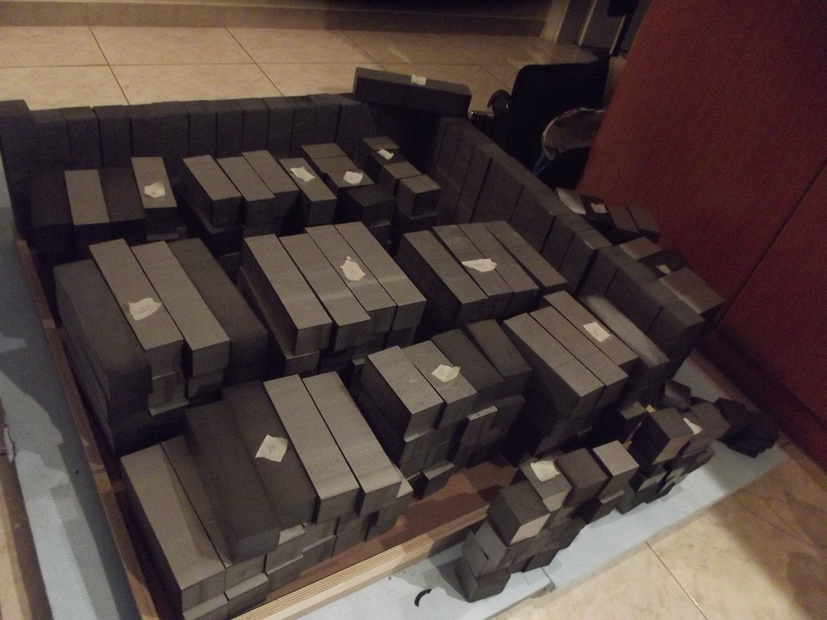

Δημήτρη ναι για οροφή πάνε, δύο θα είναι, 120Χ90 με μπλόκς από εξηλασμένη πολυστερίνη και πλάτη και πλαινά από κόντρα πλακέ 19mm και θα λειτουργούν θεωρητικά αρχίζοντας scattering από τα 380hz, μπαίνοντας σε διάχυση από 650-3,5khz και τελειώνοντας με scattering μέχρι τα 7khz περίπου. Όλο το βάρος είναι το ξύλο, το EPS υλικό είναι πολύ ελαφρύ. Κάνα 13-15 κιλά έκαστο να πάει υπολογίζω...τώρα υπάρχει και το ενδεχόμενο την επόμενη φορά να κάνω και την πλάτη από EPS, οπότε το βάρος δεν θα ξεπερνάει τα 4-5 κιλά...θα κολλάει όπου θες και με σελοτέιπ που λέει ο λόγος....απλά το ξύλο περιφεριακά το κάνει πιο γκλάμουρ...:p Σκέψου θα μπει και σε σαλόνι...

Μάνο τον περισσότερο καιρό τον πήρε για να κάνω τον σταθμό κοπής θερμαινόμενου σύρματος χρωμονικελίνης για να είναι απόλυτα ακριβής και ευθύς, κατά τα άλλα η κοπή είναι απλά βαρετή και φαίνεται ατελείωτη, αλλά σε 1-2 μέρες τελειώνεις...αλλά ναι όντως με παιδιά δεν....καταρχάς όταν κόβεται το EPS μυρίζει θάνατο....:o

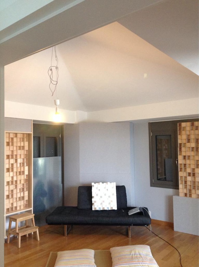

Εγώ πήρα έτοιμα, με μέγιστο βάθος 15εκ. Ειναι τα άσπρα στον καναπέ. Προορίζονται για την οροφή, από τη οποία έβγαλα την απορρόφηση η οποία μου είχε ρίξει πολύ την αντηχηση στις μεσαίες, χωρίς να κάνει ιδιαίτερη δουλειά στις χαμηλές.
Παρόλα αυτά δεν ξέρω αν θα τα βάλω. Θα προτιμούσα ξύλινα γιατί χωρίς να μπορώ να το τεκμηριώσεω τα ξύλινα μου ακούγονται καλύτερα, μου φτιάχνουν τις ...χροιες. Ίσως είμαι επηρεασμένος και από το γεγονός ότι στα πιο μεγάλα projects ακουστικής χρησιμοποιείται ξύλο στις τελικές επιφάνειες.
Πείτε καμία άλλη ιδέα για διαχυςη για αυτή την περίεργη οροφή. Σκέφτομαι να εκμεταλλευτώ το μεταβλητό ύψος και να κάνω μια κατασκευή τύπου diffractal. Αλέξανδρε, βάλε με στο προγράμματα για επίσκεψη, θέλω τη γνώμη σου οπωσδήποτε ! Μη φοβάται, δε θα σε βάλω να τα φτιάξεις εσύ ;-)

Αν θες κατασκευή τύπου difractal και σχετικά απλή για χομπίστα, optimized και αυτά μέσω ΒΟΜ και φτιαγμένα από κόσμο που λέει ότι λειτουργούν καλά, πες μου να σου στείλω σχέδια. Τώρα,όσον αφορά ξύλο Vs eps, να ξέρεις υπάρχουν μετρήσεις που αποδυκνείουν ότι eps σχετικής πυκνότητας και βαμένα, έχουν ίδιο συντελεστή απορρόφησης με το ξύλο, συνεπώς ανακλούν το ίδιο, συνεπώς οφείλουν να έχουν ίδια συμπεριφορά. Τα QRD που πήρες τα ξέρω, της RPG δεν είναι που είναι και σχετικά φθηνά? Απλά ξεκινάν να λειτουργούν πιο ψηλά από αυτά που φτιάχνω εγώ λόγω μικρότερου βάθους. Αν θες να σου φτιάξω κάτι με την καινούρια μέθοδο δεν υπάρχει πρόβλημα, πες μου.

Εγώ φτιάξει διαχύτη 1.80χ2.40 με eps και δουλεύει μια χαρά. Τα ξύλινα είναι θεόβαρα, απίστευτα ταλαίπωρα στο να κόψεις τόσα κομμάτια και επικίνδυνα !!! ...λόγω βάρους. Απλά φρόντισε τα eps όπως λέει και ο Αλέξανδρος να είναι σχετικά υψηλής πυκνότητας (σκληρούτσικα δηλ).

OK, EPS λοπόν. Κανονικό diffractal δεν νομίζω ότι έχω τον χώρο να φτιάξω. Η κεκλιμένη οροφή είναι 3.6μ επί 3.6μ με διαφορά ύψους 70εκ από κορυφή μέχρι τη βάση της (εκεί που αρχίζει το δοκάρι).
Μία ιδέα είναι να βάλω τα ρηχά που έχω πάρει περιφερειακά (εκεί που δεν έχω βάθος) και όσο πηγαίνω προς το κέντρο, να βάλω πιο βαθιά.
Η ιδέα του Γιάννη για κρεμαστά hofa στην οροφή επίσης παίζει αλλά με τρώει για κάτι με μεγαλύτερο βάθος για να κατεβαίνει πιο χαμηλά. Αν υπήρχε hofa 30εκ!!!
