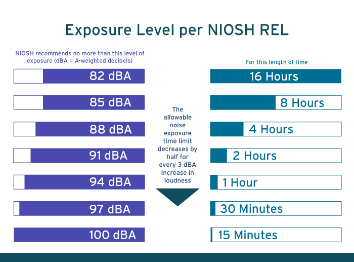

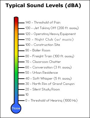

Σχετικά με τις μετρήσεις για την προστασία της ακοής, από επίσημο φορέα της Γερμανίας
In order to be able to correctly evaluate high sound levels, the so-called C rating used. The peak level is therefore given in dB(C).
Από επίσημο φορέα του Βελγίου
The letters A, C and G refer to the correction (weighing) which is applied to sound values of different frequencies.
In most cases the A weighing is applied. The sound volume is then rendered in dB(A). This weighing corresponds most closely to our ear’s sensitivity for sound: the low and high frequencies are not heard equally well. The sound value in dB(A) is representative for hearing damage in the long term.
The curve of the C filter is flatter. In this weighing the low sound frequencies receive relatively more weight, in comparison to the curve of the A filter (you see in the diagram that the green curve lies higher than the red curve with the lower frequencies). Therefore, the sound level in dB(C) is more suitable (better than the dB(A) value) for the assessment of the specific nuisance due to bass sounds at musical events.
With the G weighing one particularly takes into account the infrasound frequencies between 10 and 20 Hz, whereas lower and higher sound frequencies are left out. Sound values in dB(G) are sometimes used with the specific assessment of nuisance from infrasound, e.g. from wind turbines.
Sometimes no correction is applied, and only the pure sound pressure is measured (for ultrasound, infrasound). In case of measuring without weighing, one refers to just dB or dBZ (dB without filter).

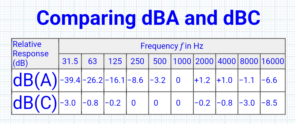

Η μετατροπή των 100 dB SPL στους 20 κύκλους σε dBA είναι -50,4dB, και σε dBC είναι -6,2 dB.
Να κι ένας πίνακας μετατροπής dB SPL σε dB(A) και dB(C):
Υπ'οψιν:
0 dBA είναι η ουδός ακοής.
130 dBA είναι η ουδός του πόνου.
130 dBA στους 20 κύκλους είναι 180,4 dB SPL.
130 dBA στους 31,5 κύκλους είναι 169,4 dB SPL.
130 dBA στον 1 χιλιοκυκλο είναι 130 dB SPL..
Πάντα σε dB(A).
Τα οποία dB(A) αποτελούν μαθηματική έκφραση των Φον.

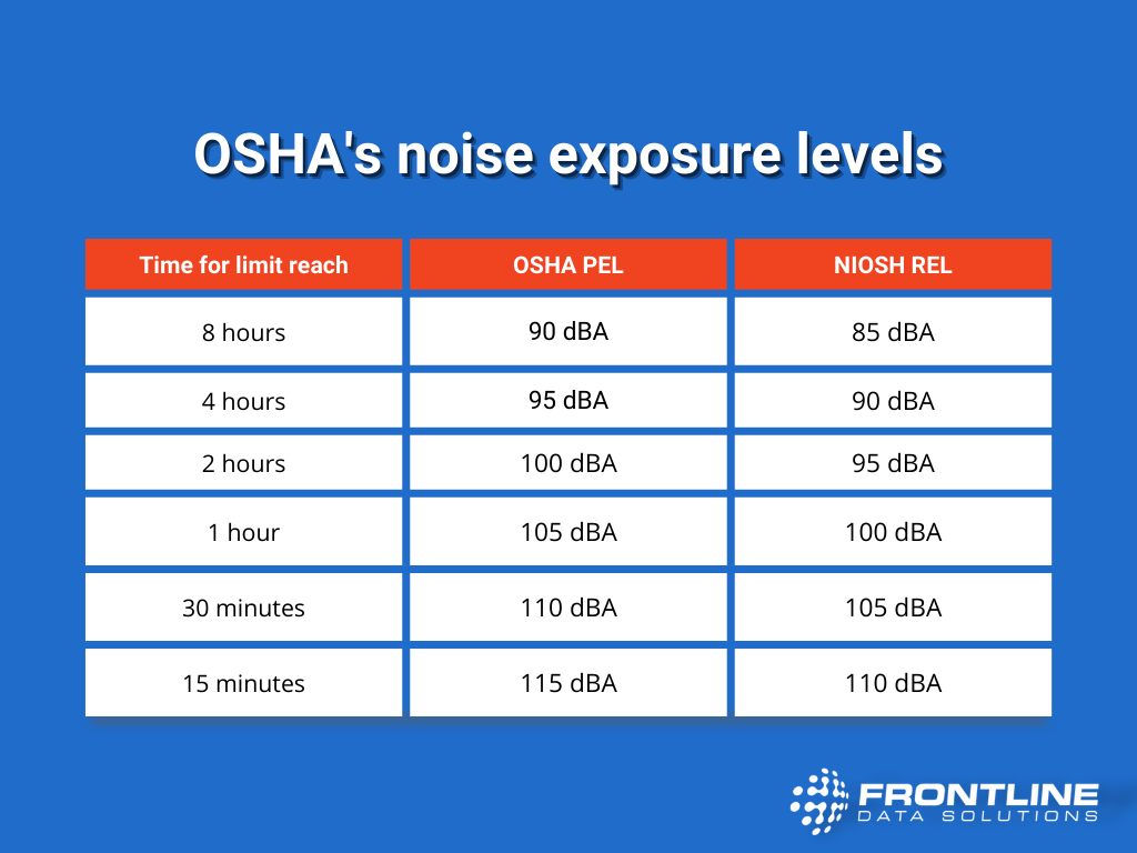

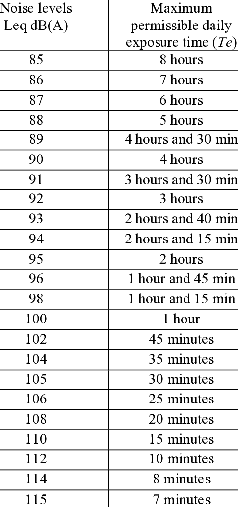

Όλοι οι πίνακες που κατά καιρούς έχετε δει και επικαλείστε για ασφάλεια στην έκθεση θορύβου, από όλους τους διεθνείς οργανισμούς, είναι dB(A).
Πάντα dB(A).
Αλλά αυτά είναι για θόρυβο σε περιβάλλον εργασίας, και γι αυτόν τον λόγο είναι Α.
Αν όμως μετρήσετε σε A weighting ένα μουσικό κομμάτι ας πούμε στα 70dB, σε C μπορεί να σας βγαίνει η μέτρηση πολλά dB πάνω, διότι όπως είδατε στα πιο πάνω διαγράμματα, εκεί που είναι οι στάθμες στην μουσική το A weighting δεν μετράει τίποτα.

Το dB(C) καλό είναι να θυμάστε πως έχει -6,2dB στους 20 κύκλους και -8,5 dB στους 20 χιλιοκυκλους.
H χωρίς φίλτρο μέτρηση σε dB SPL (ή dBZ) είναι ιδανική για εφαρμογή κλίσης στην target curve.
Mια ευθεία ταργκετ κερβ σε dBC ισοδυναμεί στα πρίμα με μια νορμάλ κλίσης ταργκετ κερβ σε dB SPL (8,5 dB πτώση) αλλά ενσωματώνει και συνολική πτώση 6,2 dB στους 20 κύκλους.

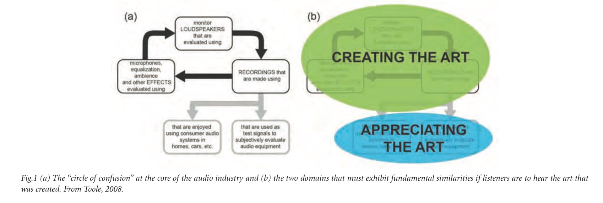

Τι λε ρε φίλε;
Θα καθόμαστε εμείς να διαβάζουμε με τις ώρες, και θα σας γράφουμε σε μια παράγραφο συμπυκνωμένα βιβλία; Δωρεάν; Και δεν θα τα μαθαίνετε και θα τρολάρετε κι από πάνω ως ξερόλες;
:lolsign:
Όλα αυτά που ρωτάς έχουν γραφτεί επανειλλημένως. Εγώ προσωπικά θέλω 800€ φιλική τιμή (με απόδειξη φυσικά) για να τα ξαναγράψω.
Δωρεάν μπορώ αν θες να σου απαντήσω τι να γκουγκλάρεις ως προς τα 1-6 που ρωτάς:
The circle of confusion.
Όλα τα υπόλοιπα είναι με χρέωση.

Βλεπωντας τα διαγραμματα για το Α weight , C weight , Z weight , το Α εχει την πιο αποτομη κλιση καθως οδευουμε προς τη χαμηλοτερες συχνοτητες γιατι η ακοη μας γινεται αναισθητη. Το C εχει πολυ μικροτερη και το Ζ μηδενικη. Εαν η ευαισθησια του αυτιου μας εχει τον ιδιο ρυθμο μεταβολης (παραγωγο,κλιση κλπ) αναλογως τη συχνοτητας και η ενταση του ηχου δεν μεταβαλει (ειναι ανεξαρτητη) αυτη την ευαισθησια τοτε ναι η dbA ειναι η πιο σωστη. Εγω δε το ξερω, αλλα για να το λεει ο ψαγμενος γιατρος μαλλον κατι ξερει. Ισως η C τελικα να ειναι ενα ημιμετρο.

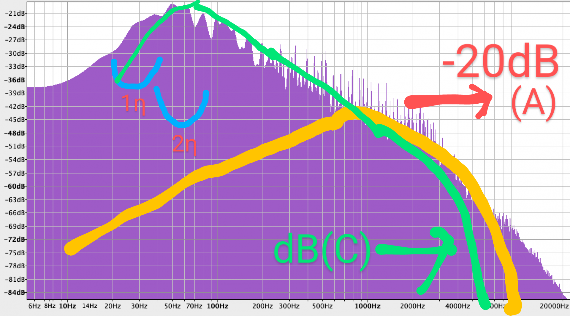

Οι μετρήσεις που αναφέρονται σε συστήματα αναπαραγωγής ήχου είναι πάντα dB(C).
Σωστά.
Ας πάρουμε αυτό το μουσικό τεμάχιο:
Βλέπουμε πως η μεγαλύτερη στάθμη βρίσκεται στη 2η οκτάβα, και ακολουθεί η 1η οκτάβα, μετά η 3η οκτάβα.
Μια dB SPL μέτρηση, θα μας δείξει όλο αυτό που βλέπουμε σε μωβ, δε κόβει τίποτα.
Ας θεωρήσουμε πως μετράμε 105 dB SPL με το μικρόφωνο, προφανώς αυτό θα αντιστοιχεί στους 50 κύκλους.
Λέμε πως ακούμε στα 105 dB SPL.
Την ίδια στιγμή, η SPL στάθμη στον 1 χιλιοκυκλο θα είναι 85 dB SPL.
Μια μέτρηση με μικρόφωνο σε dΒ(C) θα μας δείξει ίδια στάθμη, 105 dBC. Αντιστοιχεί στην πράσινη γραμμή.
Μια μέτρηση με μικρόφωνο σε dΒ(Α) θα μας δείξει 85 dBΑ. Αντιστοιχεί στην κίτρινη γραμμή.
Δηλαδή, ακούω μουσική σε στάθμη 105 dB SPL ή 105 dB (C), που αντιστοιχεί σε στάθμη 85 dB(A) ή σε στάθμη ισοδύναμης ακουστοτητας 85 Φον.
Στα 85 Φον, ακούμε ξεκούραστα και χωρίς κίνδυνο υγείας της ακοής μας, για 8 ώρες.
Πρακτικά, οι στιγμιαίες κορυφές της στάθμης αναφοράς (105 dBC) αντιστοιχούν σε 85 Φον.
Στάθμες αναφοράς, με φλατ απόκριση του σεταπ, ακούμε χωρίς προβλήματα για την ακοή μας, για ένα 8-ωρο.
Είναι .."χαλαρές".
ΥΓ. Εφαρμόζοντας δε, ένα τυπικό ταργκετ κερβ με συνολική κλίση 10 dB, κατεβάζουμε ακόμα 5 dB(A) την αντιληπτή στάθμη, και από τα 85 dB(A) πάμε στα 80 dB(A) όταν μετράμε με το μικρόφωνο μέγιστη στάθμη 105 dB(C) ή 105 dB SPL.

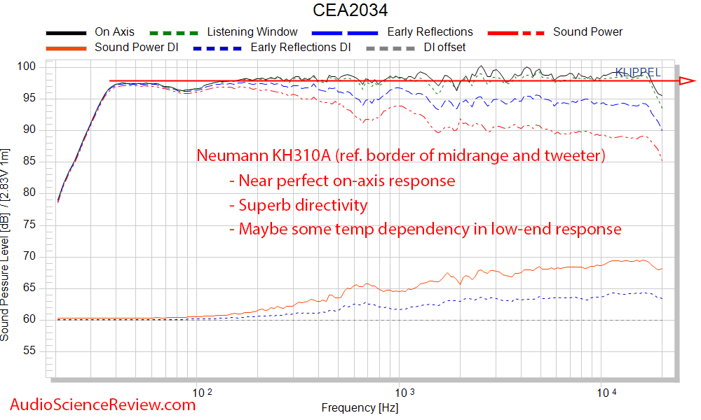

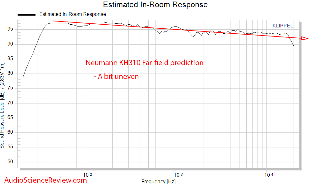

Ένα ηχείο (δορυφόρος) που παίζει φλατ στην on axis (free field ή ανηχοϊκή μέτρηση) με σοβαρό σπινοραμα:
Έχει προβλεπόμενη in room απόκριση με κλίση:
Η κλίση αυτή, στο συχνοτικό εύρος που του αναλογεί του δορυφόρου, είναι χονδρικά 5-6 dB.
Συν 2 dB στις πρώτες 2 οκτάβες (κατά την αρχή της κλίσης 1dB/Oct) μας δίνει συνολική κλίση ~7-8 dB μέσα στο χώρο ακρόασης.
Πρακτικά, ένα τέτοιο σοβαρό ηχείο, δεν χρειάζεται ουσιαστική εφαρμογή target curve, ή εάν χρειάζεται, είναι λίγο, ώστε από τα 7-8dB της φυσιολογικής του κλίσης, να πάει στα 9-10 dB στο σύνολο του ακουστού φάσματος.
Φυσικά, η in room response εξαρτάται από το δωμάτιο, και επειδή δωμάτιο από δωμάτιο έχουν διαφορές (που φαίνονται στο γράφημα RT 60 αλλά και από την απόσταση τοποθέτησης από τα τοιχωματικα όρια) είναι λογικό και αναμενόμενο η τελική in room response στο χώρο μας να μην είναι επακριβώς η αναμενόμενη, οπότε λίγη "βοήθεια" με dsp ώστε να επιτευχθεί η αναμενόμενη, είναι καλοδεχούμενη.
Μελετήστε τώρα την αναμενόμενη in room response από κορυφαία μόνιτορ, ξεκινώντας από τα τζενελεκ που μέτρησε ο Αμιρ.
Μετά, κάντε σύγκριση αυτών των κορυφαίων in room response που θα δείτε, με την μετρήσιμη in room response του δικού σας σεταπ, και θα βρείτε το λάθος.
Η διόρθωση αυτού του σφάλματος, ονομάζεται room correction ή εφαρμογή ταργκετ κερβ.
