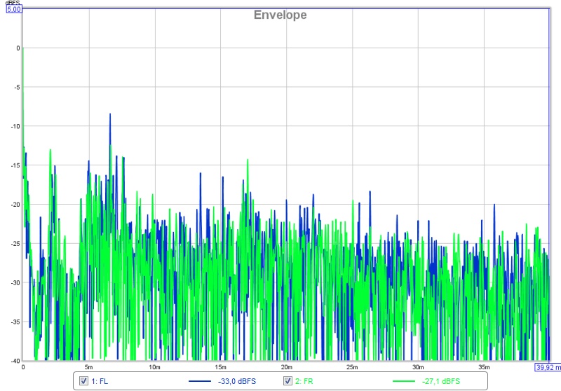

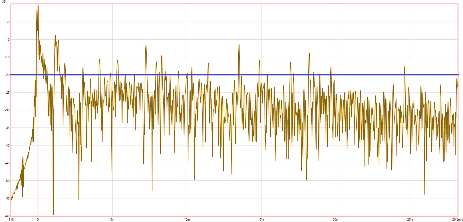

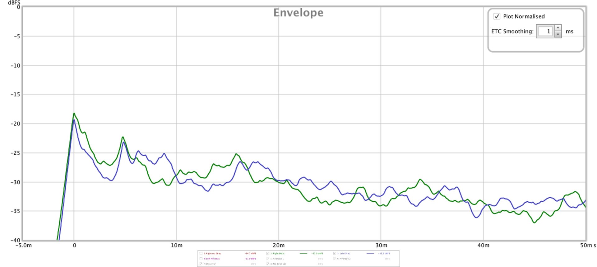

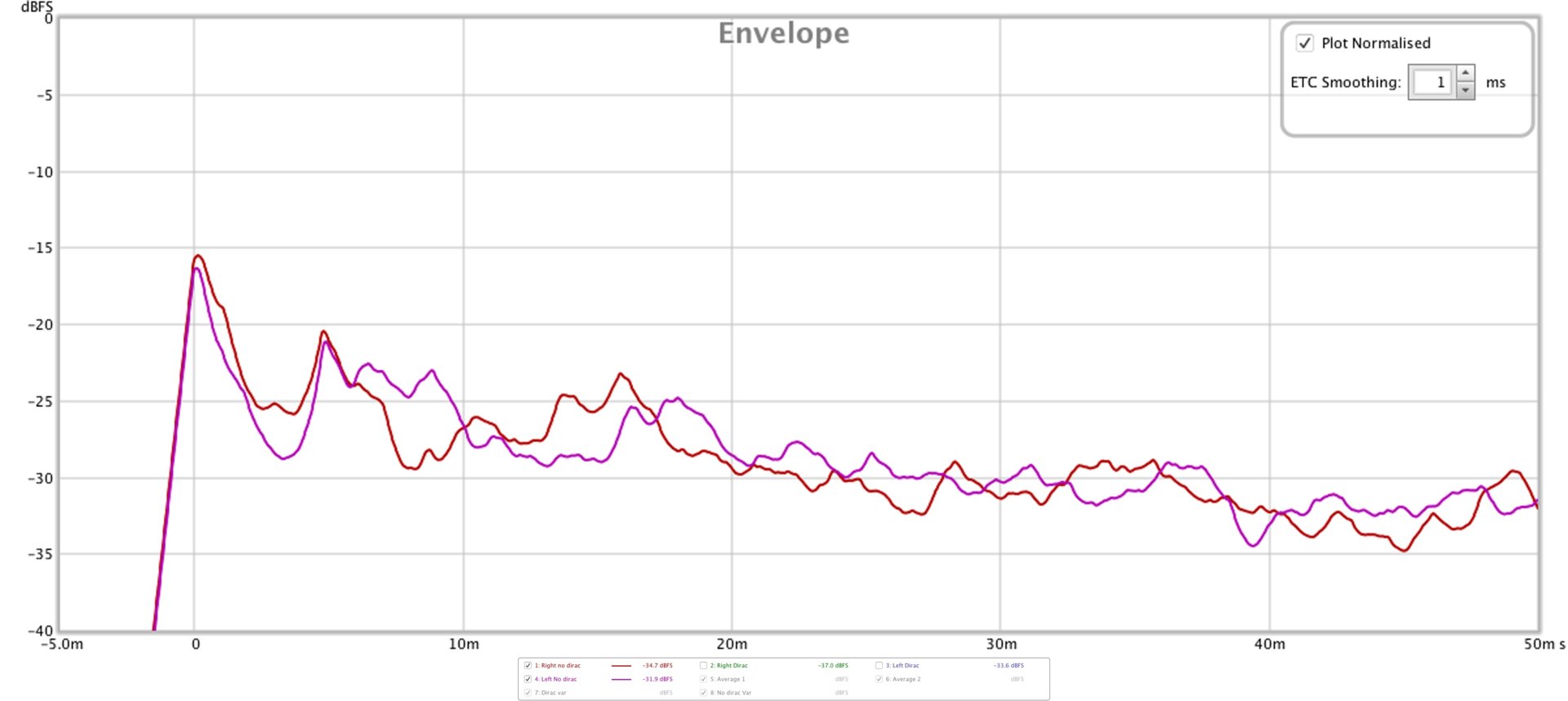

δεν ξεκινανε απο -5 οι ανακλασεις....σε μπερδεψε η etc smoothing 0.1
γιατρε μου βαλε στην etc αντι για 0.1 καντο 1 και βαλε να δουμε....

να βαζεις ιδια κλιμακα για να κανεις συγκριση για ιδιο γραφημα

https://de.wikipedia.org/wiki/Energy_Time_Curve
να δεις αυτη στα 5ms(1,7μ) που ειναι δυνατη και για τα 2 ηχεια.
Το λινκ σου ειναι στα Γερμανικα >:(>:(>:(
ΟΚ, θα το ψαξω και αυτο. Thanks for the tip :)
Για αυτό υπάρχει το google translate (μεταξύ άλλων):):
"The Energy Time Curve (also called Envelope), abbreviated as ETC, is used in room acoustics to evaluate the relationship between the direct sound and diffused sound. To measure the ETC, the sound pressure level (in dB) is plotted against time (in ms). This results in a curve representing the reverberation of an impulse at the measuring position over time.
The highest high points of the resulting curve correspond to the largest sound pressure levels and thus each of a strong early reflection. Based on the time at which a certain high point occurs, the delay time difference of this reflected signal relative to the output signal can be calculated. This allows the identification of the source of the reflection. By doing this, all sources of strong early reflections can be determined. In rooms that are used for loudspeaker reproduction, the amplitude of the reflection signals from the output signal should be at least 20dB (equivalent to the blue line in the adjacent diagram) lower. This can be ensured that the reflections that occur do not adversely affect the sound. This can be achieved with the damping of the detected reflection sources.
5.470
6.640
H μετρηση της etc ειναι αχρηστη ετσι οπως εγινε δε λεει τιποτε , η δε λεει τιποτε παραπανω απο αυτο που βλεπουν τα ματια σου στο χωρο...

Επιθυμητοί στόχοι στο etc
  1. Be visually identical (with only minor deviations) from 0-40 ms
  2. Show that the peaks are down to at least -10 dB by 40 ms to prevent breakdown of the precedence effect
  3. Clearly show a decrease in the amplitude of energy over 0-40 ms. The decay pattern may or may not be continuous (**).
  4. Show the consecutive peaks of the highest amplitude reflections viewed across the time axis to be relatively smooth in pattern and density.
Και μένα μου φαινονται προβλέψιμα τα αποτελέσματα κοιτώντας τον χώρο.
Έτσι δεν συμβαίνει συνήθως με το etc:
Τι λένε οι πιο εμπειροι;

(Εννοώ: μηπως ειναι άχρηστη μέτρηση ως πληροφορία; Δεν προσφέρει κατι παραπανω απο όσα φαίνονται με το μάτι. )

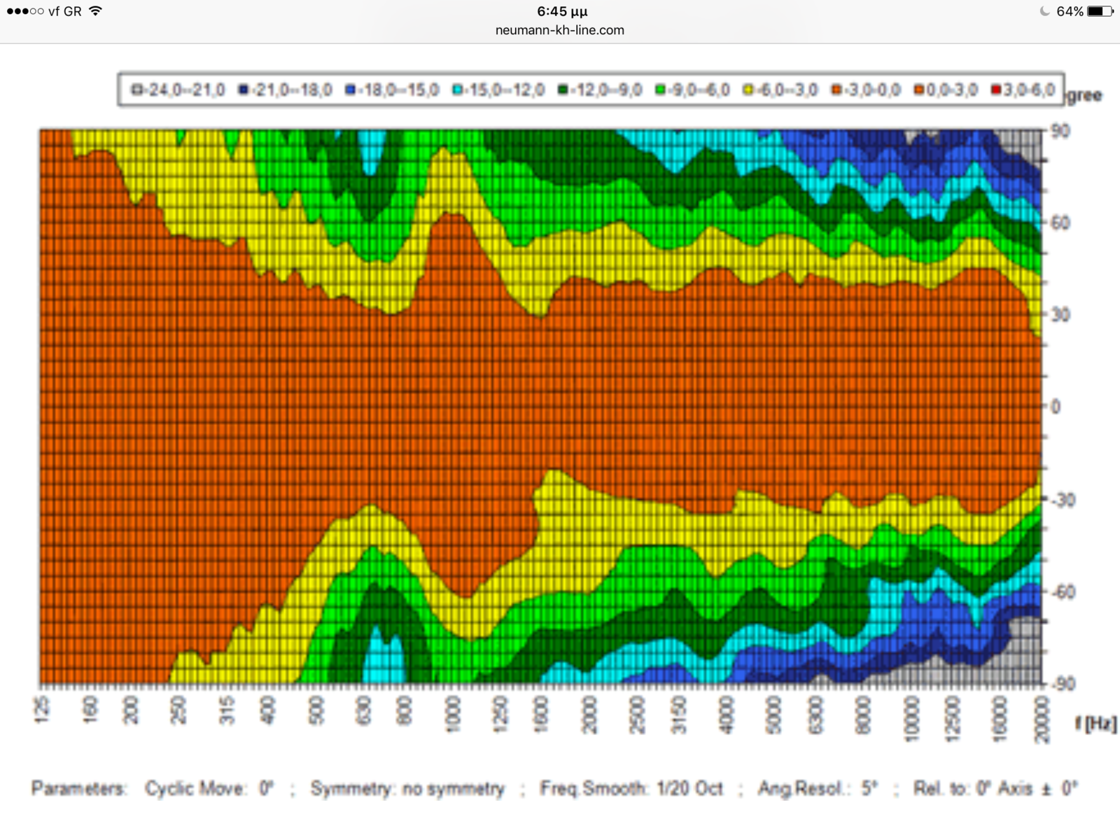

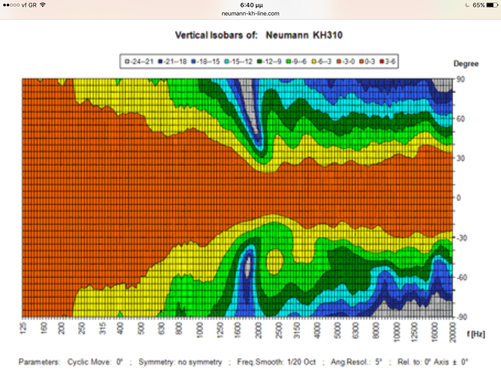

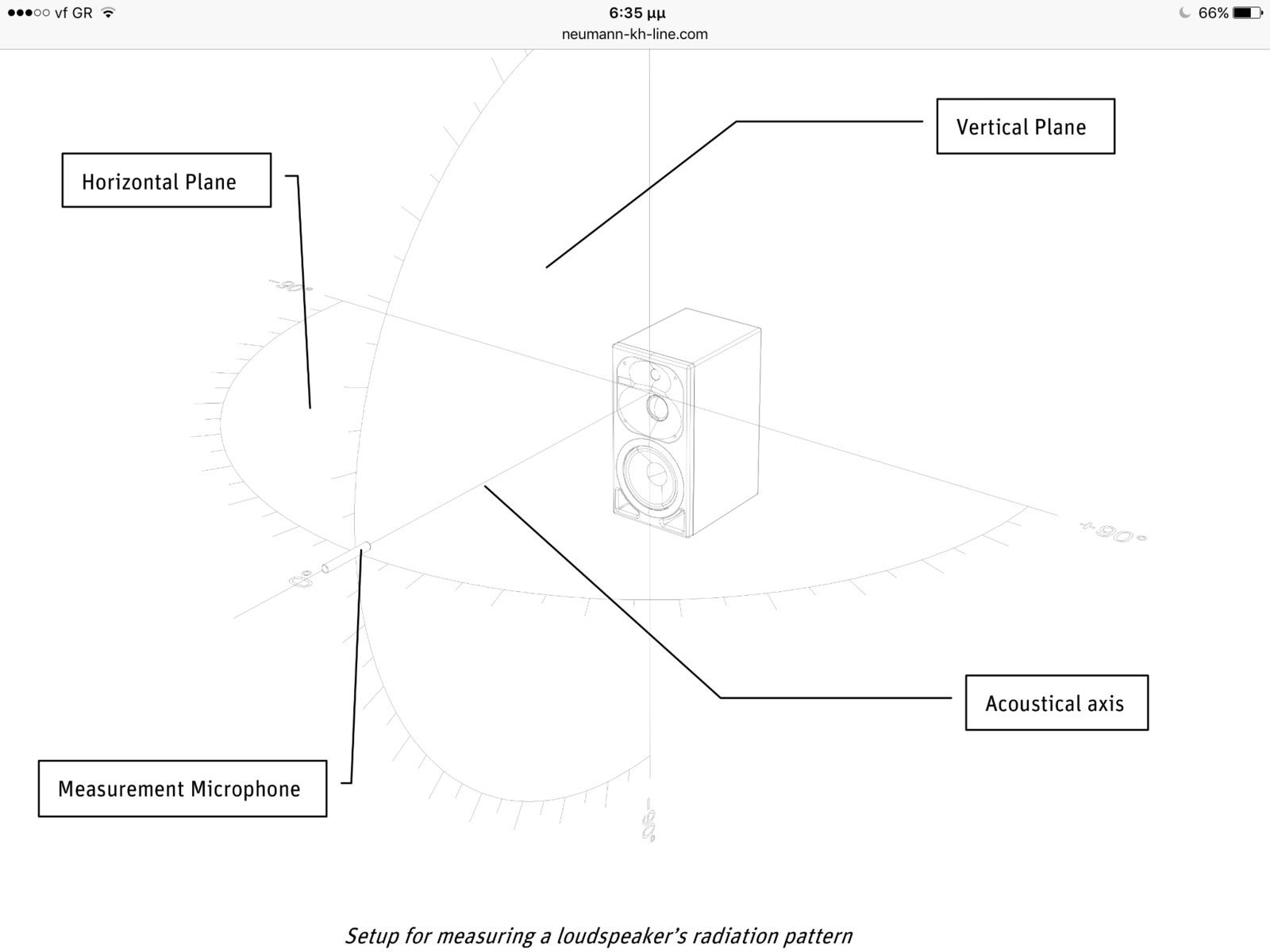

Αν εννοείς ηχεία για οριζόντια τοποθετηση, αυτά εχουν περιορισμένη ακτινοβολία στον οριζόντιο άξονα και μεγαλη γωνία ακτινοβολίας στον κάθετο. Δηλαδή το αντίθετο απο τα ηχεία που έχεις τώρα.
Μπερδευτήκαμε λίγο με το οριζόντιο και κάθετο.
Εννοώ αυτο
Και αυτο
Που ειναι μικρότερο απο αυτο
Τρεις εικόνες, χίλιες λέξεις.
