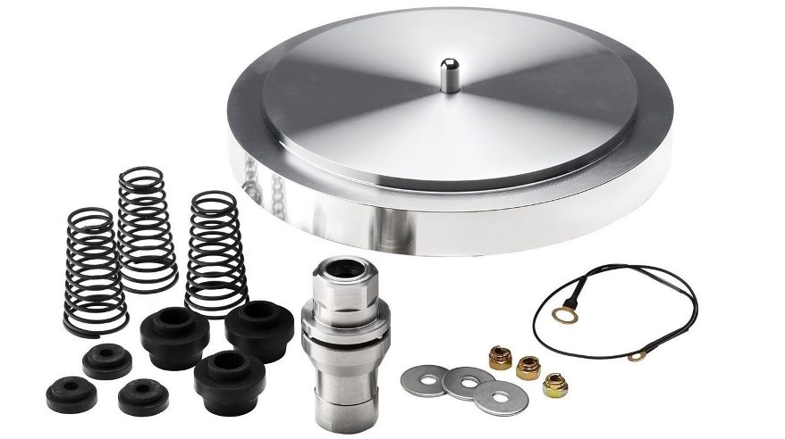

Linn Karousel LP12 Nέο έδρανο για Sondek
η Linn αναφέρει ότι το Karousel θα βελτιώσει την απόδοση κάθε πικάπ Sondek LP12 αφού είναι καθοριστικής σημασίας για τη σταθερότητα του πικάπ. Το Karousel προσφέρει πιο σταθερή και ακριβή κίνηση, επιτρέποντάς σας να έχετε ακόμα καλύτερο ήχο
Σύμφωνα με την Linn ο αναβαθμισμένος σχεδιασμός του Karousel LP12 κατέστη εφικτός χάρη σε μια σημαντική εφεύρεση στον τομέα της επιστήμης των υλικών και της μηχανουργικής κατεργασίας καθώς και χάρη στην εμπειρία της εταιρίας για σχεδόν μισό αιώνα σχεδίασης και κατασκευής πικάπ
Karousel, Linn’s new precision-engineered single-point bearing, offers smoother rotation and greater stability for even better sound from your Sondek LP12.
This innovative new take on our original bearing design has been made possible by technological developments in material science, machining capabilities and mechanical engineering expertise gained from almost half a century of designing and manufacturing the world’s best turntable. That vital union between the platter, spindle, bearing and sub-chassis is now the strongest we’ve ever achieved.
A new diamond-like carbon coating inside the bearing reduces friction between the tip of the spindle and the base of the bearing itself. This reduces the ‘noise floor’ of the turntable, so improves musical reproduction.
The substantial lock-nut fastening on the stainless steel housing increases rigidity at the critical point where bearing and sub-chassis come together. Enhancements to the base of the bearing include a stronger housing for the thrust pad, combined with a smaller, stiffer coated form, to improve the critical area that supports the platter rotation and mass, meaning your vinyl reproduction is more accurate and detailed than ever before.
With Karousel the reduction in friction means that not only will this critical component have a greater lifespan, but your LP12 will continue to give you incredibly accurate listening pleasure for longer than ever before.

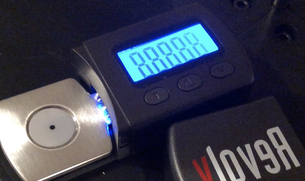

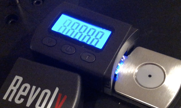

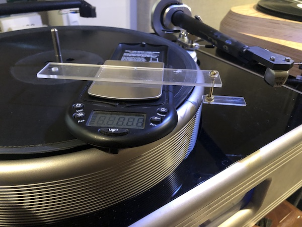

Beware Magnetized Stylus Pressure Gauges!
There's a magnetic reaction between the cartridge and the scale! Granted the Anna D and some other costly MC cartridges have seriously powerful magnets and so magnify this problem, if you have a gauge of this kind with any brand label on it, be sure to check out the interaction between the cartridge and the gauge as seen below.

After watching the video showing the Revolv VTF gauge react to the Anna D stylus, SAT's Marc Gomez sent me this analysis:
"Looking at your video of the scale reacting to the Anna I feel compelled to comment. I believe the metal platform is aluminum and non-magnetic. Nevertheless, as the magnet of the Anna is very strong, the movement (velocity) of the magnet getting closer or away from the aluminum platform creates electromagnetic induction in the platform - pushing it down when getting closer and pulling it up when moving away (negative reading in scale). It only happens when you have relative velocity between the magnet and the conductive part (Lenz law). It is not due to the magnetic attraction. It will not affect the correct reading of static VTF once the stylus rests on the platform."
He added: "The reading of 2,6-2,7g in the Revolv scale compared to the 2,4g in your scale is due to the higher position of the platform on the Revolv, which makes the arm exert a bit more VTF as stated on the instructions."
I think what he posits makes sense. More than do I sometimes......

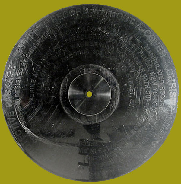

I had filed away my memory of Record Without a Cover in a brain-slot adjacent to Gary Dahl's pet rock and The Nothing Book, the wordless bestseller from 1974
Side A of Record Without a Cover features what sounds like several record players playing at the same time—just surface noise first, gradually increasing, then a slow crescendo of chaotic music and sounds. The B side has no grooves, just words written in a spiral, including the etched admonition to not store the record in a protective package. The goal is precisely to let it get scuffed and dirty so that the sound changes over time

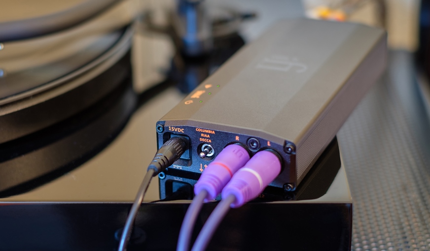

νέο phono από ifi
60.859
147.716
νέο phono από ifi
Εξαιρετικό φαίνεται!
Μπράβο τους!
60.859
147.716
μην κοροϊδεύεις...:laugh:
Καθόλου δε κοροϊδεύω, δείχνει φανταστικό.
Τρομερές δυνατότητες πραγματικά.
Και το δυναμικό εύρος στα 85 ντεσιμπέλ, εξαιρετικό (για το είδος του).

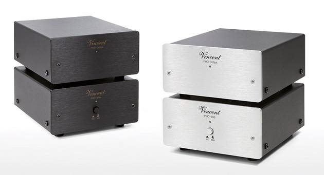

«Η Γερμανική Vincent Audio ξέρει να σοκάρει την αγορά. Για τους λάτρεις του βινυλίου όπου πάντα ήθελαν το καλύτερο στην κατηγορία των οικονομικών audiophile προτάσεων, ιδού μια κορυφή στην παγκόσμια αγορά σε σχέση τιμιότητας ως προς απόδοσης. Με κόστος μόλις 300 ευρώ, το νέο Vincent MM/MC Phono Stage της σειράς PowerLine μοντέλο PHO-300 (προενισχυτής κεφαλής πικάπ) είναι δικό σας, μάλιστα με εξωτερικό τροφοδοτικό που περιλαμβάνεται και αυτό στην τιμή»

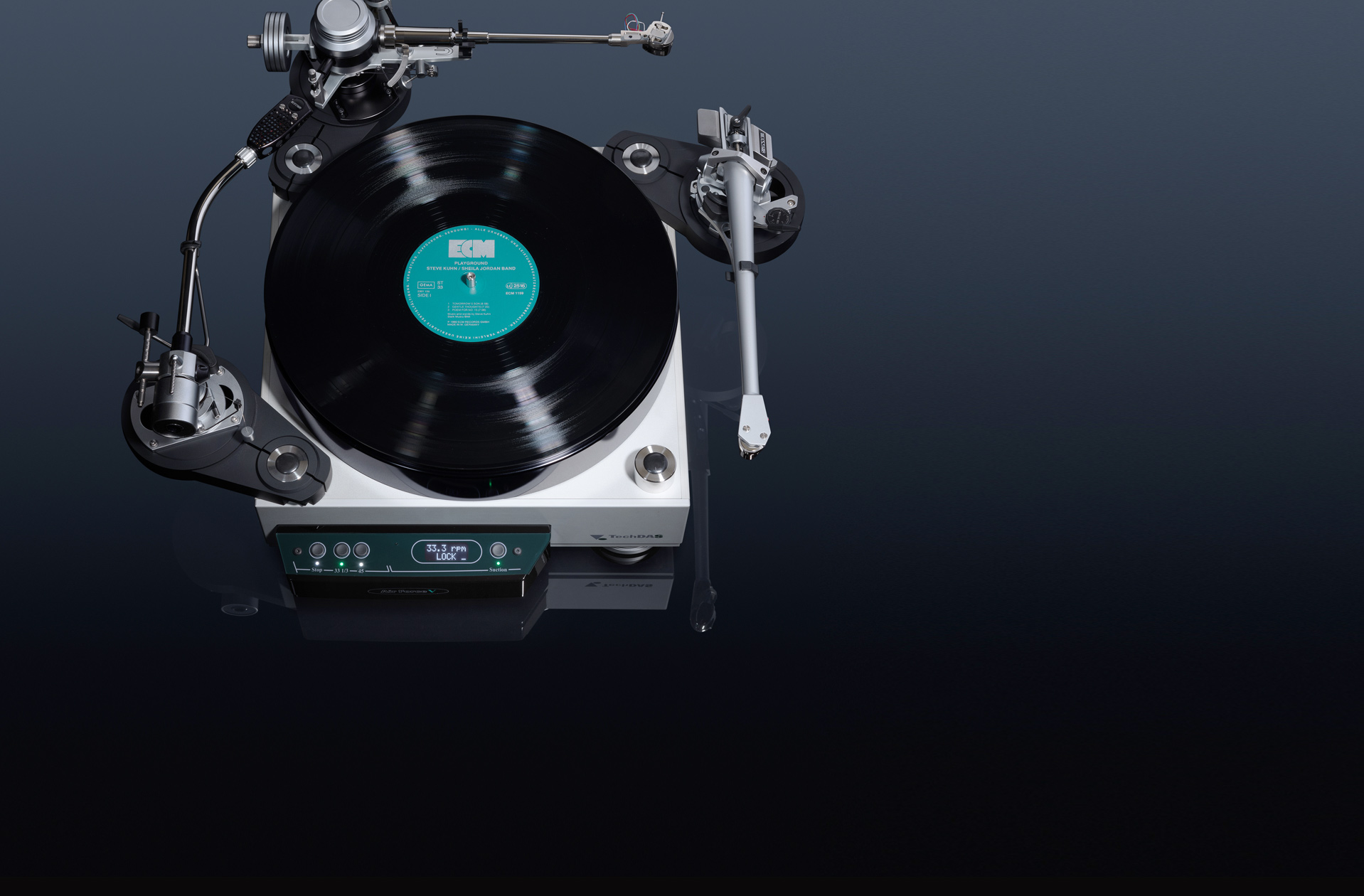

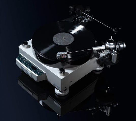

TechDAS Air Force V Premium
Μοιάζει πολύ με το προηγούμενο μοντέλο, αλλά υπάρχουν σημαντικές διαφορές.
Δηλαδή έχουμε και εδώ ανάρτηση αέρα και σύστημα «συγκράτησης και σύσφιξης» του δίσκου στο πλατό με αντλία κενού. Η κύρια διαφορά του νέου πικάπ έχει να κάνει με την κατασκευή που τοποθετείται ο δίσκος. Η βάση είναι από μασίφ αλουμίνιο τύπου 5052 βάρους 19 κιλών.
Το εσωτερικό πλατό είναι από μαύρο αλουμίνιο βάρους 4 κιλών και στο εξωτερικό πλατό από ασημί αλουμίτη βάρους 3 κιλών. Δηλαδή το πλατό ζυγίζει 7 κιλά. Αυτό αύξησε το βάρος της στα σε 26 κιλά (η κανονική έκδοση ζυγίζει 18 κιλά) στο οποίο πρέπει να προσθέσουμε άλλα 9 κιλά που ζυγίζει η αντλία αέρα. Η ροπή αδράνειας της συσκευής φτάνει τα 734 kg / cm², ενώ η απόκλιση από την ταχύτητα περιστροφής δεν υπερβαίνει το 0,03%.
Η κίνηση γίνεται με ιμάντα διπλής όψης, ο κινητήρας είναι AC τετραπολικός που ελέγχεται με ψηφιακό τρόπο για ακρίβεια των στροφών. Ο σύγχρονος αυτός κινητήρας είναι τοποθετημένος στο σασί μέσω ενός βελτιστοποιημένου συστήματος κατά των κραδασμών
MAIN UNIT & MOTOR
Chassis​
Aluminum (A5052) / Super duralmin (A7075) assembly Satin silver anodized finish​
Weight​
11 kg​
Platter (main and sub platters):​
Precision machined aluminum (A5056).
Black anodized and high gloss polished.​
Platter Weight​
6.7 kg​
Total moment of inertia​
734 kg・cm2​
Drive System​
Sub-platter belt drive​
Motor​
AC synchronous motor built in the main chassis​
Rotation speed​
33.3 rpm / 45 rpm​
Wow & Flutter​
below 0.03 %​
Dimensions​
312 (W) x 168 (H) x 368 (D) mm​
Minimum Dimensions for setting up​
413 (W) x 418 (D) mm​
Total Weight​
18 kg​
PUMP / POWER SUPPLY/ AIR CONDENSER UNIT
Power consumption50 W
Dimensions350 (W) x 160 (H) x 270 (D) mm
Weight9 kg
Minimum depth for setting up330 (D) mm
ACCESSORIES
ACCESSORIES SUPPLIEDTonearm base x 1 (drilled for specified tonearm).
An extra cost may be required according to the tonearm.
Platter Cover x 1.
Cables, Air hoses, Platter setup tools, Users manuals.
OPTIONAL ITEMS & ACCESSORIESExtra tonearm base.
Disc Stabilizer.
