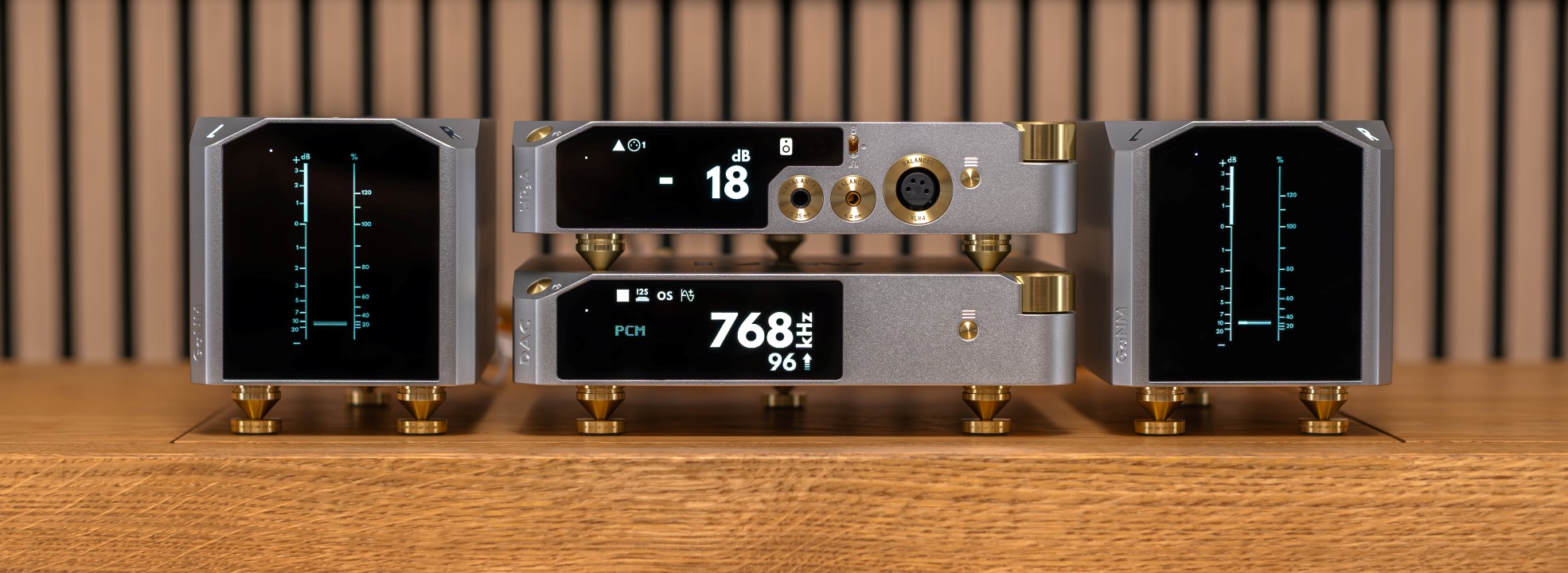

Reading all those HiFi magazines for years, I still hold some preconceptions, though now, they’re only seeds of skepticism. I have a small dose of doubt, especially when it comes to monoblocks that fit in the palm of your hand. I’ve tried a few small power amplifiers before, but they were never truly impressive. I wouldn’t recommend them to my peers, and even to my close friends. My colleague, Catalin, prefers traditional tube-based SET monoblocks biased into full Class-A operation; he swears by the Trafomatic GLENN monos, controlled by a tube-based preamp, the Trafomatic LARA.

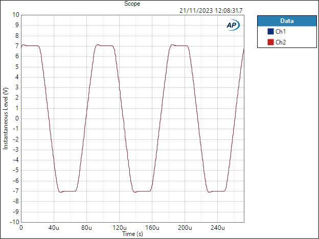

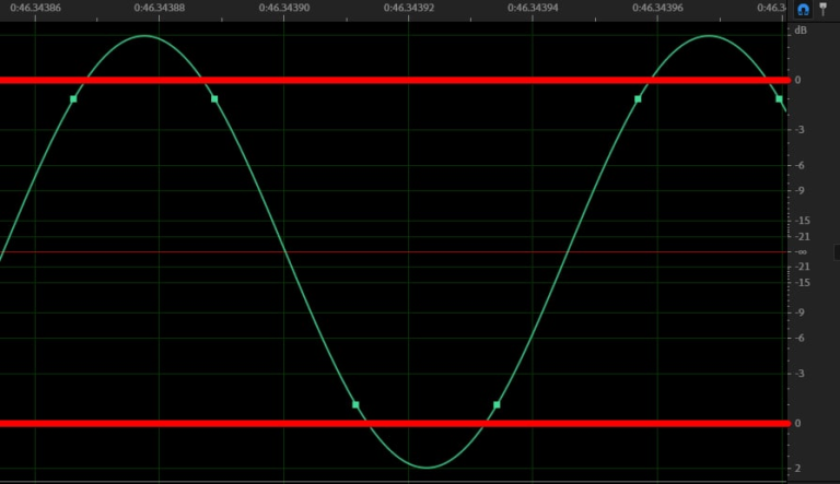

και είναι ο μόνος που έχω δει να μετράει ένα πολύ ενδιαφέρον και κρίσιμο χαρακτηριστικό των ντακακίων
When DACs oversample, they can sometimes encounter a situation where the reconstructed/interpolated waveform goes above 0dBfs (the maximum possible digital value).
This is particularly common with poorly mastered music that has been ‘brickwalled’ (To clarify: I mean brick-walled as in the loudness-wars term, not brick-wall nyquist reconstruction filters https://en.wikipedia.org/wiki/Loudness_war ).
DACs ideally should have a few dB of digital headroom to accommodate this and reconstruct properly, and many such as Chord, RME, Benchmark etc do, and will output signals with intersample overs without any issue/distortion.
But many do not do this, either out of lack of awareness of the issue or because doing so usually means sacrificing a few dB of dynamic range and/or THD+N performance. And as a result will not be able to properly reconstruct these signals.
We can test this by creating a signal that induces intersample overs.
See in the image below. All the 44.1khz samples (squares) are below the 0dBfs limit, but the actual waveform itself, is above this limit.
The DAC200 does not have any additional internal headroom and therefore will distort/clip in the presence of intersample overs. Recommended that you set your player volume to -3dB when using this DAC. Given the proprietary processing present in this DAC, seeing it have the proper headroom would have been ideal.
