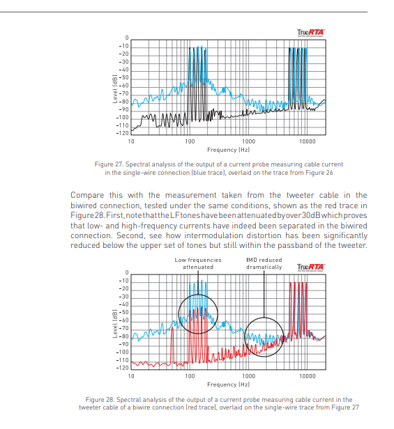

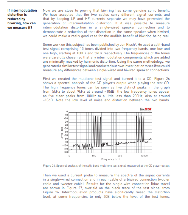

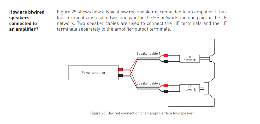

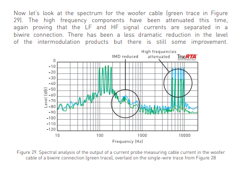

2.210
2.420
Conclusions: If your speakers have four binding posts then you can biwire them but you will need twice as much cable. Low-frequency and high-frequency signal currents will then travel in separate cables. Our measurements show that this reduces intermodulation distortion caused by nonlinearity in the speaker system. In light of this evidence it’s sensible to conclude that where the opportunity exists and funds allow, biwiring should be explored as a means of improving the performance of any suitable high fidelity loudspeaker system.
1 Risch, Jon M, “A New Class of In-band Multitone Test Signals”, Paper 4803, Audio Engineering Society 105th Convention, September 1998 The test signal CD was played using an all-in-one CD player/amplifier set at half volume, into a pair of floorstanding speakers. Current probe measurements were recorded using a Tascam US144 USB audio interface and analysed using TrueRTA. The single-wire measurements were taken with two runs of speaker cable connected in parallel (speaker terminal shorting connectors in place); the biwired measurements used the same arrangement but with the shorting connectors removed.

Conclusions: If your speakers have four binding posts then you can biwire them but you will need twice as much cable. Low-frequency and high-frequency signal currents will then travel in separate cables. Our measurements show that this reduces intermodulation distortion caused by nonlinearity in the speaker system. In light of this evidence it’s sensible to conclude that where the opportunity exists and funds allow, biwiring should be explored as a means of improving the performance of any suitable high fidelity loudspeaker system. 1 Risch, Jon M, “A New Class of In-band Multitone Test Signals”, Paper 4803, Audio Engineering Society 105th Convention, September 1998 The test signal CD was played using an all-in-one CD player/amplifier set at half volume, into a pair of floorstanding speakers. Current probe measurements were recorded using a Tascam US144 USB audio interface and analysed using TrueRTA. The single-wire measurements were taken with two runs of speaker cable connected in parallel (speaker terminal shorting connectors in place); the biwired measurements used the same arrangement but with the shorting connectors removed.
