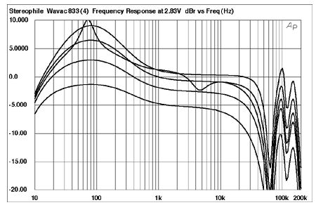

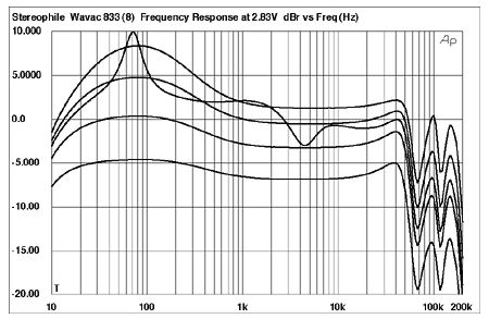

Για παράδειγμα, γράφει ο γελοίος ο Fremer κατά τη δοκιμή του σκουπιδιού των 350.000$ (Wavac SH-833):
Bass presentation was equally sensational, if unusual: bigger and warmer than I was used to—which it needed to be to match the voluptuous midband—but not sloppy or weak or incoherent. In fact, listening to the Weavers' Reunion at Carnegie Hall 1963 (45rpm LPs, Vanguard/Classic), I heard something for the first time that amazed me. Pete Seeger can be heard tapping his foot at the right of the stage during "Guantanamera." I've heard those foot-taps for decades, but through the SH-833s, for the first time I could hear—and clearly—that Seeger was accentuating the third beat in each bar. I could also make out how far the vibration spread across the floorboard before dissipating.
Παρατηρώντας τώρα τις μετρήσεις του εν λόγω χαϊεντόσκατου:
Fig.1 Wavac SH-833, 8 ohm tap, frequency response at 2.83V into (from top to bottom at 80Hz): simulated loudspeaker load, 16 ohms, 8 ohms, 4 ohms, 2 ohms (1dB/vertical div.).
Fig.2 Wavac SH-833, 4 ohm tap, frequency response at 2.83V into (from top to bottom at 80Hz): simulated loudspeaker load, 16 ohms, 8 ohms, 4 ohms, 2 ohms (1dB/vertical div.).

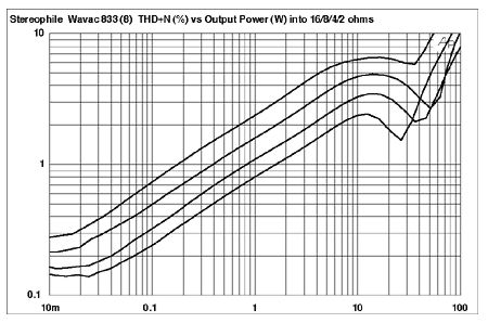

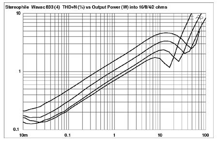

Fig.5 Wavac SH-833, 8 ohm tap, distortion (%) vs 1kHz continuous output power into (from bottom to top at 10W): 16 ohms, 8 ohms, 4 ohms, 2 ohms.
Fig.6 Wavac SH-833, 4 ohm tap, distortion (%) vs 1kHz continuous output power into (from bottom to top at 10W): 16 ohms, 8 ohms, 4 ohms, 2 ohms.

(εξέτασης κοπράνων συνέχεια):

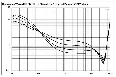

Fig.9 Wavac SH-833, 4 ohm tap, THD+N (%) vs frequency (from bottom to top): 2.83V into 16 ohms, 8 ohms, 4 ohms, 2 ohms.

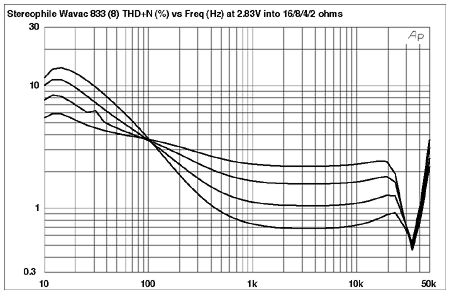

Fig.10 Wavac SH-833, 8 ohm tap, THD+N (%) vs frequency (from bottom to top): 2.83V into 16 ohms, 8 ohms, 4 ohms, 2 ohms.
καταλαβαίνουμε εύκολα (ελπίζω...) το ότι η διακριτότητα του foot-tapping και του "τριξίματος της σανίδας", δεν είναι αποτελέσματα της "διαφάνειας" της λαμποκουράδας, αλλά συνέπειες (συμπτώματα) χαμηλού damping factor, συγκεκριμένων τονισμών στην απόκριση πλάτους και συχνοτικής κατανομής της αρμονικής παραμόρφωσης.
Με άλλα λόγια, η ανάδειξη των παραπάνω λεπτομερειών, η οποία προκάλεσε "ερωτικούς σπασμούς" στο ορθό του Fremer, δε σηματοδοτεί υψηλή αναλυτικότητα, αλλά μια λειτουργία "παραμορφωτικού φακού" που φέρνει δευτερεύοντα στοιχεία μιας ηχογράφησης σε πρώτο πλάνο.
