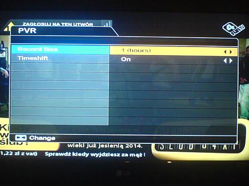

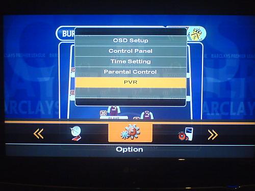

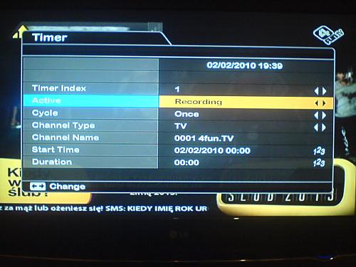

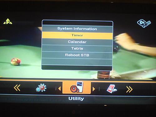

Απάντηση: Spiderbox 9000HD - 7000HD.
PVR function.
Go to PVR menu.
Here you can set the recording size and turn off/on the Timeshift.
You can record using the EPG by pressing the green button.
Select channel and press the REC key.
If you want to Timeshift,still when a recording is in progress,press the pause button.
To resume watching, press the Play button.
You can Timer record using the Timer option in the menu.
Select the Timer Index - untill 7 recordings can be scheduled.
Set Active to 'Recording'.
Set channel, Start Time and Duration and then exit.
