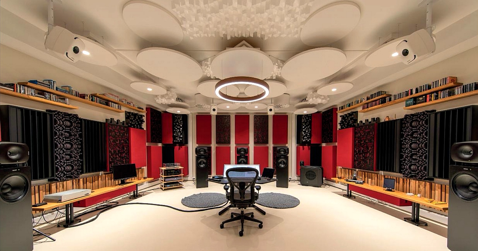

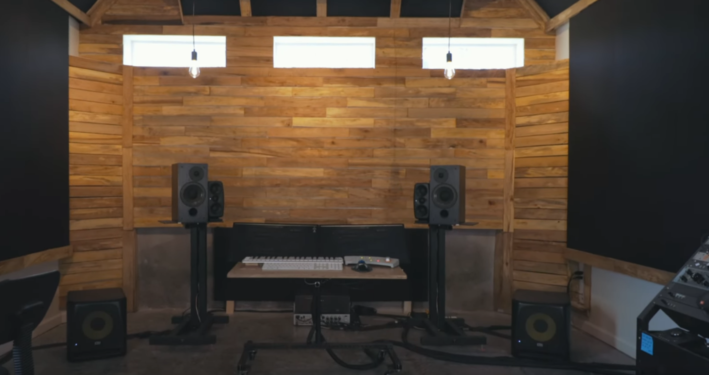

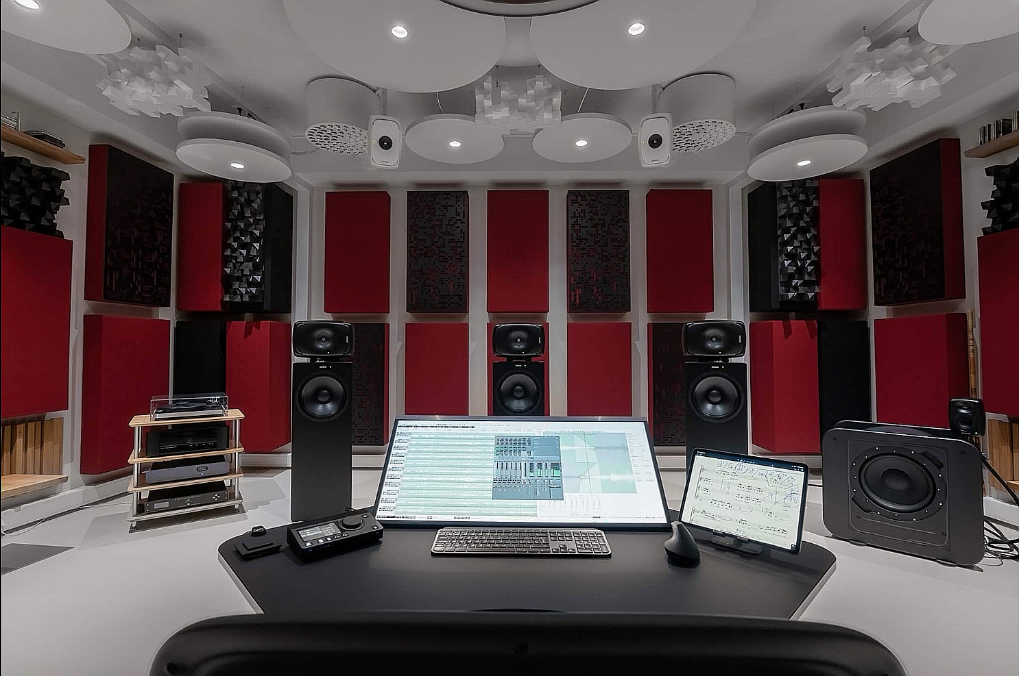

Και επειδή βλέπουμε συνέχεια εξωτικά studios... :p
Εγώ θα βάλω ένα όπου συνυπάρχουν παθητικά monitors, ενισχυτής bryston, krk subs & ...trinov :p
Είναι ωραίος ο τύπος εκεί.
Έχω δει κατά καιρούς αρκετά βίντεο που έχει ανεβάσει.

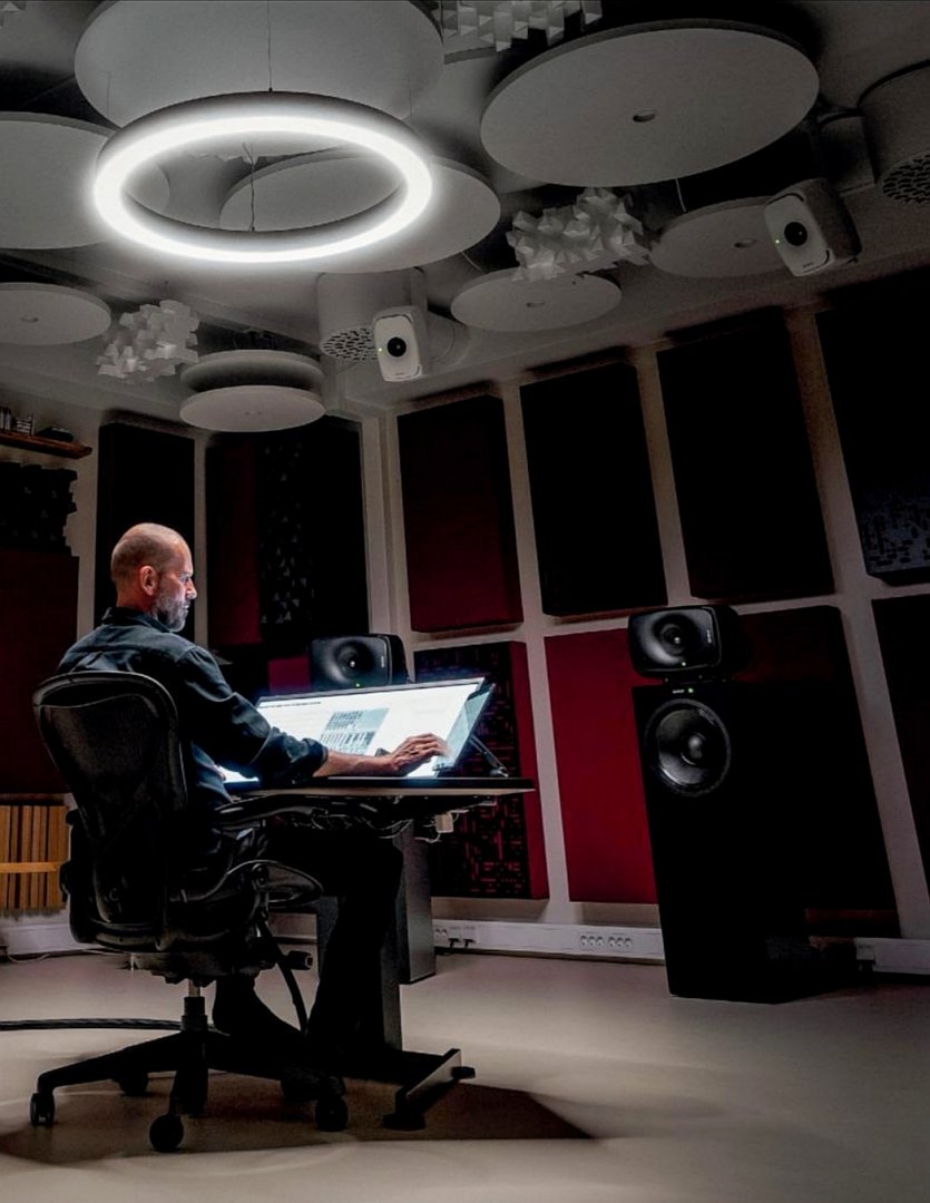

Χαρακτηριστικά αποσπάσματα από συνέντευξη του Dave Gunness,σχεδιαστή των Presonus Sceptres :
in the end the system has a much more consistent character as you work around the room. Listeners are less conscious as they walk around the room. They’re not gonna look up and say, “I’m gonna walk up over there because I don’t like the sound of the speaker where I’m standing by.”
That is the first thing that anyone would notice — just flat throughout the xo. It sounds very different than what we are used to listening — speakers with displaced drivers xo at 15kHz or so which sounds normal. But when the artifacts associated with that go away: “Wow! This very different!”
At the top end, it will generally roll-off very, very slightly from about 1kHz up — not quite a dB per octave. At 10kHz it may be 2-3dB less than it was at 2kHz. Partly it makes the speaker sound warm and powerful. One of the cardinal rules of EQ is you don’t want a peak to be louder than something below it in frequency. If you have a 102dB peak at 2kHz but it’s running a 100dB from 500Hz to 1kHz, that 2kHz is going to stand out. If the overall level were 2dB lower so that peak matches 500Hz to 1kHz, that 2kHz area will not call attention to itself as much. This gradual decline from 1kHz up is what we find more forgiving of reflections in the space. It keeps everything warm and full.
And also, when you have very coherent high frequencies, they sound louder. People are used to listening to speakers that are nominally flat, but with displaced drivers and without TQ. When you flatten the phase it gets brighter — supressing that just a little bit makes it sound a little bit more like what we are used to... the high frequencies are clearer and more articulate not because they’re louder.
When we are tuning a speaker, there is a very definite house sound we are going for and we know how to describe the departure from that sound.
We don’t EQ by only the axial response, we EQ by looking at the whole family of off-axis curves including the axial.
If there is a bit of a rise near the pattern edge of a given frequency, there needs to be a dip so that you de-emphasize that peak in the response away from the primary axis. It makes it go a lot faster to be able to to look at the response in every direction on the computer screen while you are developing the filters. And then when you turn it on and listen to it you start out a lot closer (to your end goal) than we’re used to in the old days.
When you’re listening there is a tempetation to sit dead straight to a speaker and that is fine if what you are making is a home hi-fi speaker or a studio monitor. But if what you are making is something that is going to address an audience, all the audience members are equally important. You have to walk through the entire pattern and you may have to compromise a little bit with the axial response in order to mitigate a problem near the pattern edge. It’s not how good you can make it in front of house, it’s how 'even' you can make the response everywhere. "

Βρε τον κακόμοιρο το Morten με 8 Sub για μια θέση💺 σε εντελώς φροντισμένο χώρο :lol:
Αν είχα τα 7 που εχει κάτω απο τους δορυφόρους, μπορεί και να μην αγόραζα το όγδοο.
